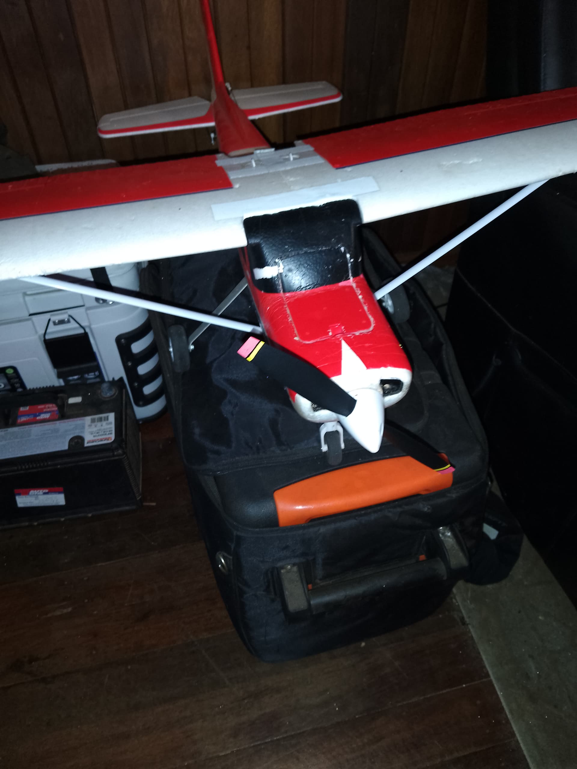

Yes, it’s quite the tradition in the RC Aircraft Hobby to have a ceremonial Funeral Pire to mark the end of an era at the crash site!:rofl:
I thought the last major crash that occurred when coming out of a loop and the Elevator Servo failed completely, sending it lawn darting into the water at great speed from a great altitude had put an end to its days.
Because all the floats were destroyed, along with the large plastic landing gear mount block torn out of the fuselage, also the metal float struts all at the bottom of the Weir, I thought it was over with… not to mention the whole nosecone torn apart and bent upwards at a 90⁰ angle!:open_mouth:
But then I remembered that I still had the original landing gear still in the box that had never been fitted and the rear mount plate was still intact… I simply glued/taped it all back together with what parts were left on it and converted it back into a ground Aircraft to live once again!:grin:
I still haven’t had time to even touch my PA-18 Super Cub that I binned out the box haha

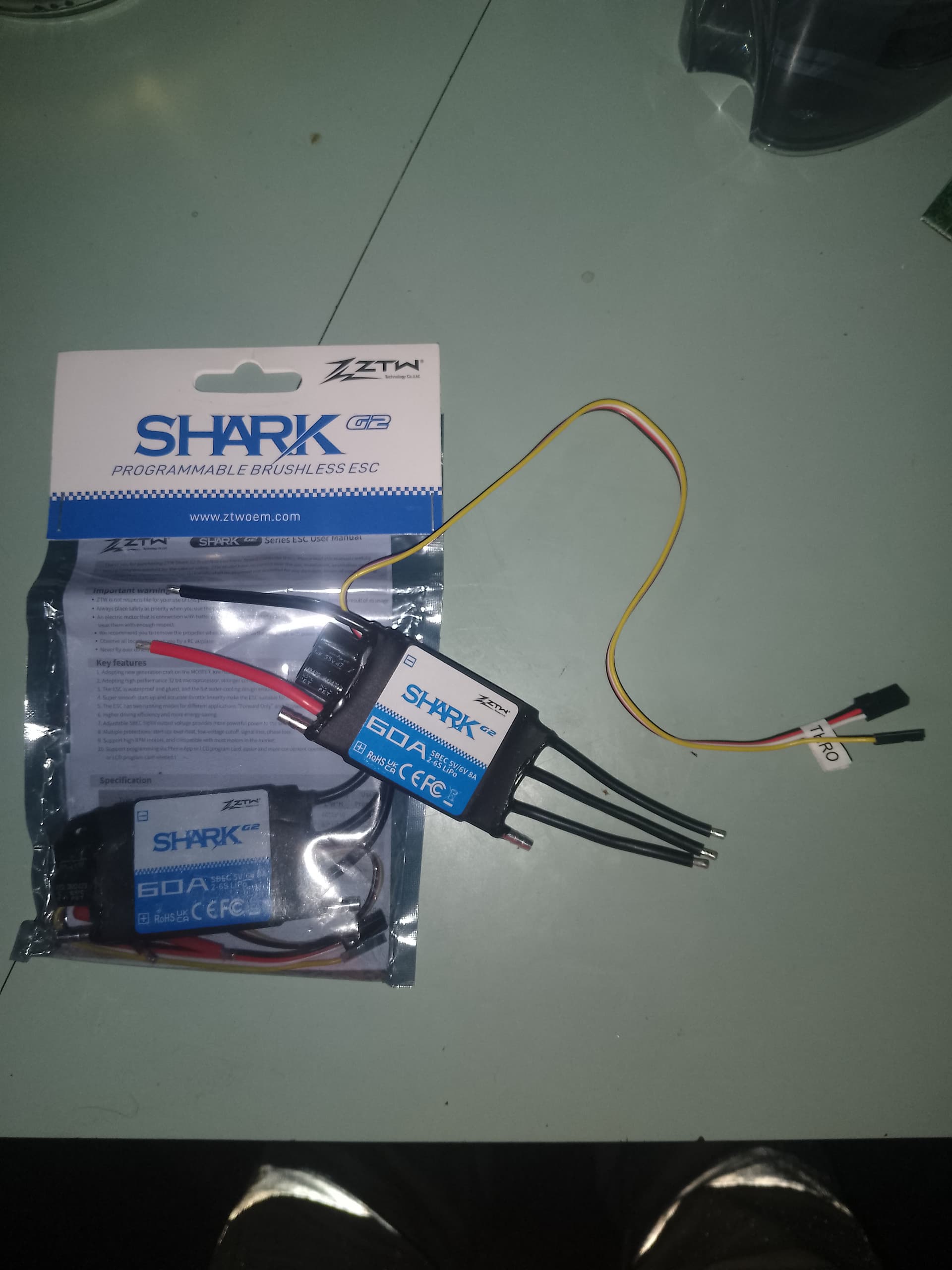

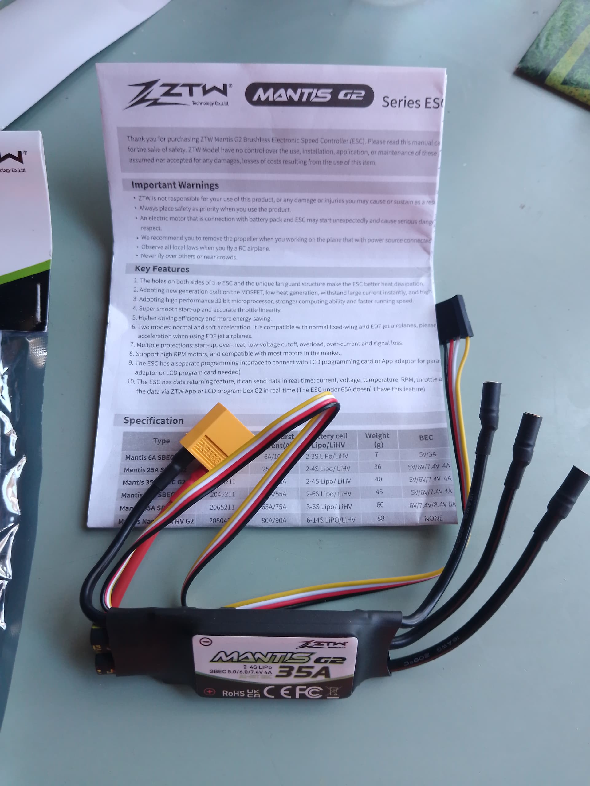

More Helicopter electronics bits arrived today.:+1:
At least these are actually sold with both the battery leads/plugs and motor connectors already fitted, whereas all my previous Float Plane/Speedboat waterproof/water cooled ESC’s require soldering your own battery connectors/motor plugs.
Big boost in performance with the Helicopter ESC’s and getting higher voltage Servos to match so that they all run on 7.4V 4-8A power instead of the standard 4- 6V @ 4A that’s common in the industry.:ok_hand:

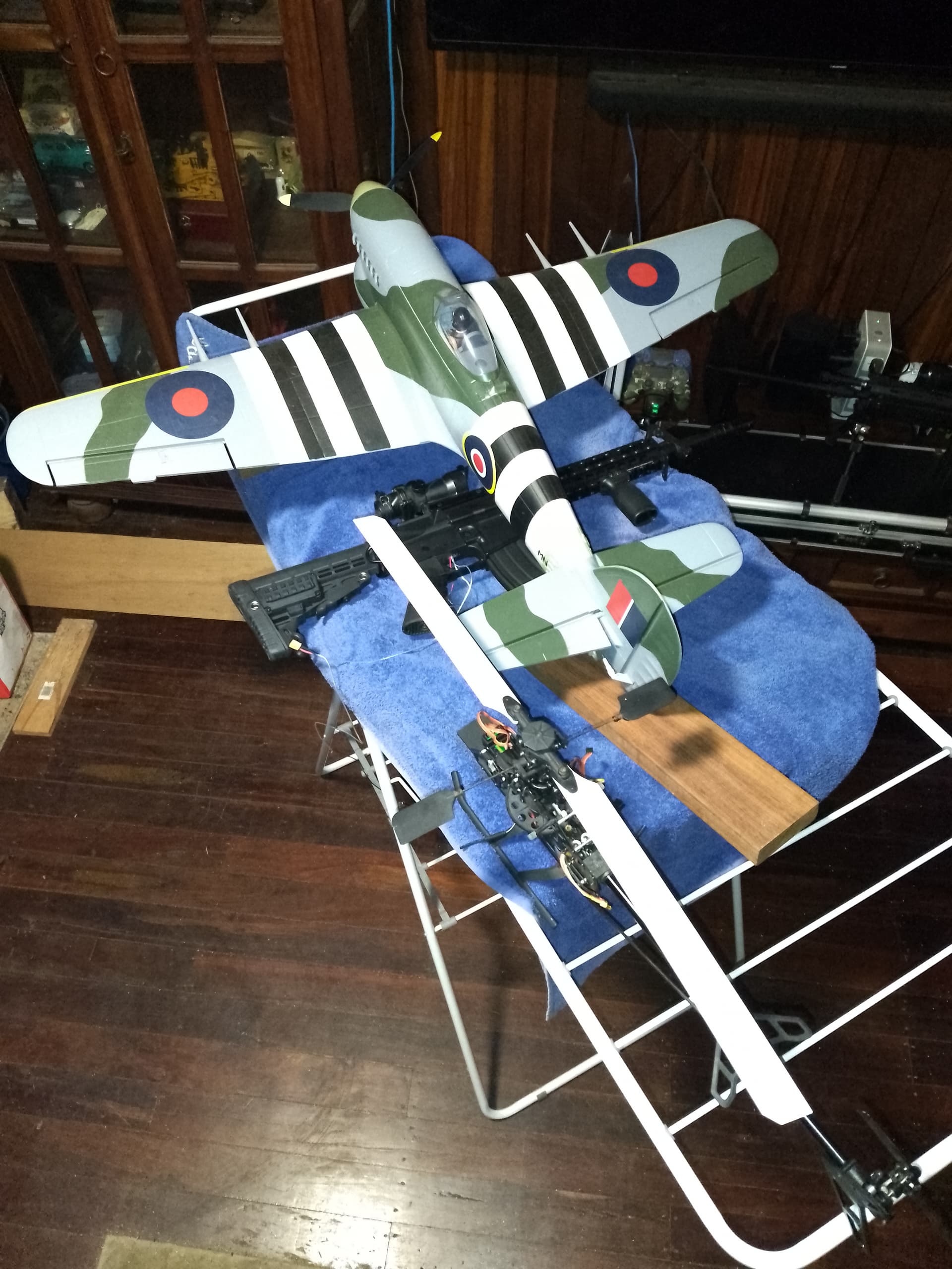

Laughing at the fact that I had to move the Gelbasters to reshuffle the Aircraft to make room for the Helicopters!
(Gelbaster gives an indication of scales!)
Not to mention the Speedboats and Rock Crawler builds I’m also working on …

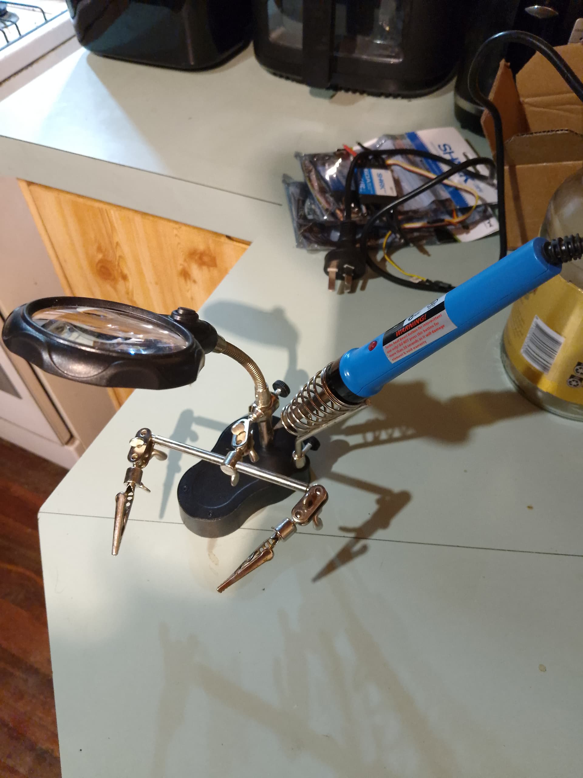

Funny enough that my housemate got sick and tired of listening to me swearing my tits off @RokSolid style trying to use my basic faithful 15 year old busted arse “helping hands” soldering setup that had broken one Alligator clip rendering it pretty much fkn useless,
so he secretly went online and purchased this updated Rolls Royce version and gave to me to shut up my whinging when trying to solder shit together!
Not only now have two fully functioning alligator clips, but also an LED backlit magnifying glass and Iron holder to boot!:ok_hand:
He’s at peace now, able to sit on the lounge with his headphones and microphone playing his online gaming without me interrupting by swearing like a Sailor in the background.
Worth every cent he reckons, obviously more for his own sanity rather than mine!:rofl:
Good tools don’t always make the results of a job better, but they will always make the job easier to get better results in less time :slight_smile:
The LED magnifier is very handy if your eyes are like mine and not what they used to be :slight_smile:
I got given one of these a while back. Comes in very handy when you’re poking a soldering iron around in a Gibson guitar control cavity, I can tell ya… :wink:
Loupes… with a headlamp…
now your talking.!!
Cheapies on amazon…

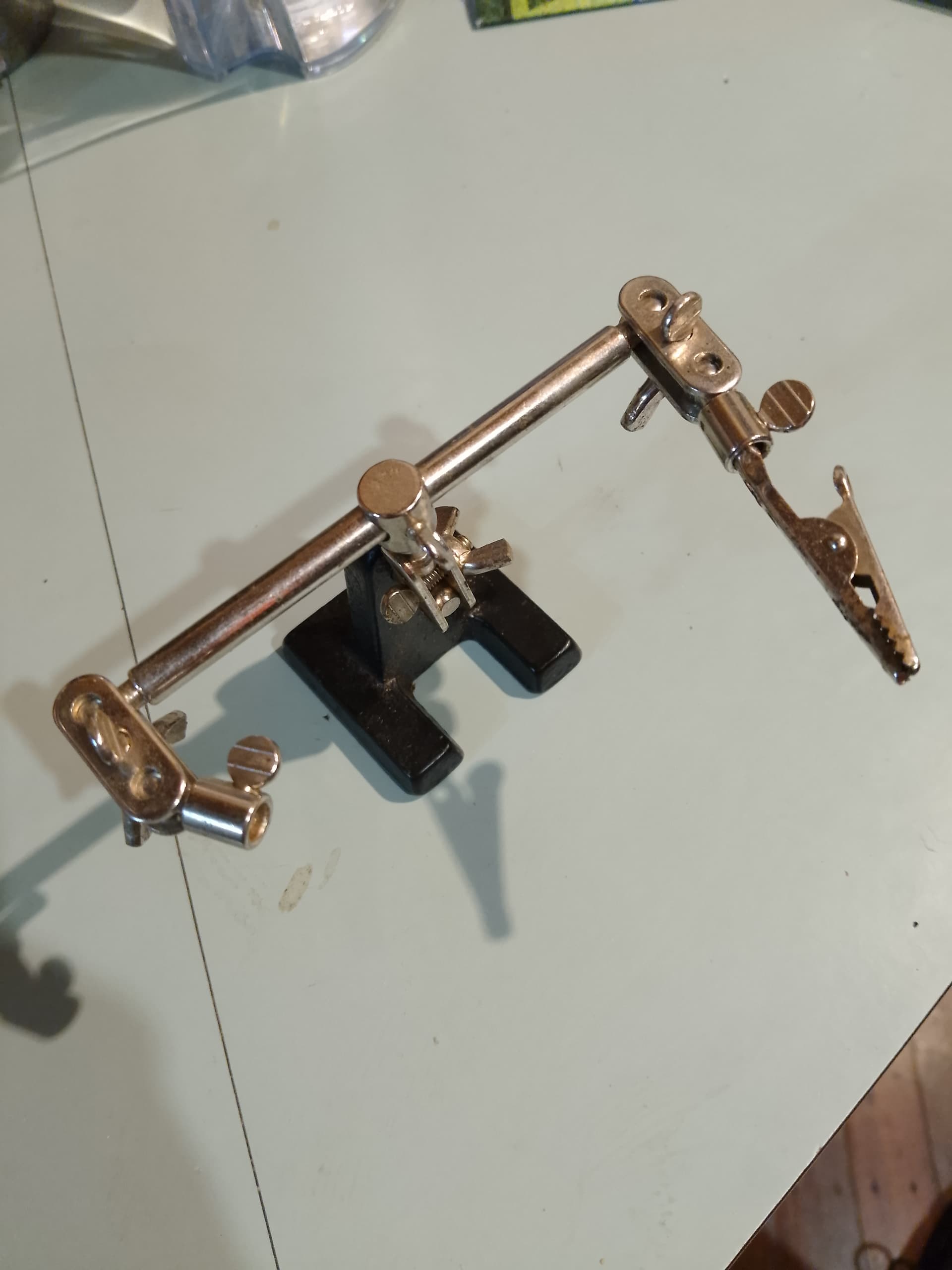

Funny you mention this. As I just uprgaded from that exact one was annoying me plus had it for decades.
To this. Much better and actually holds the wires where I wanted them.
Magnetic base so you can move things around to suit whatever you are doing. More expensive of course. Very happy with it for what I do.

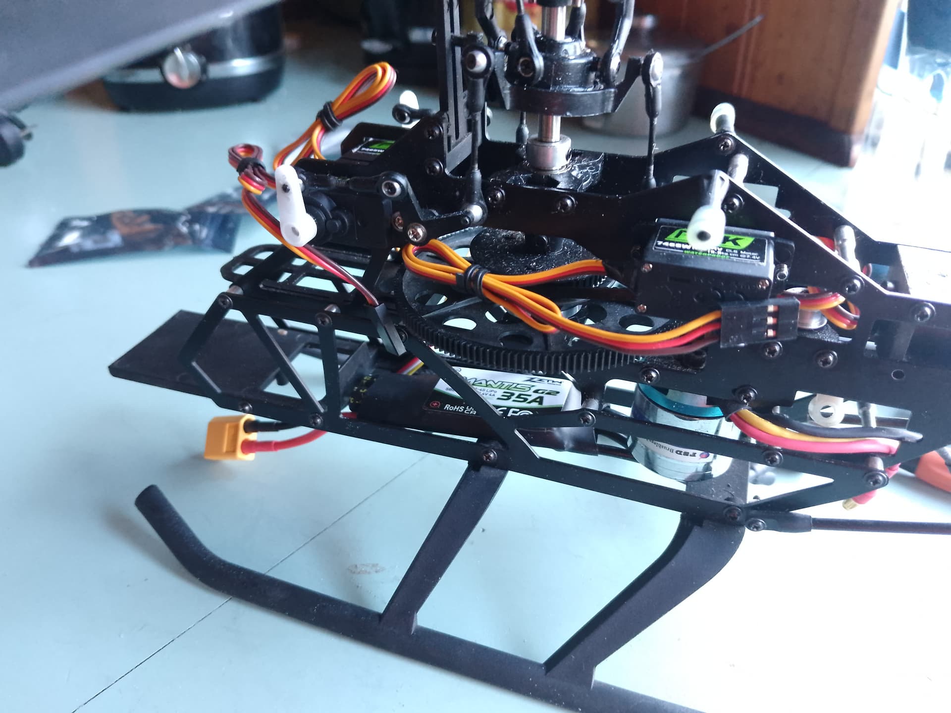

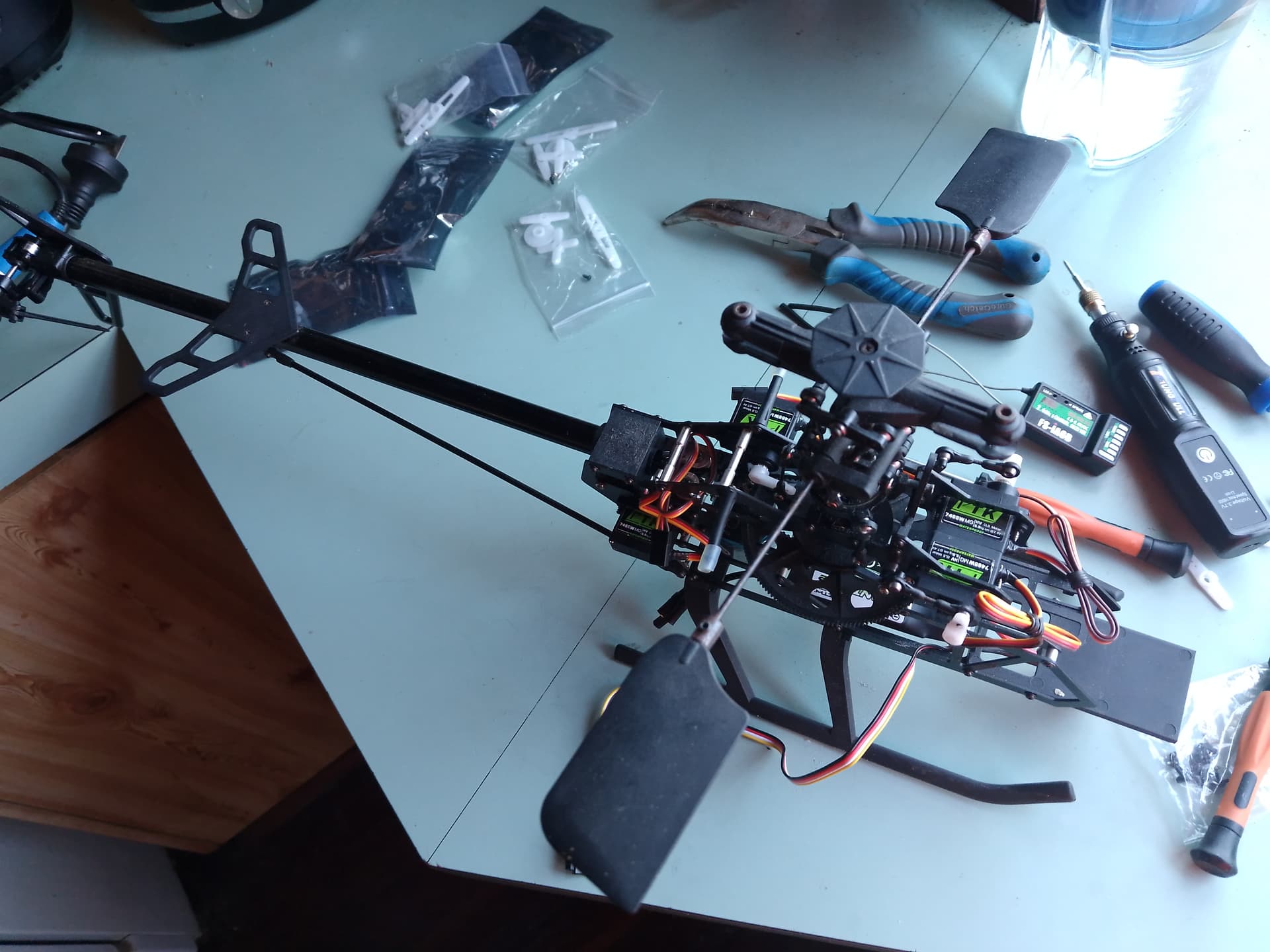

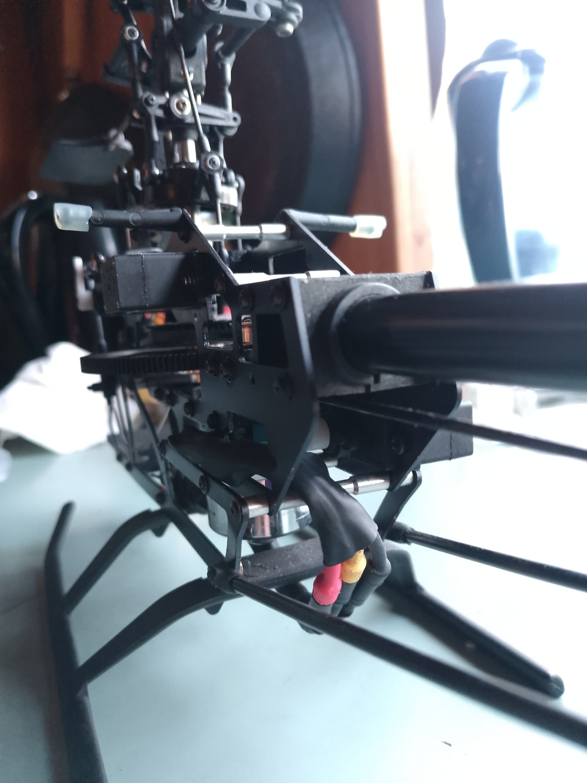

Got plenty done on the Red beetle bopter today.

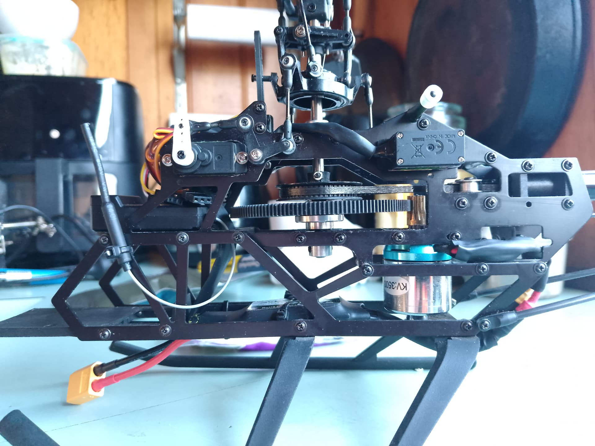

Swapped out the old Servos with the new units, replaced all the brittle plastic servo arms and sussed out a good spot for the ESC to mount.:+1:
Unfortunately had to get out the Pencil Grinder and get a bit creative with the mounting of the front 2 Servos though, as were slightly deeper and larger than the original units, necessitating a bit of bush mechanics to come up with a suitable mounting setup… hence the white Aluminium dust and swarf over everything!
Swapped the original positions with one of the Servos and all the electronics though, as previously was way out of balance in the airframe with lopsided weights both side to side as well as fore and aft.:roll_eyes:
Everything should be balanced as good as I can get it by also concentrating the majority of the weight inline with the Rotor shaft where possible.
Just waiting on a Swashplate Setting Tool and a Servo Programmer before connecting the TX, zeroing the Servos and setting up all the throws and control linkages.:+1:
The old fella might get quite a shock on how well it flies once everything is tuned to the way it should be! :joy:

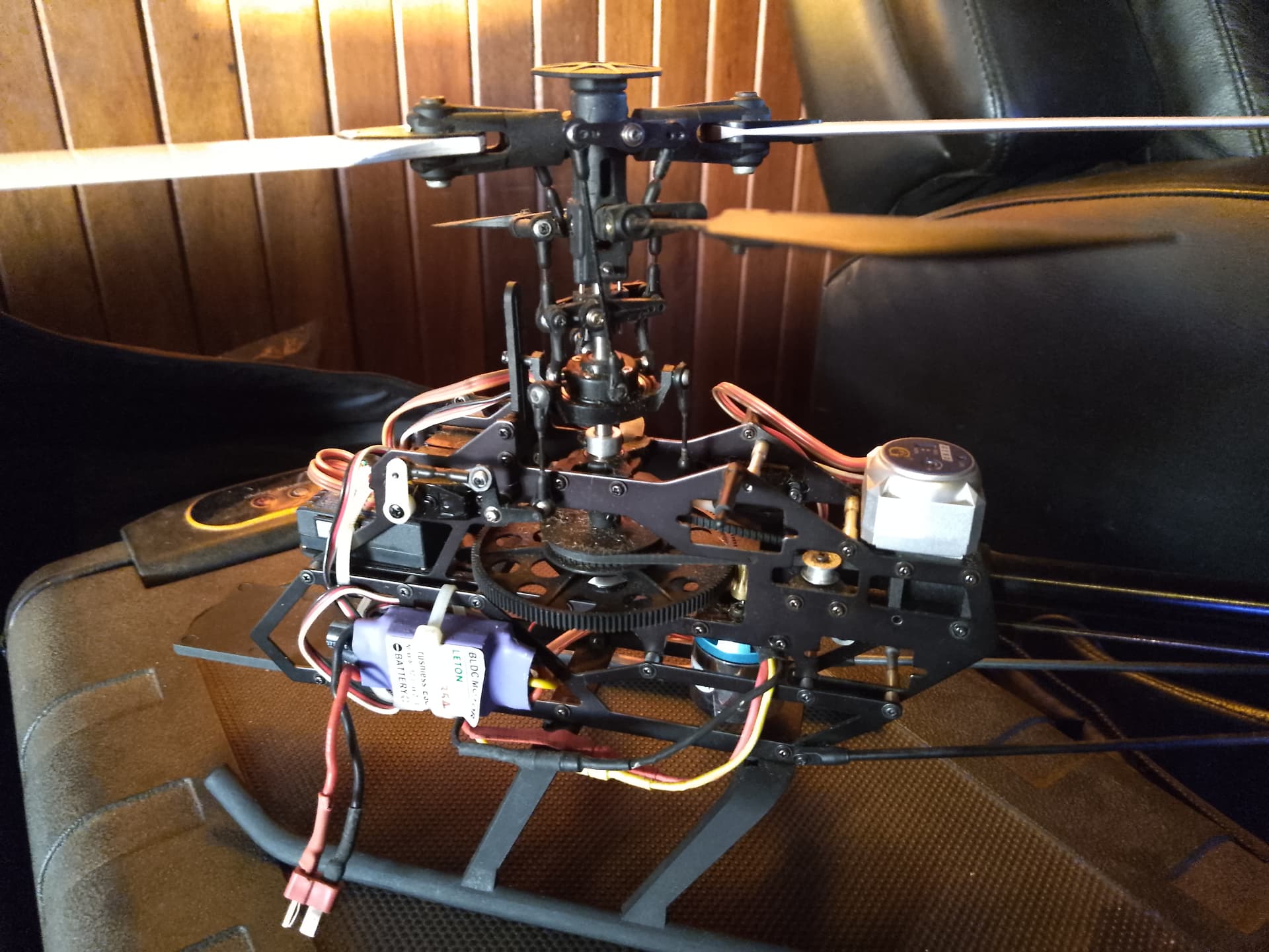

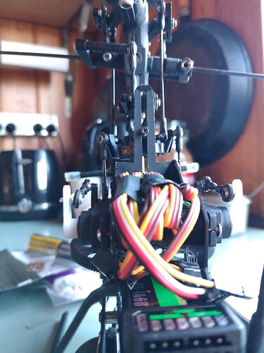

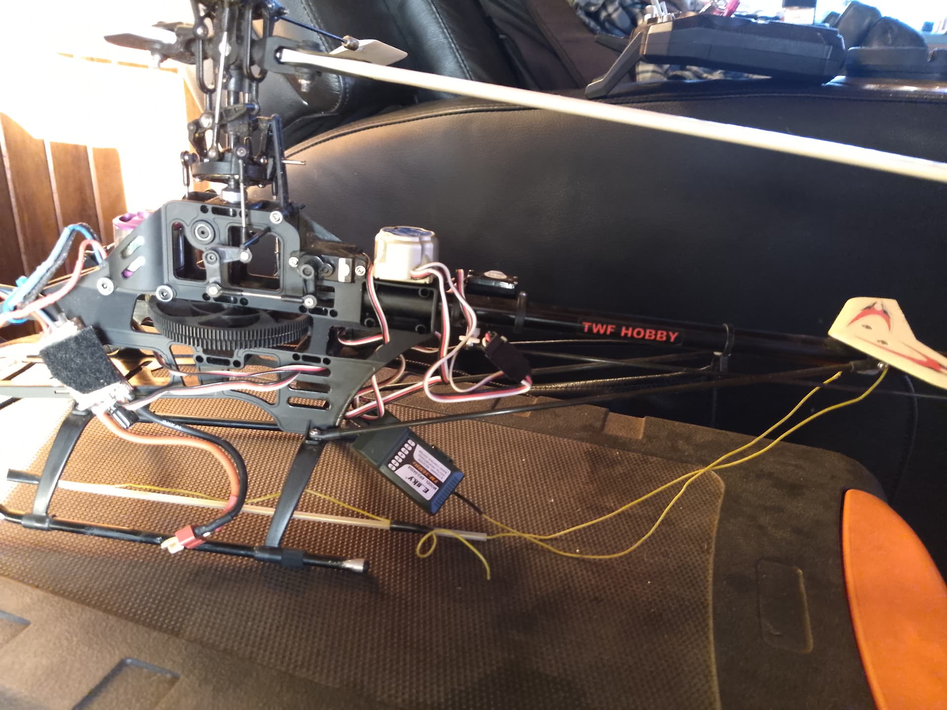

Another big day fitting and tidying electronics and components.

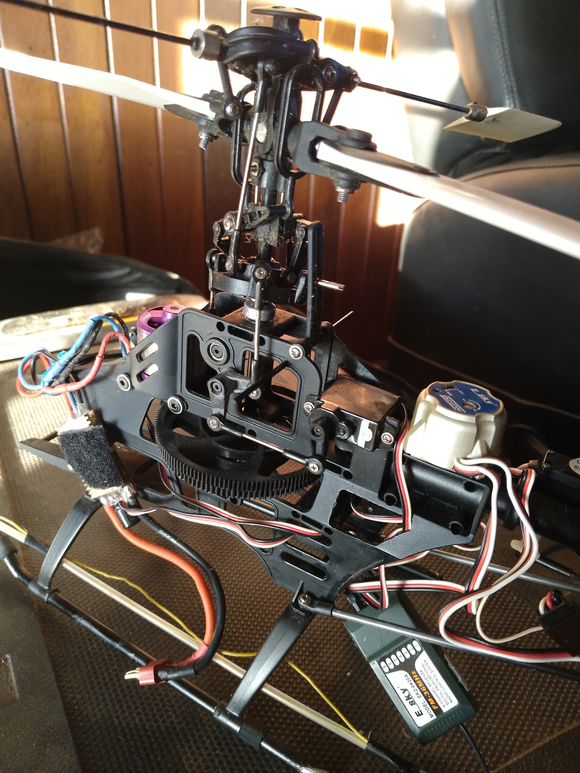

Wiring as was originally given to me:
And that was after removing 3 feet of antenna wire wrapped around the tail boom and skids!

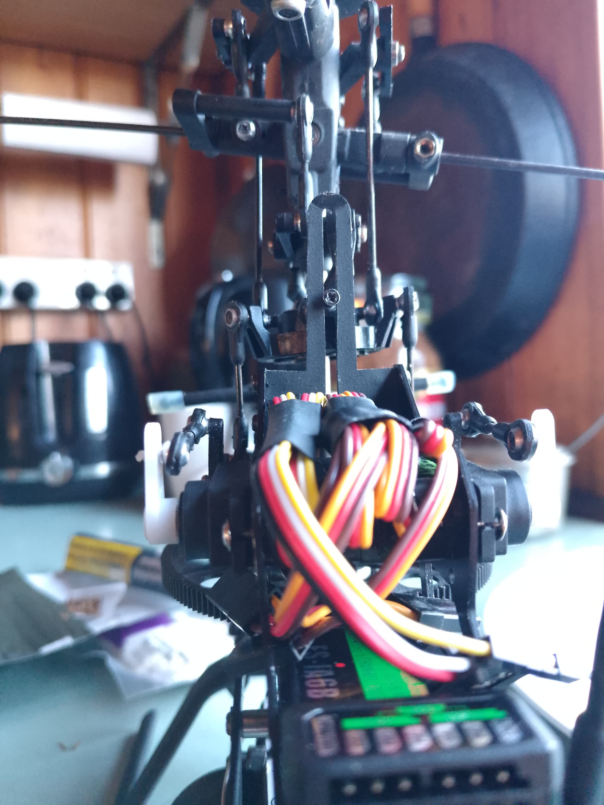

Now tidied up with all the latest electronics fitted:
Plenty of rerouting, heat shrinking and still haven’t finished yet as waiting on a few more parts before I can completely tidy everything up for the final result.
Going to have the same good fun when it comes to tidying up the rats nest on the older White plastic/nylon model as well, which is why I’m purchasing 2 of everything so I have enough parts to rebuild them both.:+1:

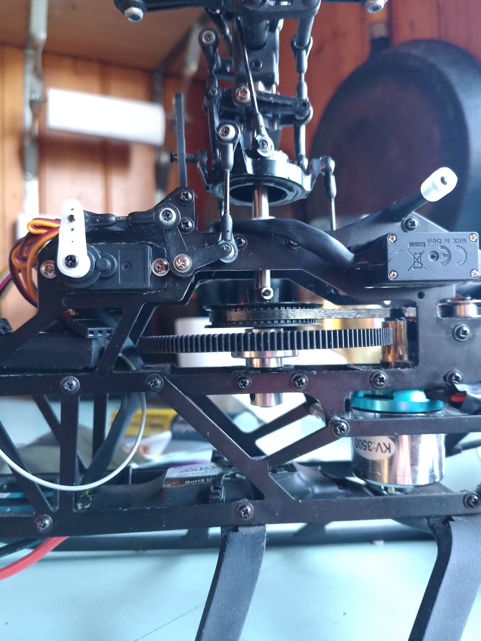

EDIT: After reviewing these first pics, considering the Servos are close to 90⁰’s, I’m pretty shocked with the Swashplate angles on this thing too!:open_mouth:
Left a bit of play in the motor wiring in case I need to swap phases on the motor.
Haven’t got my Digital Servo Programmer yet, but just thought I’d set all the Servo arms to the required 90⁰ and check how close the original setup was…,… and yeah, pretty fkn terrible!:open_mouth:
No wonder that the old fella had every single Trim adjustment on the Transmitter maxed out, where this would have been pulling hard right and in reverse gear just getting off the ground when you look at that Swashplate angle!
Will wait until I get the rest of the proper specific tools delivered to fully set up this thing perfectly before I even attempt to plug in a battery.
I might be a fussy bastard, but getting the mechanical components as near to perfect as possible is the ONLY way to achieve great end results when building anything, especially when it comes to Aircraft, because you don’t get any second chances once they leave the ground!:open_mouth::stuck_out_tongue_winking_eye:

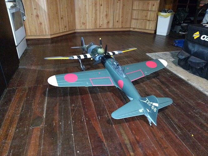

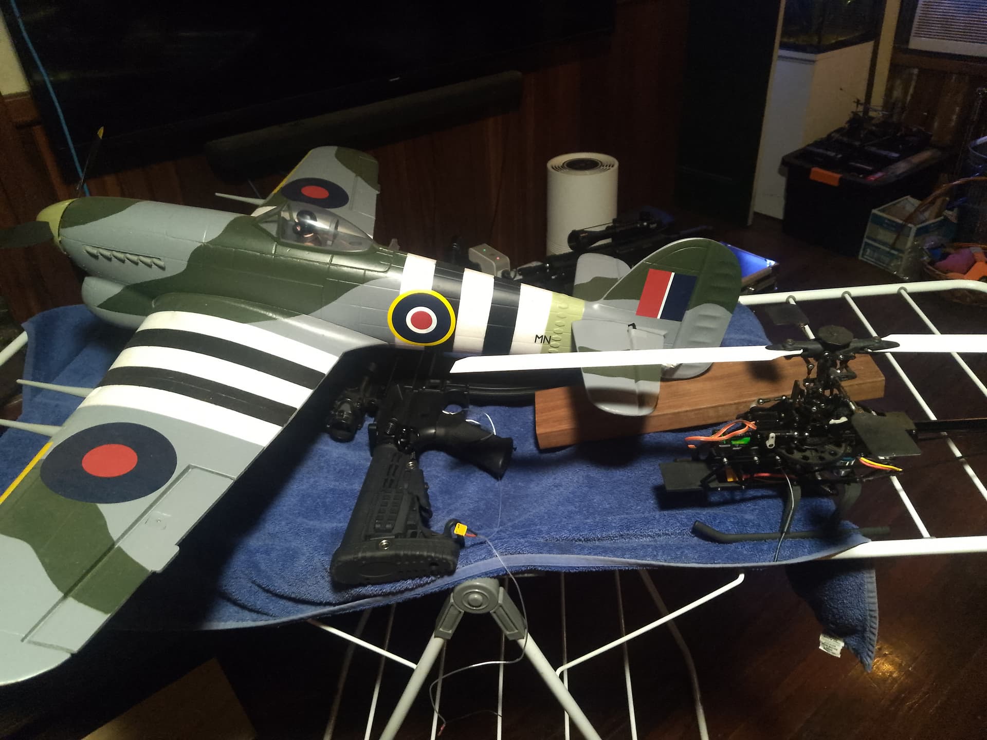

Santa Clause has been dropping off some presents the last couple of days.:blush:
A bloody 10+ year old Model, but that’s where I get them much cheaper than their original new release prices.:+1:
Unfortunately this also means that they are so rare to find for sale these days, and have to be very aware of which Models still have spare parts availability to suit.

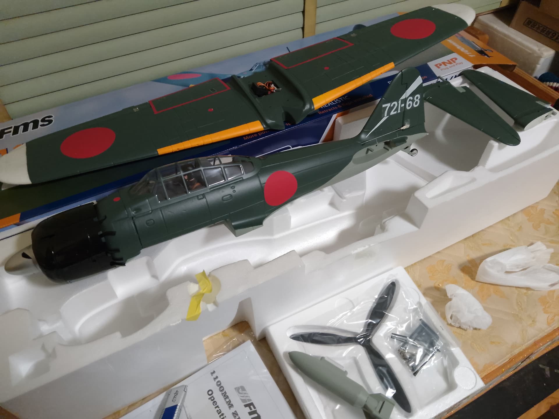

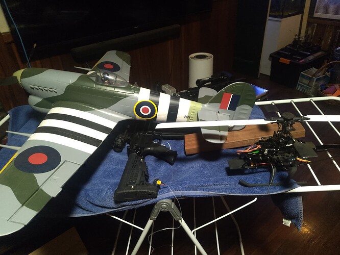

The Hawker Typhoon model that I have will most likely never leave the ground, as it took me nearly 2 years to locate a seller that actually still had one available for sale.

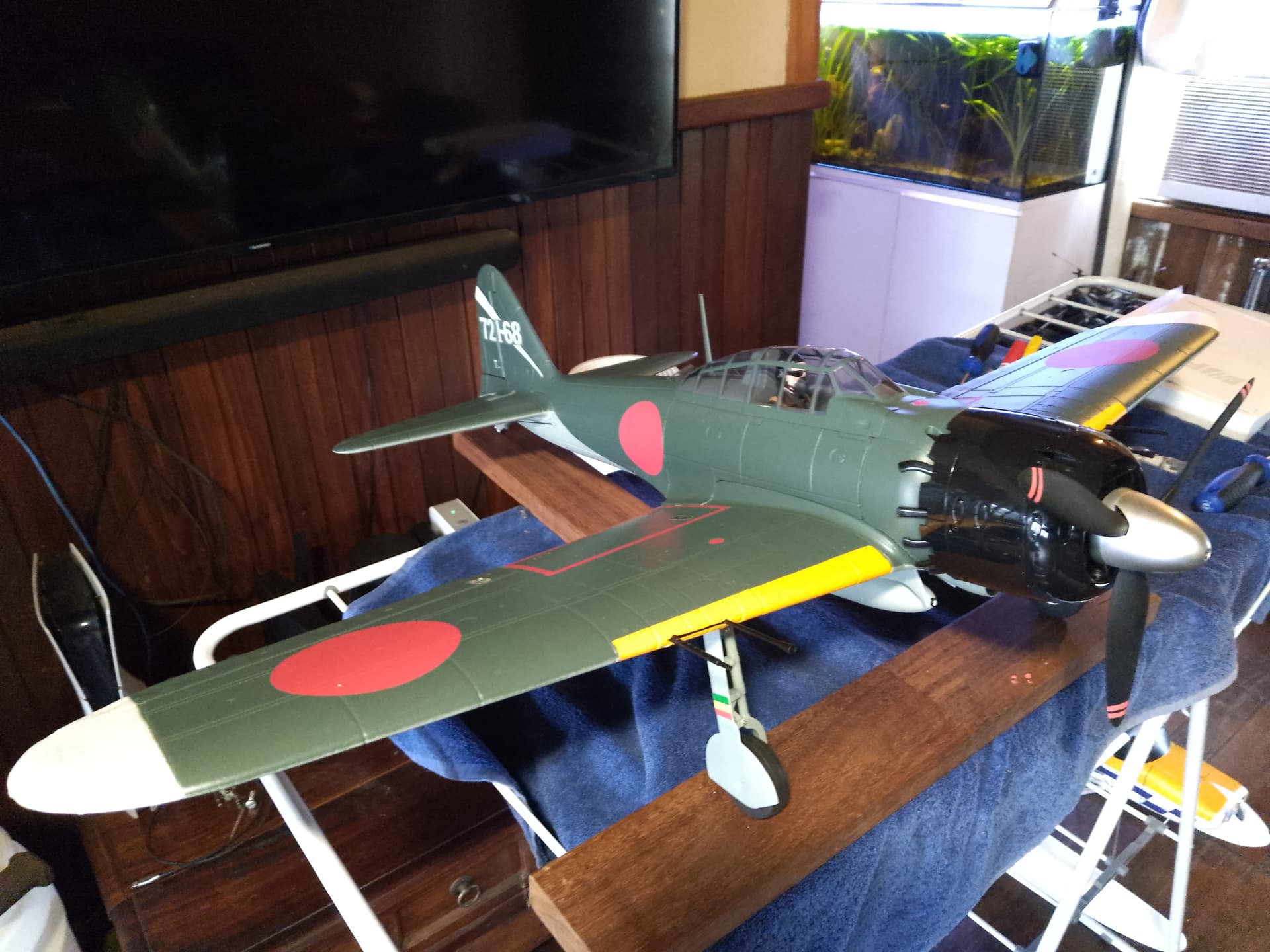

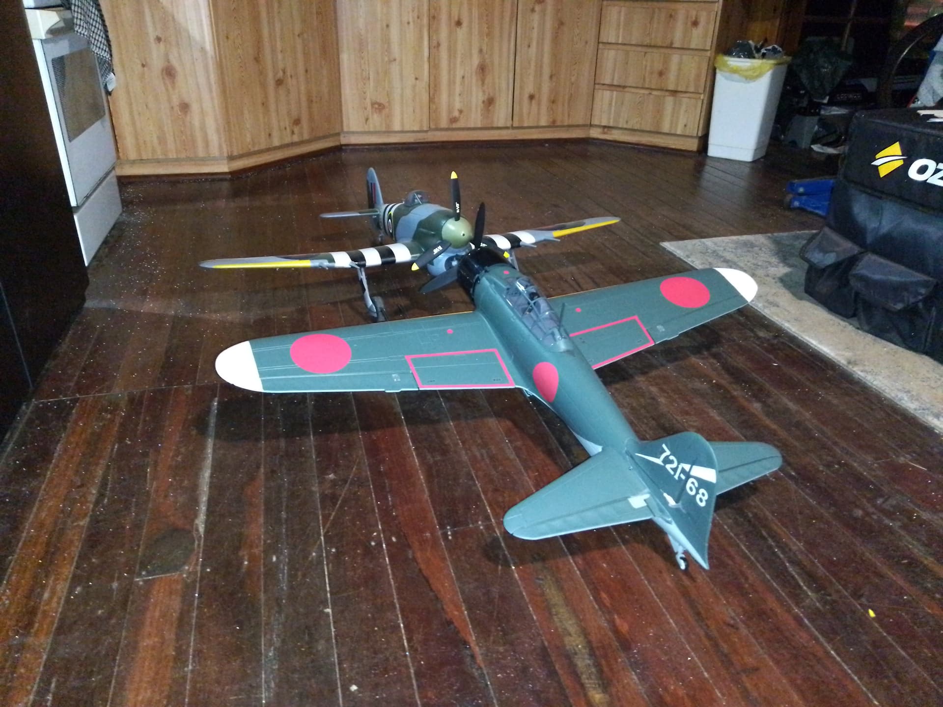

This latest FMS 1100mm Mitsubishi ZERO acquisition is now quite rare, even though it’s over 10 years old, I can easily purchase the updated 1400mm version pretty easily.
Have PLENTY of more parts and upgrades to show off, but just happy to be able to continue modifying and upgrading these things beyond what they were designed for!:joy:
Yeah not a good image facing a European legend against an Imperial Japanese Fighter, so I’ll have to go grab my F4U CORSAIR out of the storage unit and retake that picture!:joy:

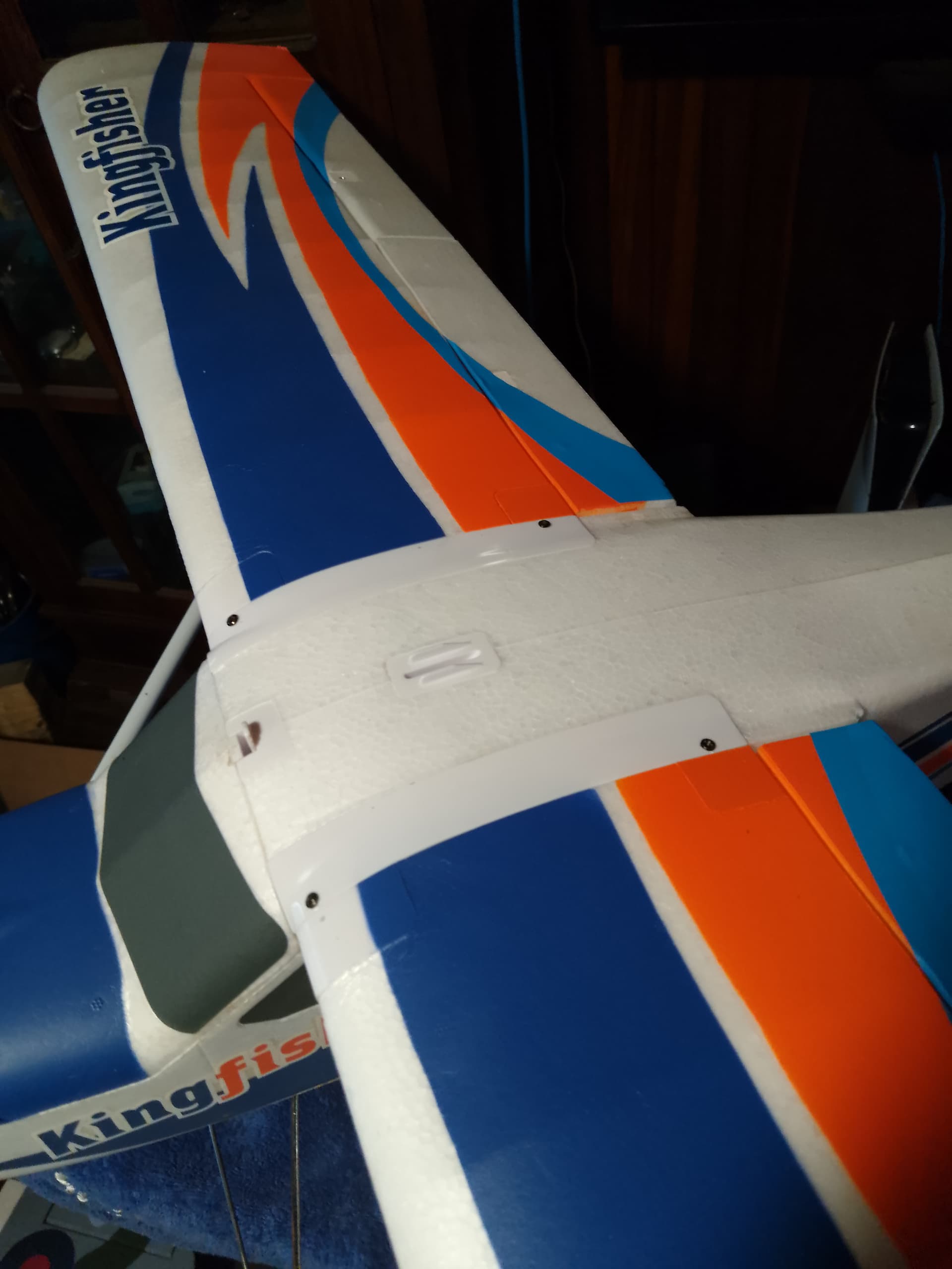

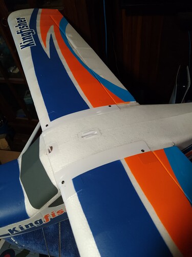

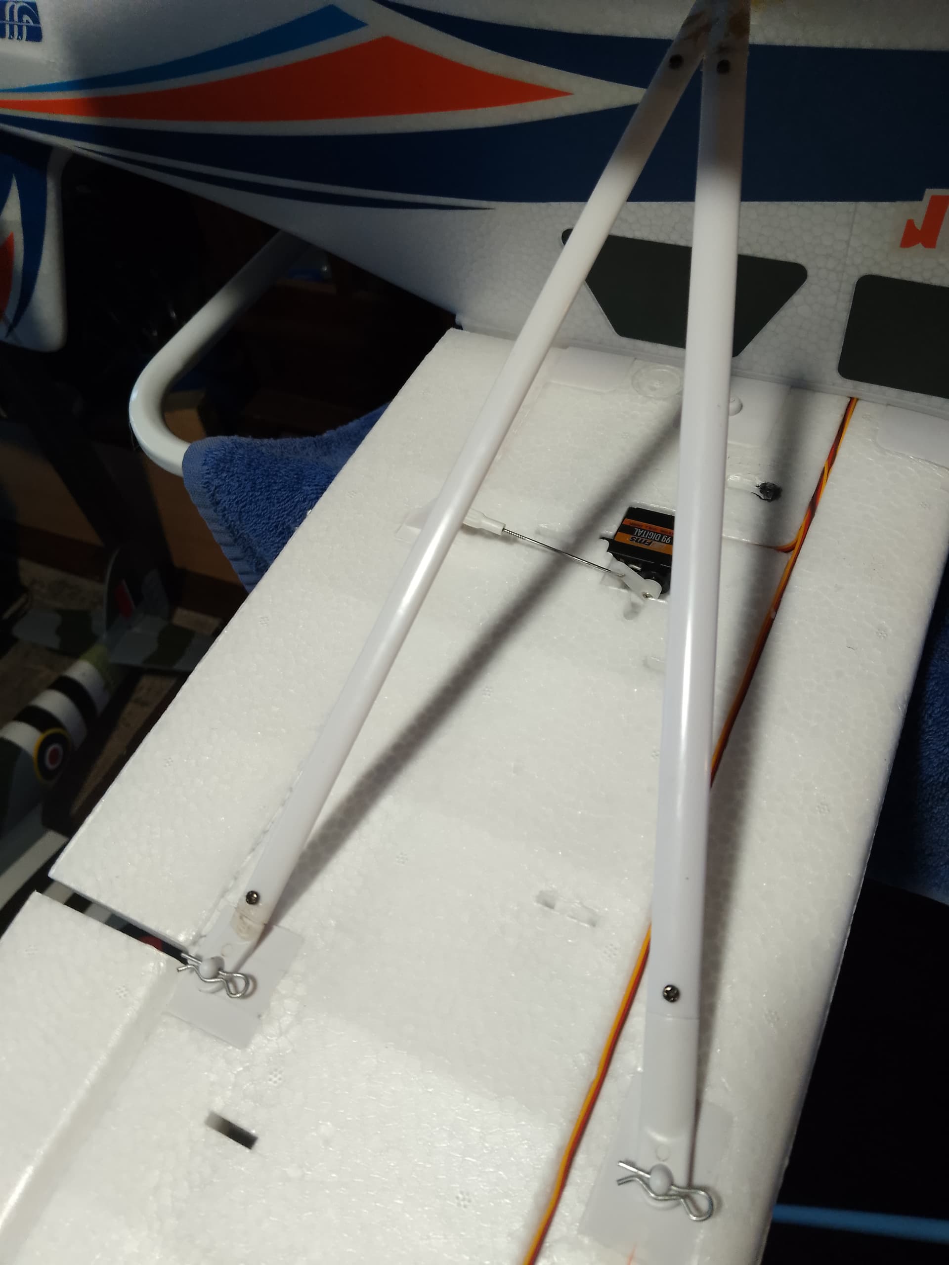

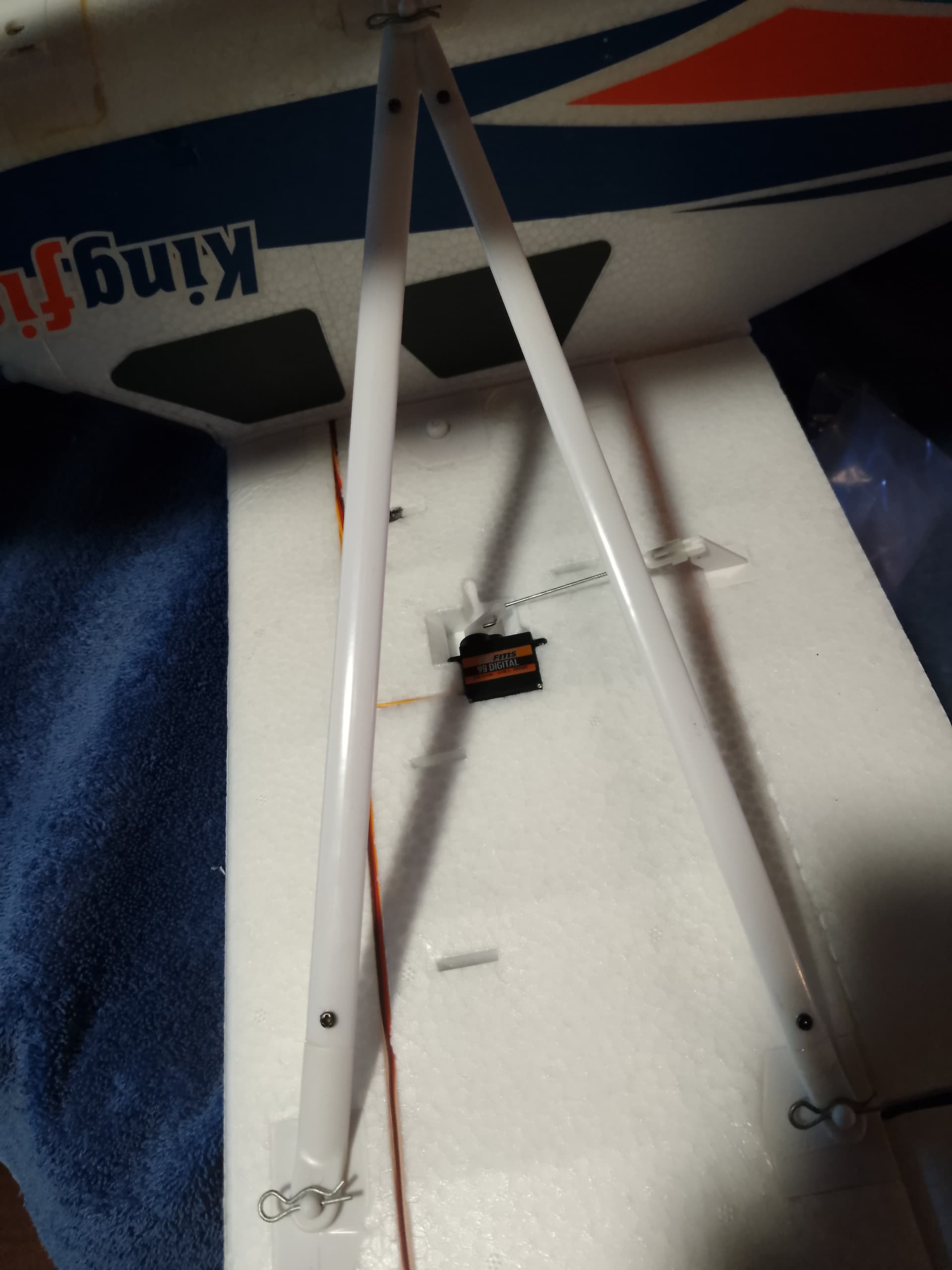

Classic example of the 1400mm FMS KINGFISHER, where the wing struts assemble out of the box as simple “click together” parts.
How the hell that these Struts can withstand the opposite forces of Wing Loading without pulling apart is just ridiculous!
The KINGFISHER has already been glued back to pieces from factory parts failing mid flight, which has necessitated me to having to drill and fit retaining screws to critical joints just to keep the wing roots and struts attached!:face_exhaling:
I’m 100% certain that the manufacturers purposely engineer these faults into their products to ensure that you are going to crash regardless of your flight skills to keep selling a shitonne of spare parts and complete new Aircraft.:face_with_symbols_over_mouth:
