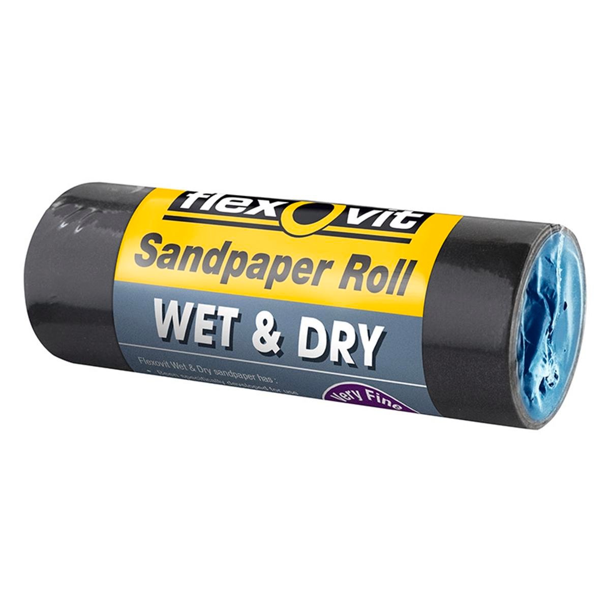

Would this be fine for sanding the Wesker bits…??
1200 grit…??
If yes, ive got a reason to go to bunnings at sausage o’clock, 2morrow…!!
Yep, that’s the stuff I use. :+1:
Maybe get a roll of 600 grit too. It’s quicker getting the bulk of the ridges off, then finish it off with the 1200 grit. Circular motion with a small foam rubber block works best and leaves a better finish.

So I usually will do a rough sanding with some 80 grit (depending on the print settings I use and which printer) then primer fill coat.
Depending on how thick of a coat I did I’ll use a heavy grit to start but I usually finish with 240 wet, rinse repeat if it isn’t smooth enough but usually only the once for my liking.
You want to almost completely sand down the primer to ensure a smooth surface.
Then I’ll hit it with the colour, either a rattle can or an airbrush if it’s got lots of crevasses so I don’t get runs. Then clear coat either matte or satin.
Going that fine of grit to me is a little overkill, unless you’re tryna get a mirror like finish. I’ve only ever gone up to like 420 wet, but it’s not gonna be a bad thing either just more effort/time.

600 is too fine, it’s taking forever to remove the paint…
Might have to go to Bunnings for some coarser paper…
That would be more effective, in removing the lines as well, not taking forever…
