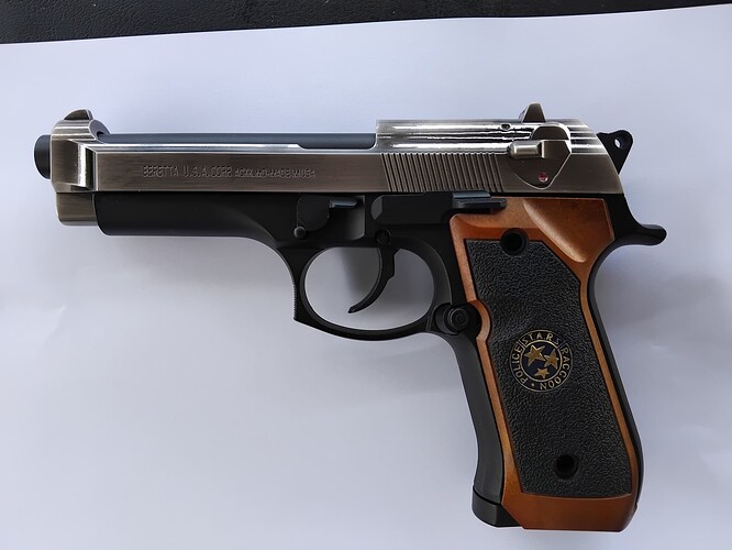

When i fist started the whole wesker thing, i was looking for beretta models of black/silver that could interchange slides.
I had purchased a gen1 silver KEle, was very happy with the finish / metal trigger and levers, and looked at the black model as well, for a slide swap.
The black model was running a different frame, and the two slides / frames were incompatible.
This lead me to cerakoting the gen 1 silver slide to black, to use instead.
Having modified my gen1 silver, and liking the original a lot, i purchased another one when they came back in stock. When i received it (yesterday) i noticed the finish wasn’t as good, trigger and levers were black plastic( yuk) and was quite dissapointed.
This morning i woke up, and compared it to the black KEle.
Guess what, same frame / same slide.!
Thats why the plastic remained.
Great, i thought , compatible slides / frames, i can finish off my wesker 2day…!!
Wrong…the gen2 frame is wider than the gen 1, and the Wesker Nozzle doesn’t fit.
To clarify, i only had to fettle minimal material off, to fit the nozzle onto the gen 1 silver, and it did fit perfectly.
The new frame is too wide, and it doesn’t fit. You would have to remove a hell of a lot of material to make it to fit, and likely risk perferation.
So…GEN 1 silver KEle is the bomb, the best choice to fit a wesker nozzle/supp, and i hope the cerakoting works well…

These photos arent the best, but the silver finish isnt as good…the gen 1 was strikingly eye catching, and gleamy…
This is the photo of the other frankenblaster, which resulted from the slide swap. The grips here were a different make, imported from overseas. I used a different stain on it… i like the result, and engravings on the wood.
Same pistol, with RE grips…
They make anything look good…i reckon it breaks up the tri colour, being mostly black with wood edging…
Finally, comparo of the the two tri colour, frankenblasters…
And, the two KEle’s , side by side…

Frankenblaster looks good in RE grips / different KEle silver…its growing on me…
Full sunlight razzle dazzle…!!
I trimmed down an older worn set of RE grips, to properly fit the KEle.
Naked Wesker blaster, to remain forever SUPP-less…
I reckon they both look the goods…!
I reckon all the grips look amazing!
The Pistols obviously just as awesome, especially the pics in good sunlight look much better :raised_hands::clap:
Those RE grips, suit any combo, and make them look good…
Mostly black , with just a hint of timber, goes well with either black / chrome.
