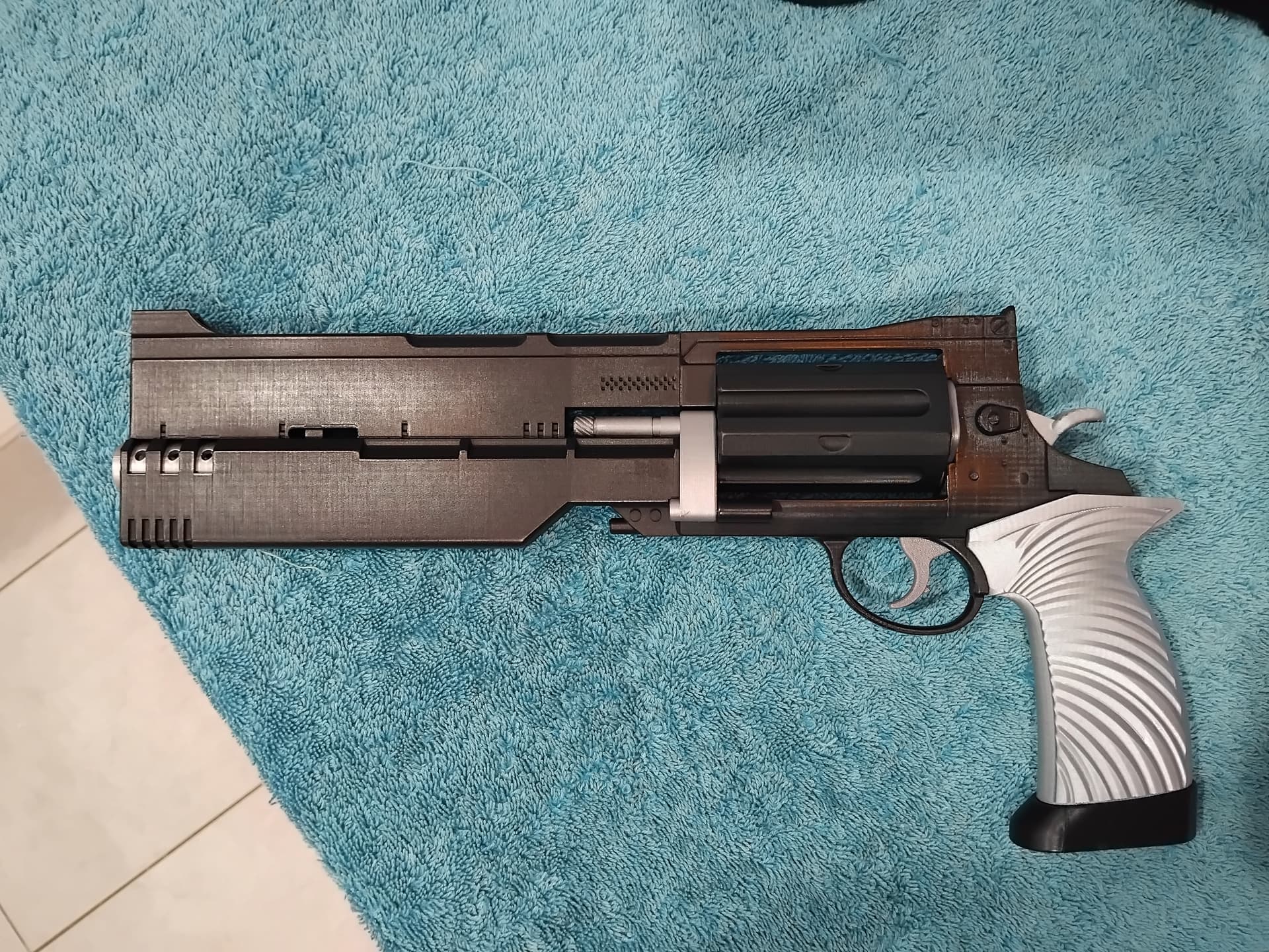

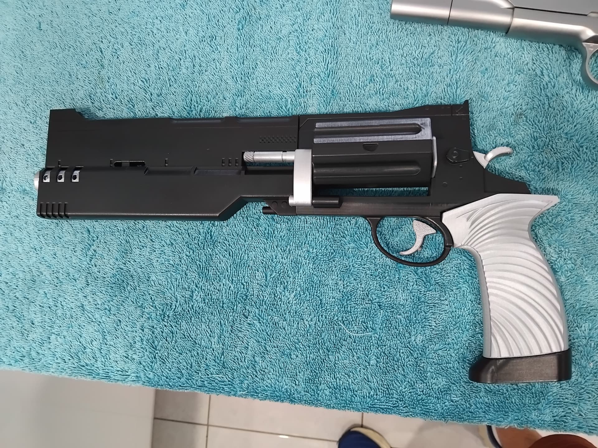

If you’re going to go " Ridonkulously over the top…!"
commit to the role.
No false modesty.
All silver, it is…!!
If the 12.7 mm doesn’t get the zombies…the over the top bling will…!!

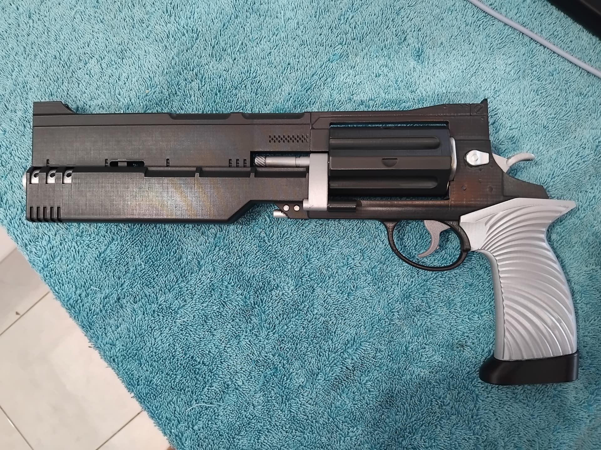

Loose test fit, before glueing…
A bit of flat clear, to go on the accessories yet…
The grips have a very interesting effect.
the weird “shape” causes moving shadowing, and a dynamic effect as you move it around…
imagine it, on @Friendly_Fire 's back deck…!!

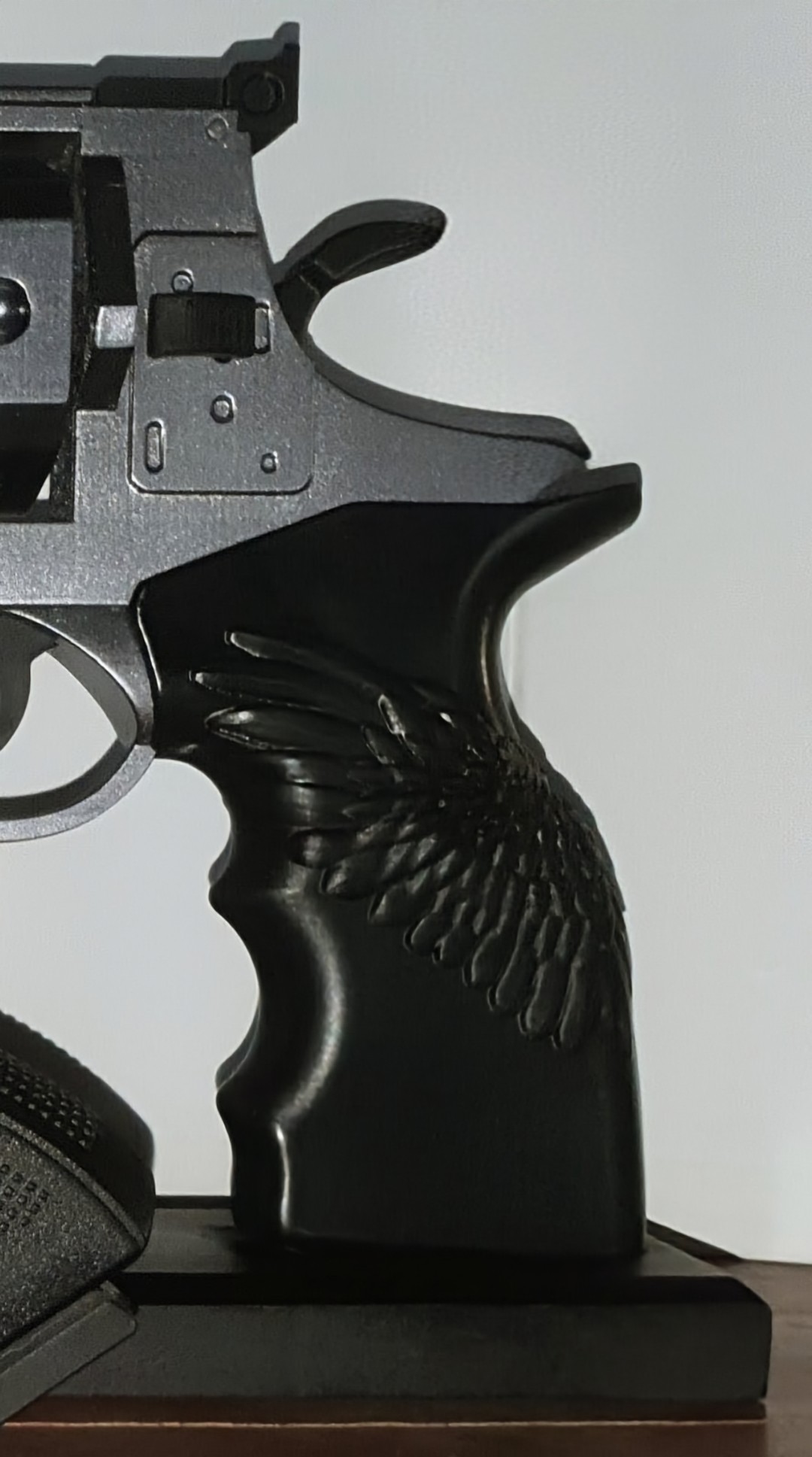

Looks good, Beemer. :+1: Nice work.
Although I have to say, I prefer the individual bird design on the other 3D print grip… makes for a better look, imo.
Shame you can’t get that grip design on this model. :person_shrugging:

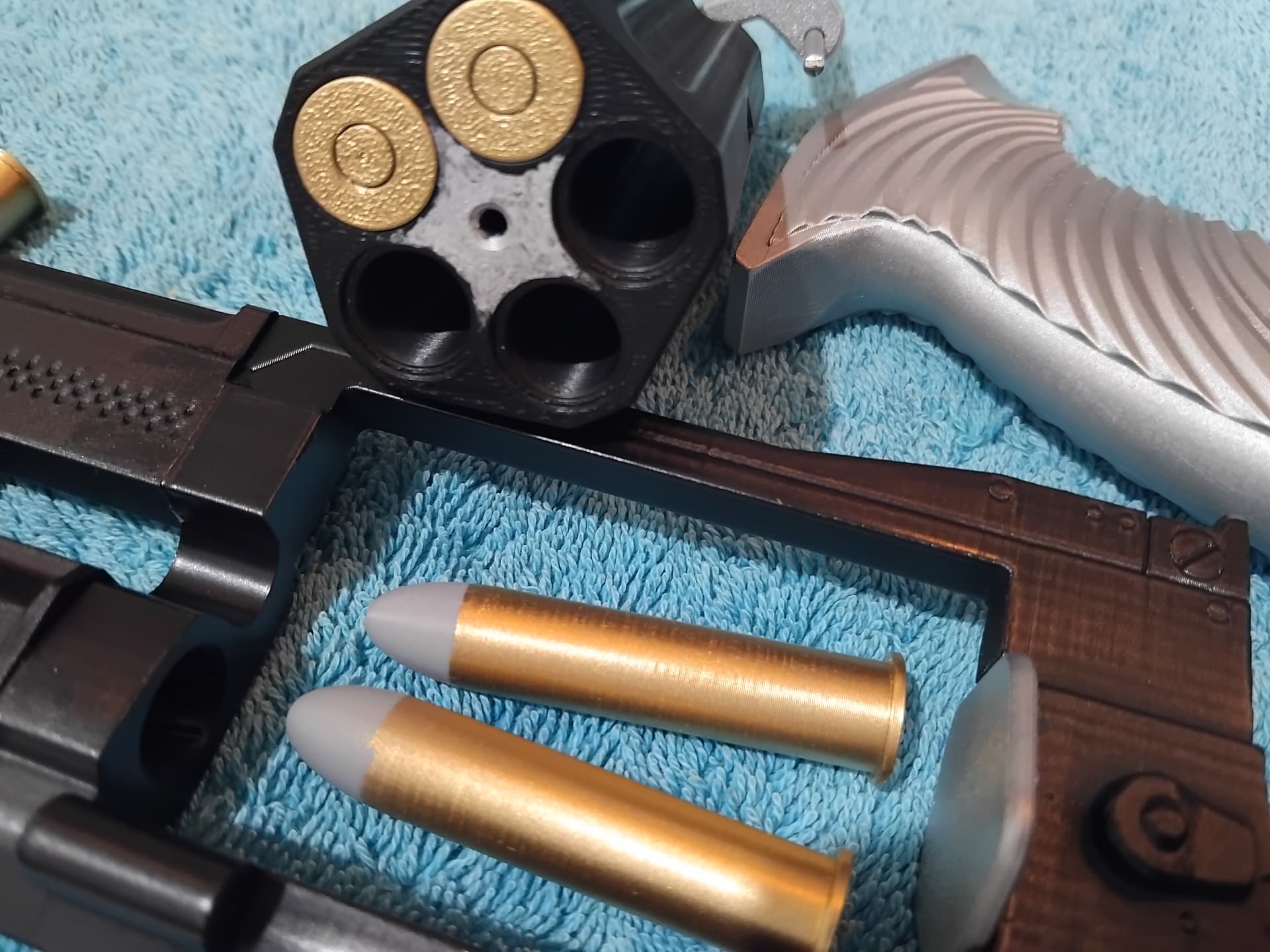

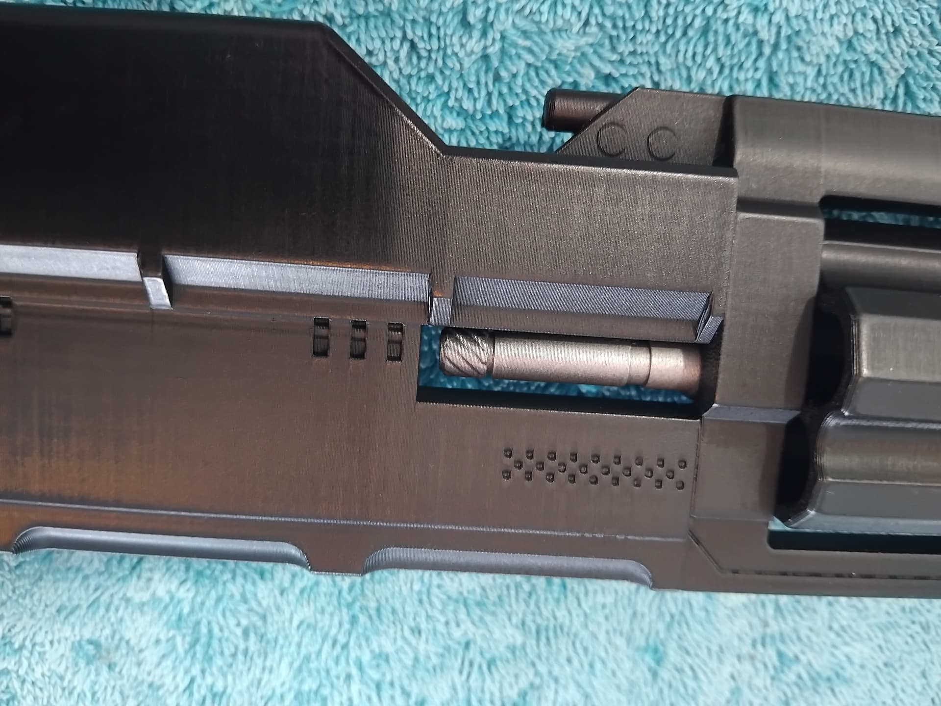

All was going so well…
then…
glueing accidents… grip and frame join.
grips…major … glue into space between raised ridges of grips.
Never gonna get that out.
Thankfully… easy fix, with my local guy.
A few bucks, and re-print some new grips and baseplate… start over again…simples.

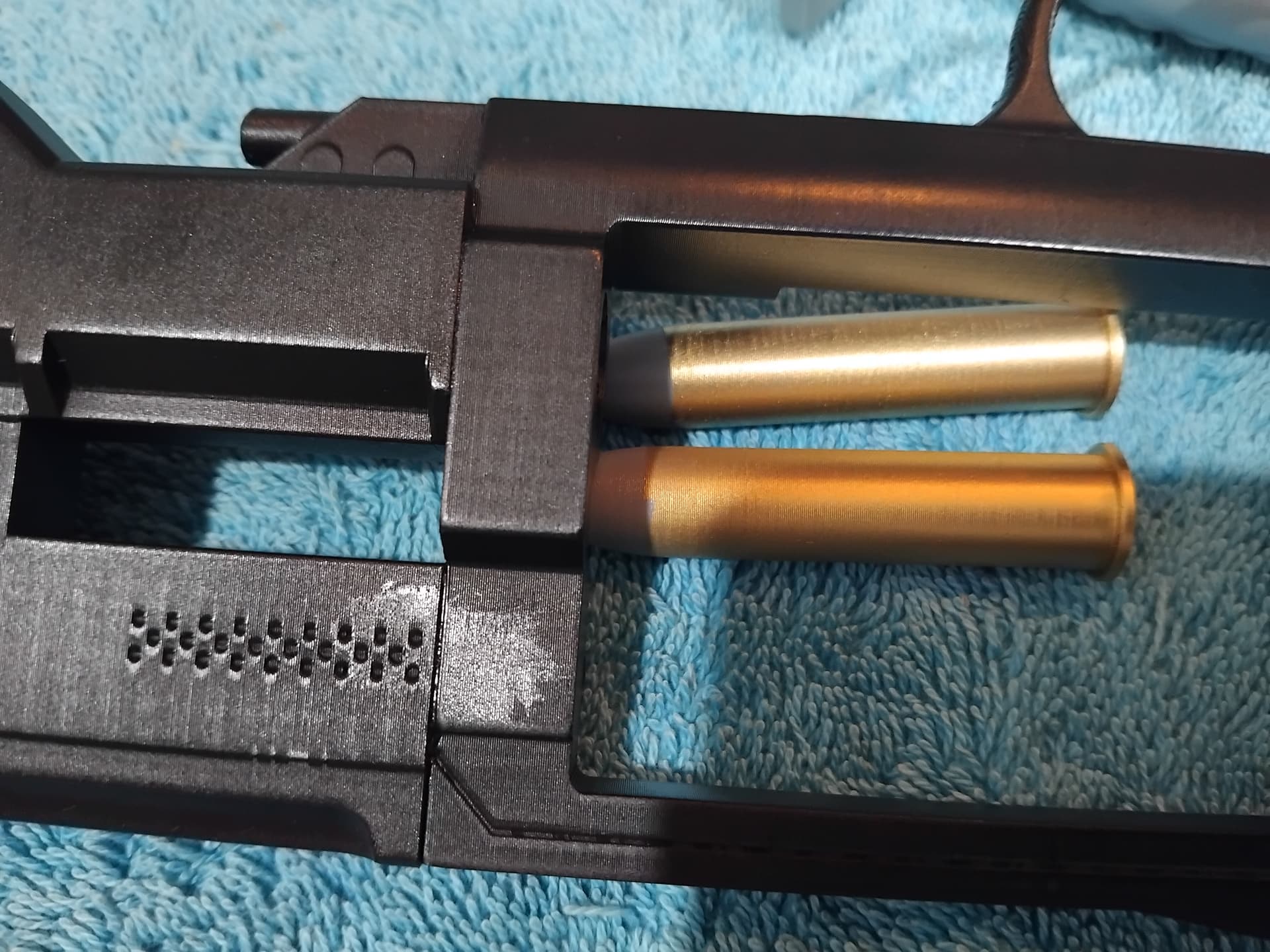

Frame to frame…
Some leakage out, in a couple of areas.
while setting, i wiped it thin, with chemiwipes.
I’ll let it set overnight.
Then, try to lightly sand off, the now thin section of extruded glue remaining.
Mask that area off, then repaint.
Sound about right.?
Theres always something…!!

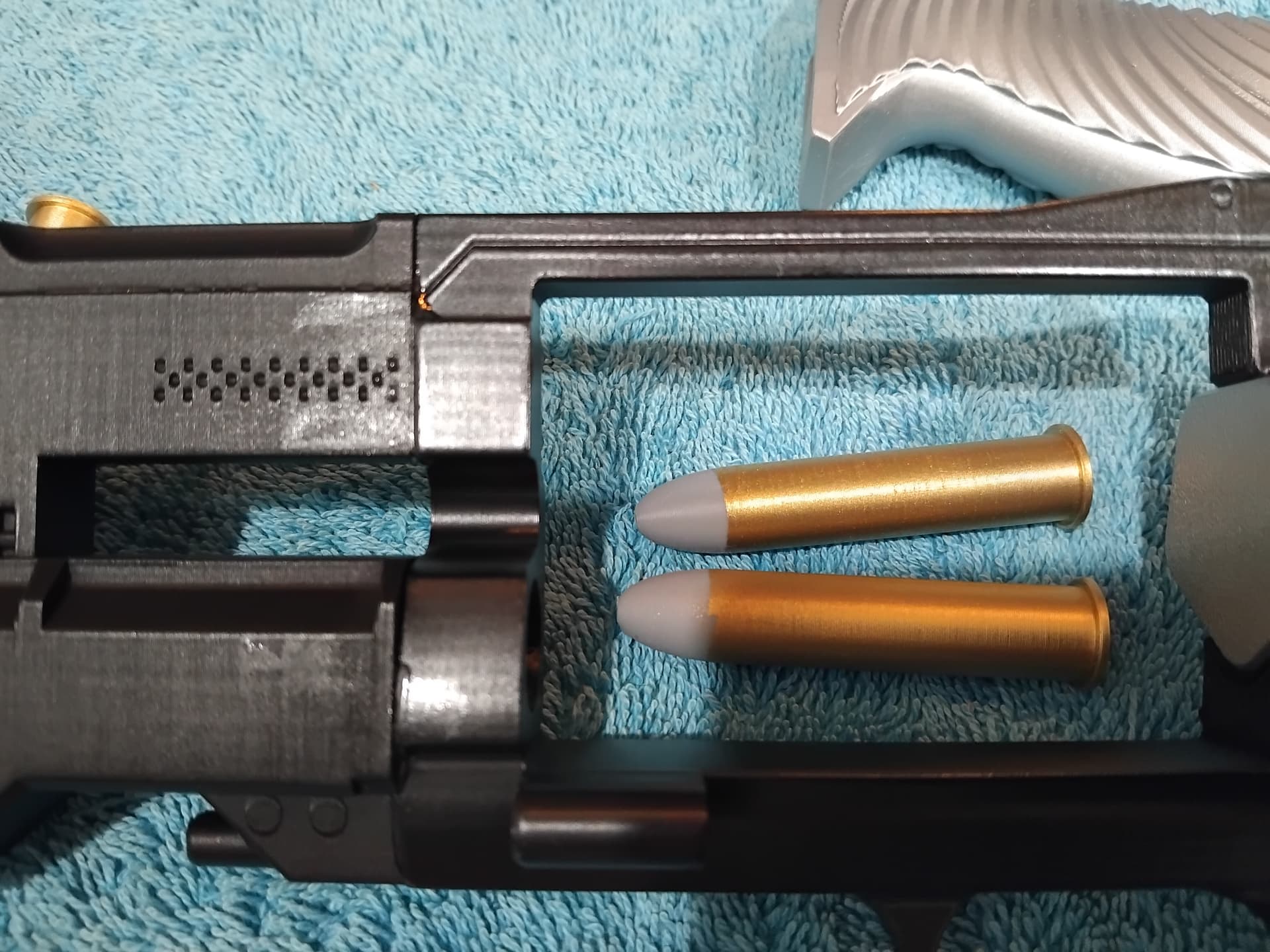

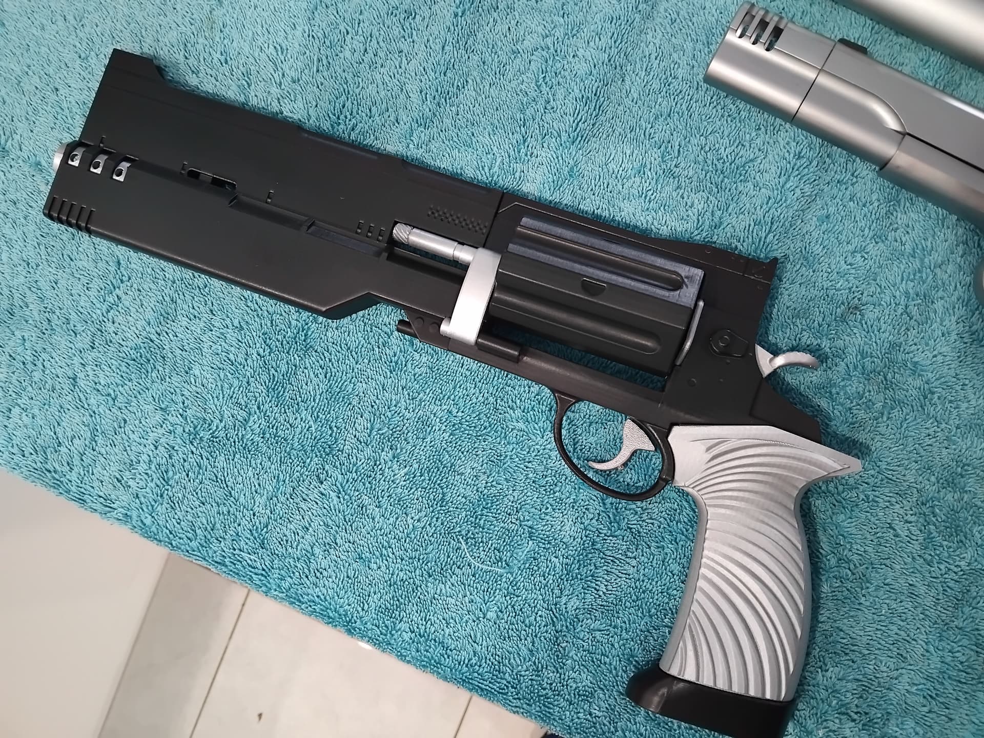

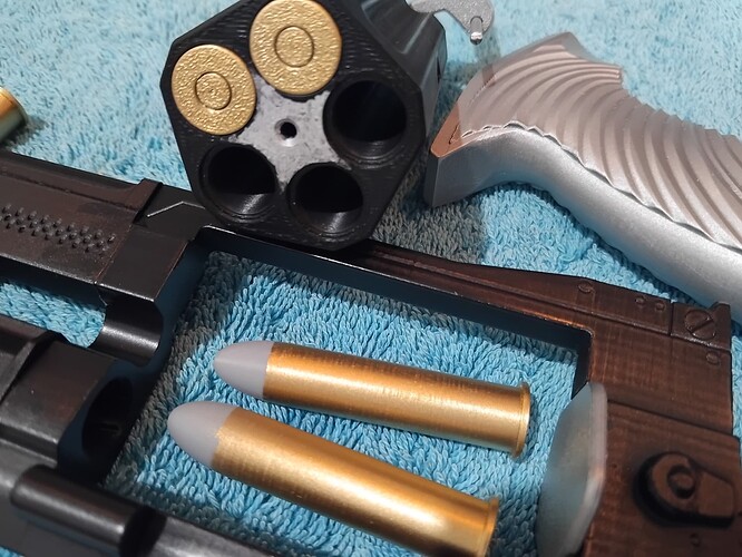

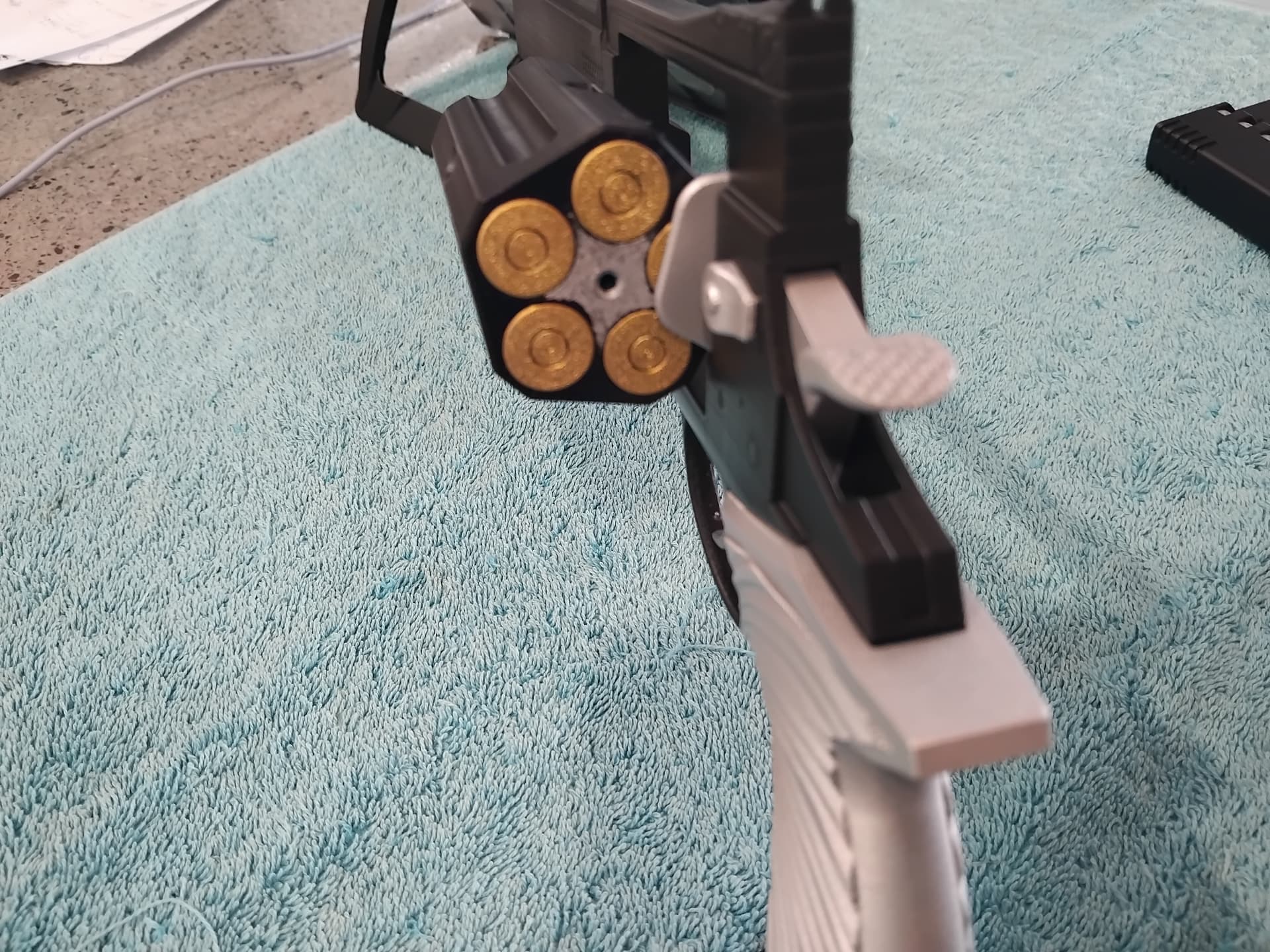

The bullets came up alright…
Taped off, and painted with gold.
i’ll reverse tape 2morrow, and do the tips with dark grey.

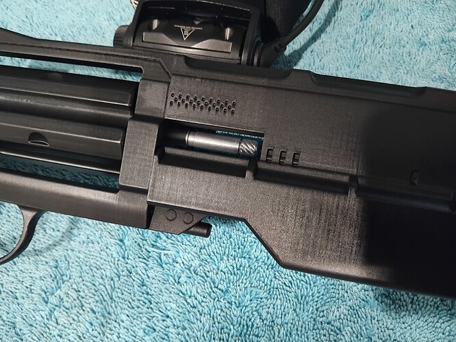

Nice detail, on the back of the cartridges.
Visible from the rear.
I tried painting silver on the inside of the cylinder…
tricky, uneven surface.

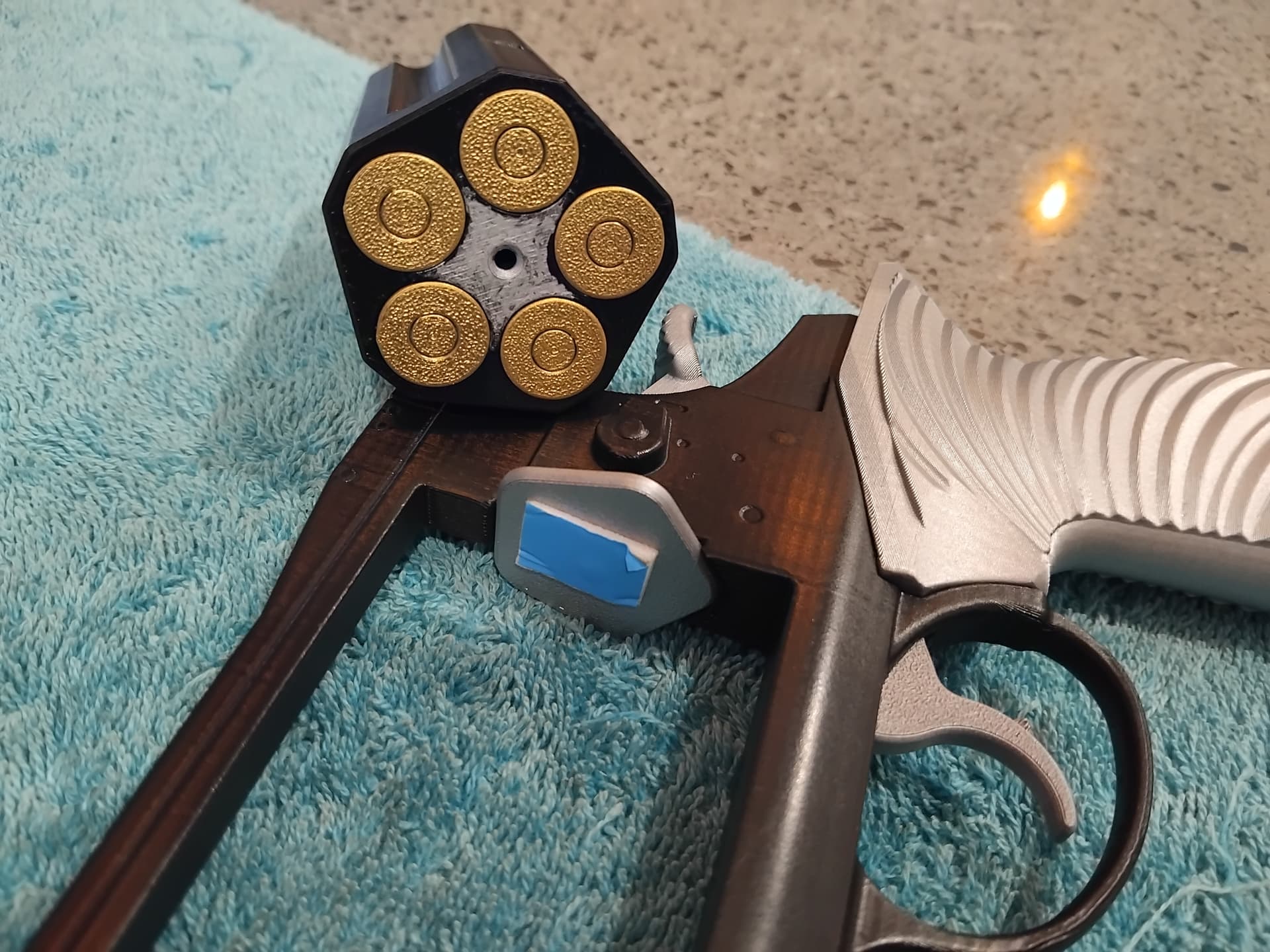

I was going to paint the cylinder release latch silver…
But i suspect it will not turn out well.
Now, you can see the glue stains…
Hopefully these can sand out, when dry…then paint over
Whats the secret, to successfully applying epoxy, on tiny areas.?
I used a small aplicator and left space/margins…but it still ran.
any tricks.?
Now you’ve done it. I have to pull out another great track, cheeky bugger. :rofl: :rofl:
If it’s a small repair and you’re using 5-minute epoxy you can mix the two parts on your palette then hold off applying for a minute or two until the mix has thickened up a little. Just don’t leave it until it’s like jelly. :person_shrugging:
Other than that, less is more is the rule of thumb with glue… just enough to cover the area and it doesn’t have to be a thick layer.

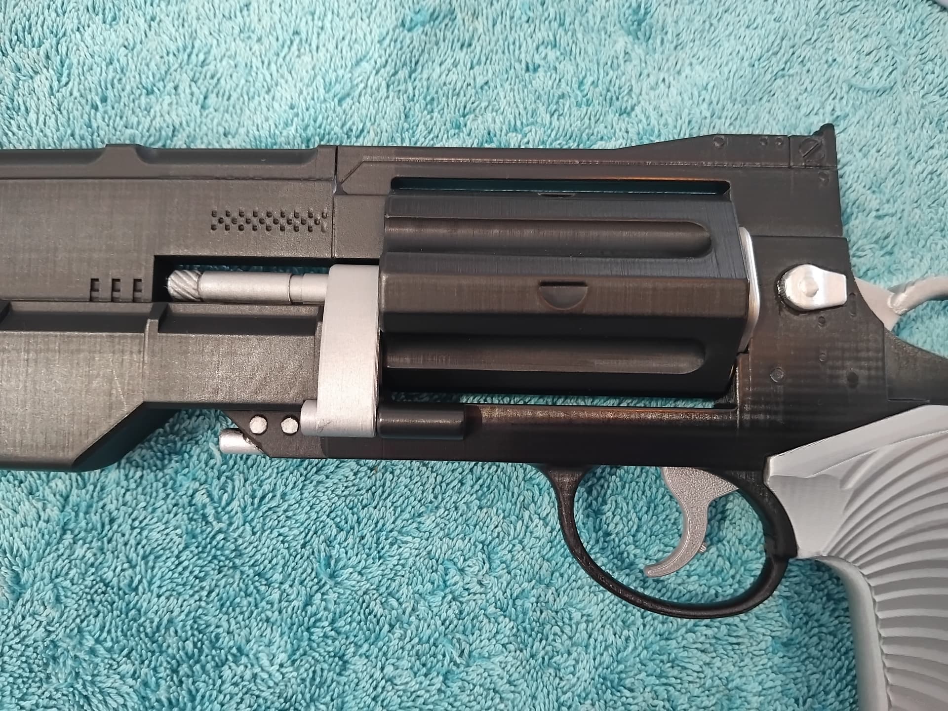

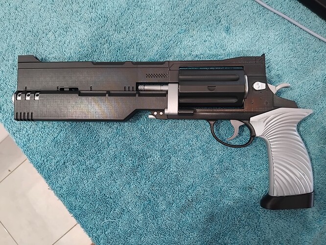

And Done.!!
Wet and dry sanding removed most of the gunk… a respray is not perfect, but much better…
Taped off the area, respray the area, dry and clear coat again.
I decided to do a few of the fine details…
silver on the small areas…cylinder release latch, front of frame etc .
Silver pasco pen as a base…then a small tub of x-11 gloss aluminium.
Came up alright.
To fix the slight sloppiness of the cylinder, i inserted some adhesive packing foam, at the rear of the cylinder frame.
It firms it all up, allows slight resistance to the cylinder push in / out, and allows slow rotation of the cylinder.
All done…!!
Just the new, unmarked grips to arrive and go on…

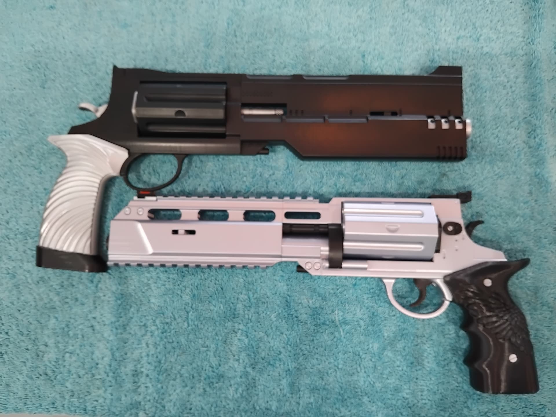

Comparo, with “original”…
