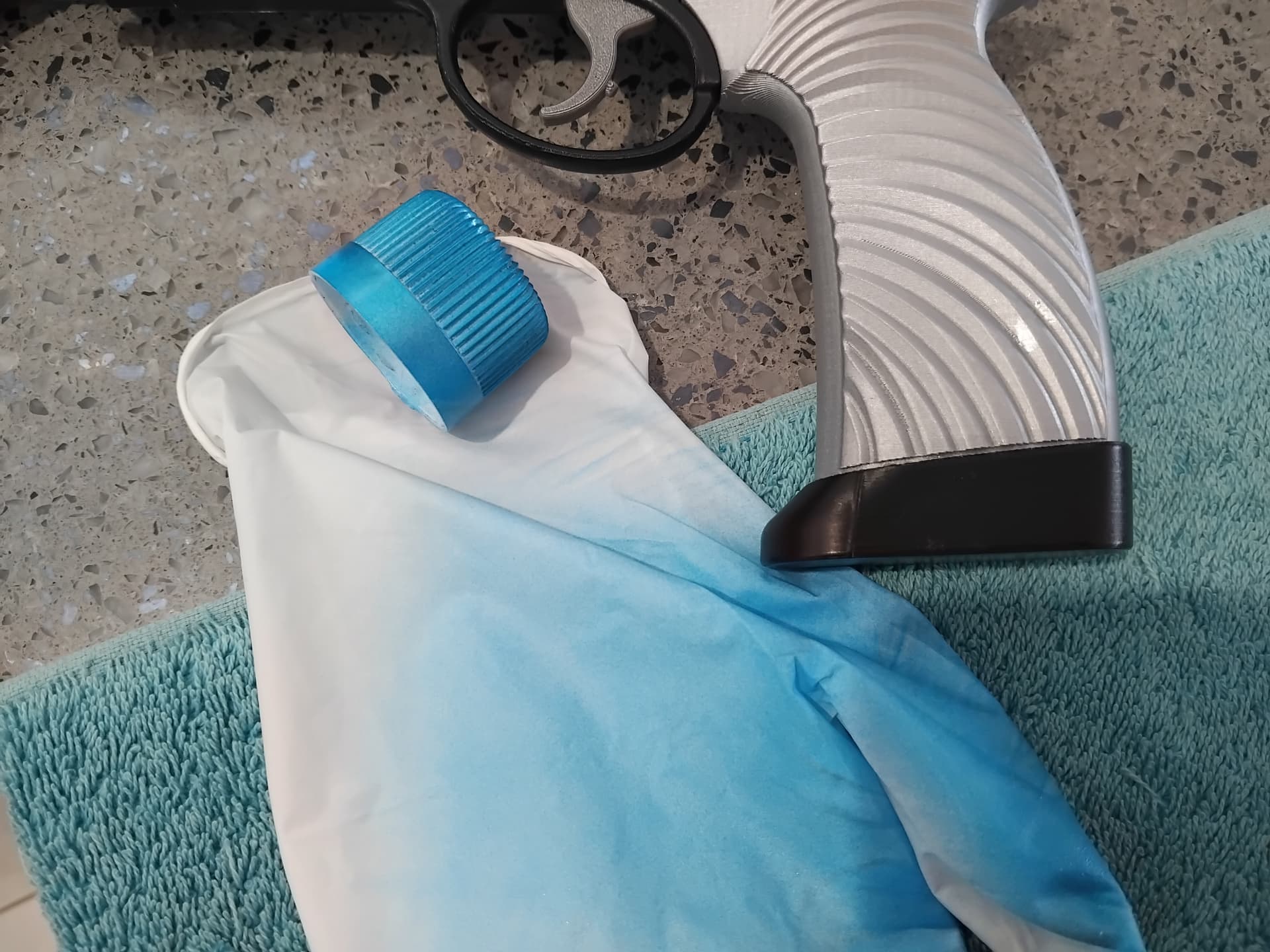

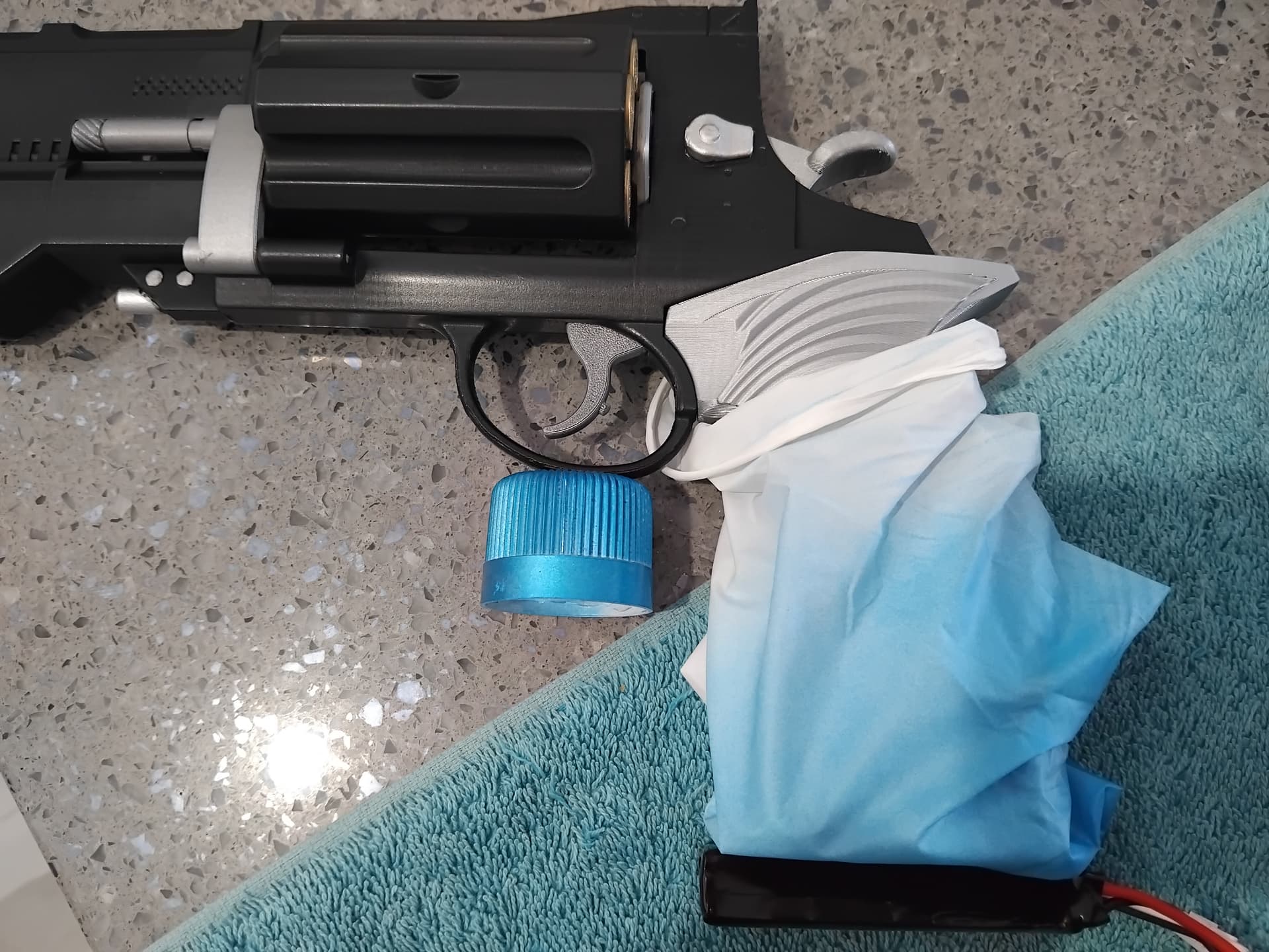

i painted up some on the cap top, coated with silver base…it has raised serrations, to penetrate…
Also, a light misting on the glove.
a few things became apparent…
1: in order to ‘penetrate the serrations’… you gotta get close, with firm spray prressure. this leads to a thick coat. A bit too heavy, and a bit too fluro blue for my liking.
2: spraying from a distance…paint barely reaching the object…gives the light thin coating reqd. Wether its enough to penetrate the “wider serrations” remains to be seen…

Anyway here are some pics…
bottle cap is a bit thicker…and a bit too fluro blue.
glove is the light mist desired effect…
Not as overpowering, but a bit more difficult to get even…every pass adds a bit more…

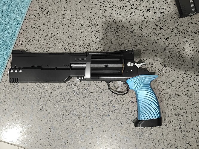

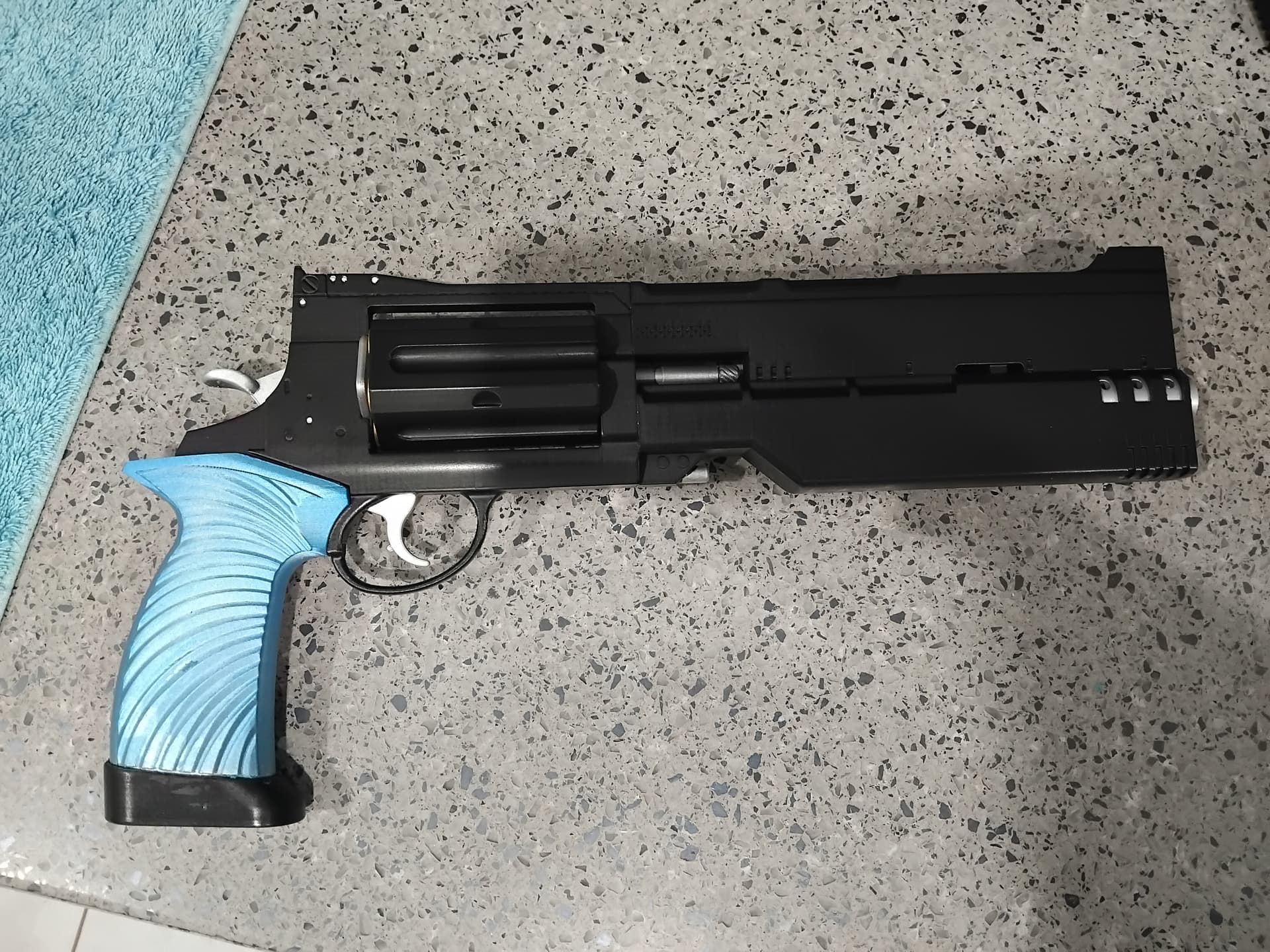

Mockup, on the blaster.
Framed by a black bar, on the bottom.
How it will end up looking, with the grip swirl effect, remains to be seen…
Coming soon, to a post box near you…!

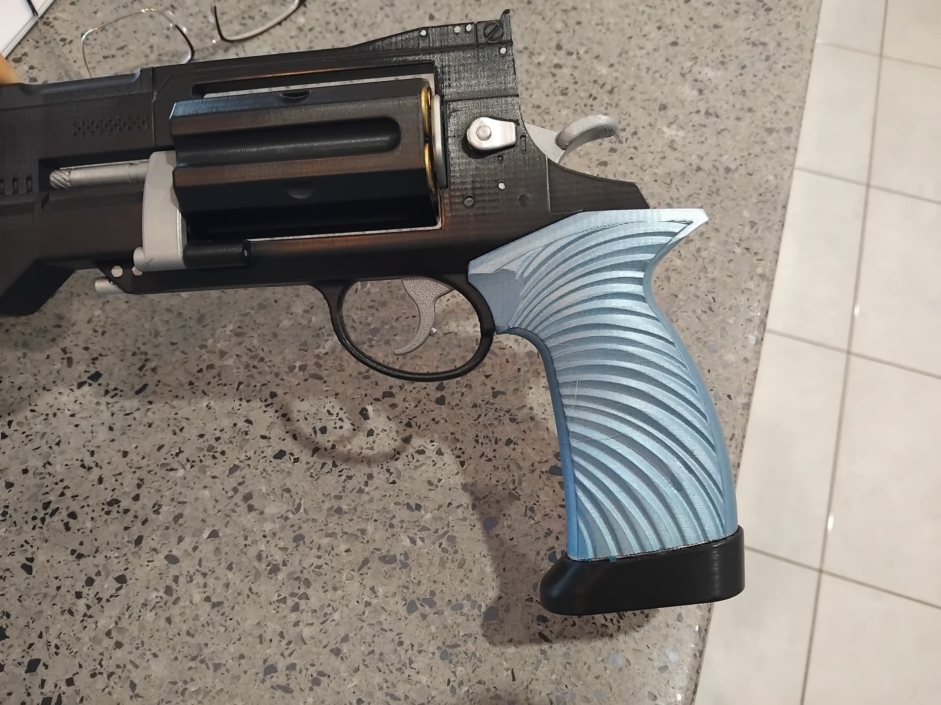

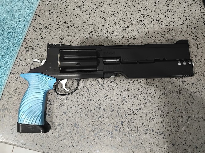

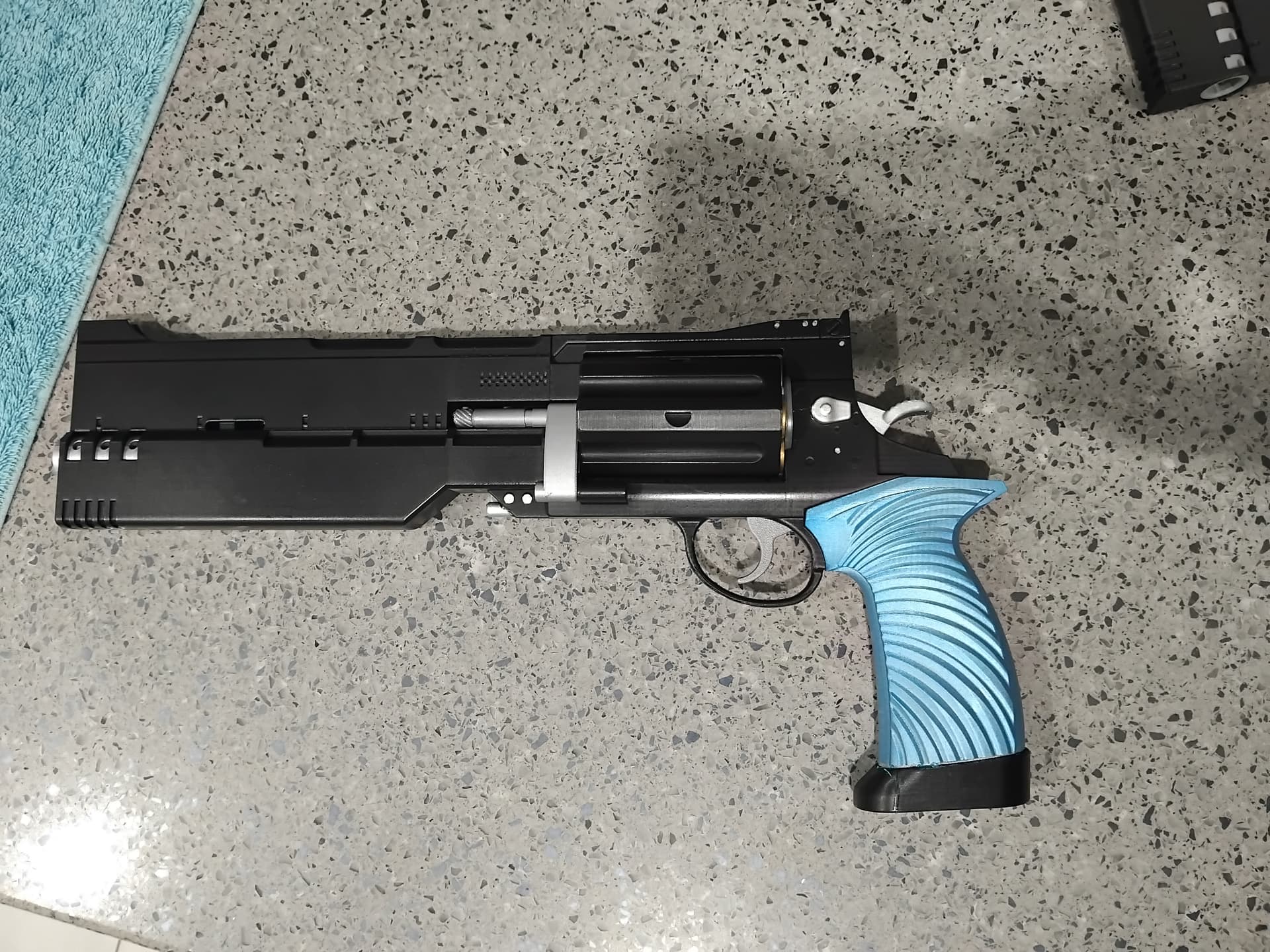

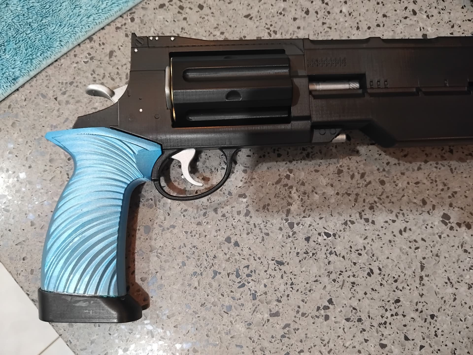

Okay…
extra grips coming…so painted the first " glue marked grips"…
like i said, its a bit of a challenge, to get a light misting effect, with even application all over.
The resin stains, get highlighted by the paint…

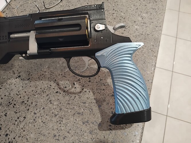

I’m sorta thinking…
worth a try…but probably not…
Hard to get it on evenly.
Even then, even though its light…its still pretty strong blue.

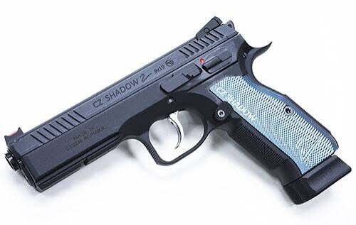

I like the grips on the shadow2…but this probably suits itself to silver grips.
Even with the game design, its basically grey with a very light , almost imperceptable blue twinge…
Still, you never know, unless you have a go…
Sorta similar to the shadow2…
Nice work. Sort of needs a bit more grey in it by the looks to tone down the blue sharpness.
Not sure, great progress though :+1:

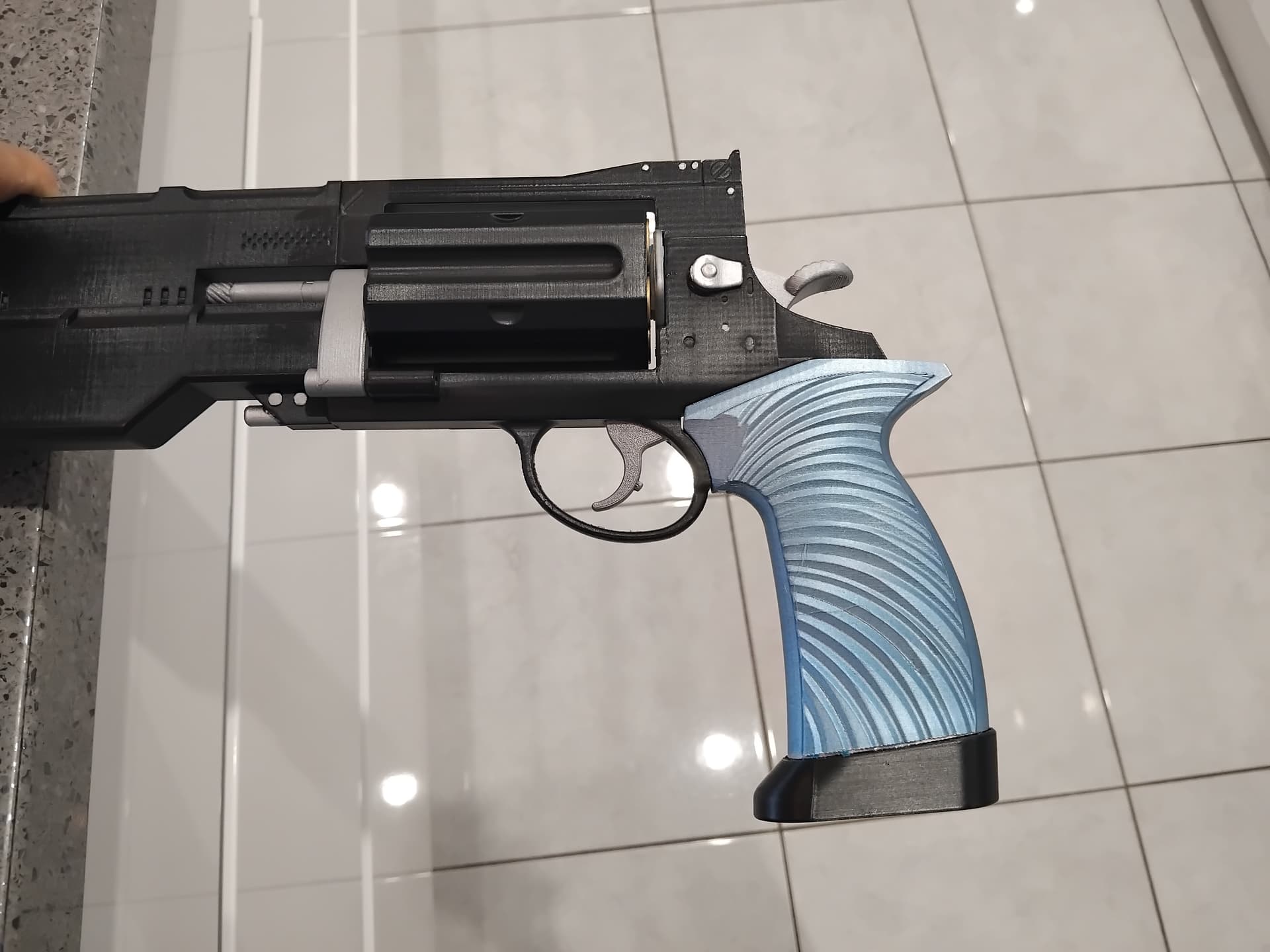

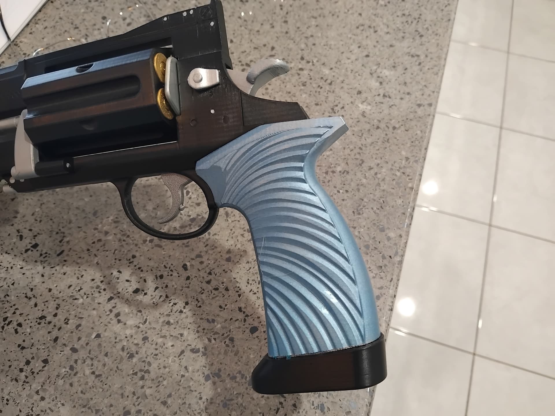

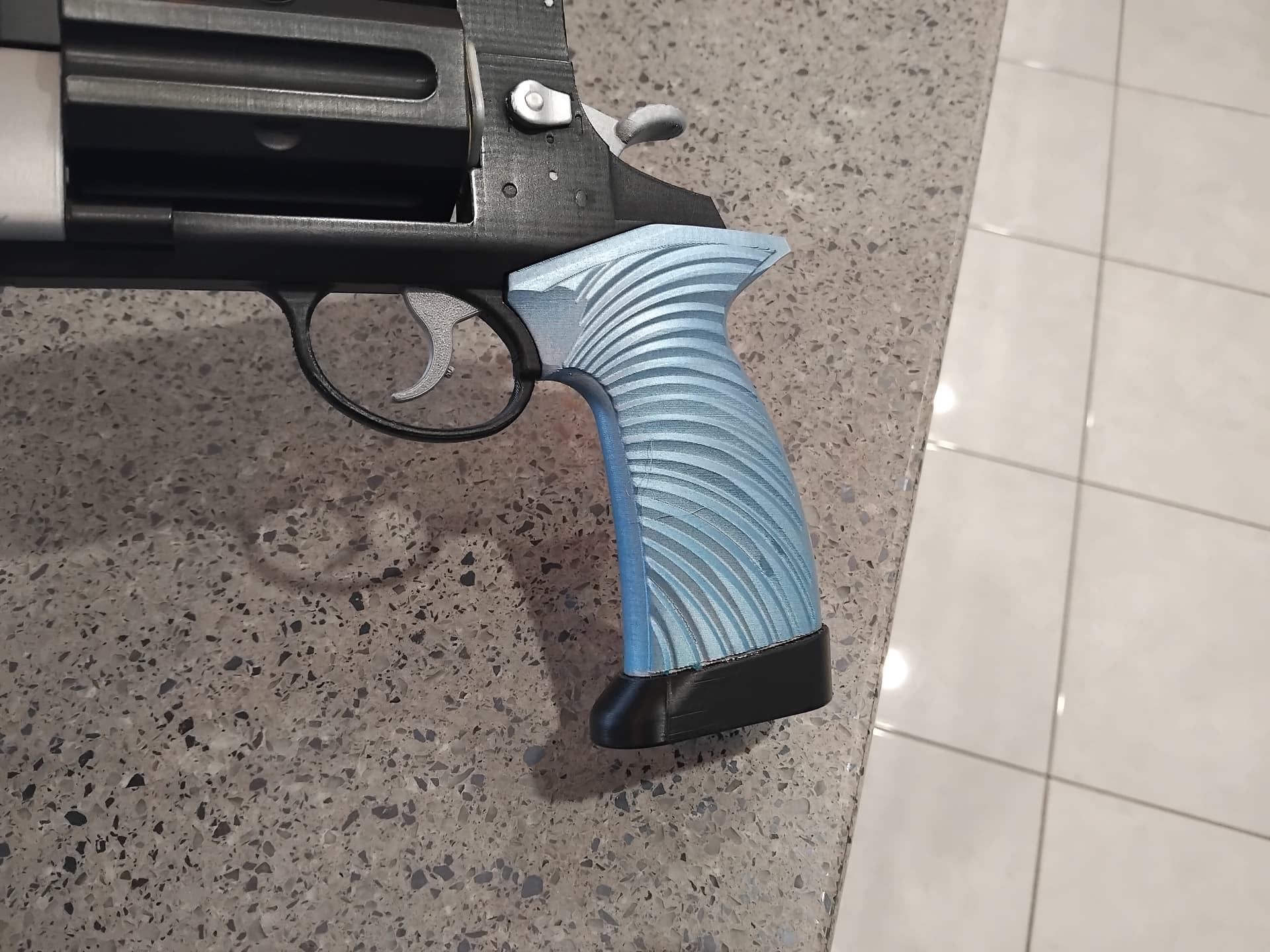

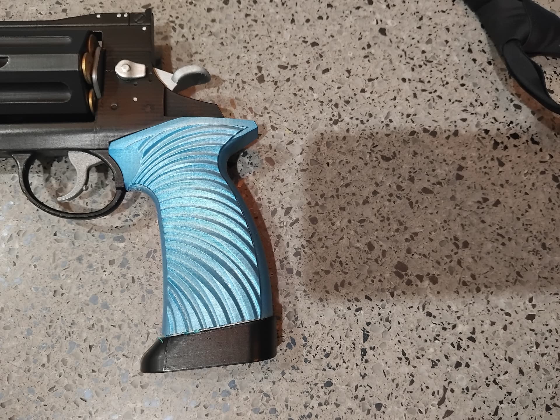

Progress…
a bit of “watering it down”…
A bit more silver on top, to tone down the blue, followed by some semi gloss clear on top…
Getting there.
This is one of those pieces, where you you change the angle, you change the shading.
Ultimately, only a practise piece, with the resin marks…get the technique sorted for the new grips…
i might do one more hit of silver, just to lighten it a bit more…

It’s tamiya that does the magic.
It’s expensive , small cans …but…
Sprays perfectly, dries quickly, nice thin coats, and doesn’t run.
Good gear…!
