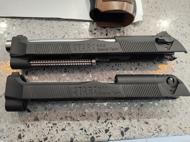

A bit more info, concerning the silver models.
The “GEN 1” silver, which i used on my Wesker/supp combo…has a different shapes slide.
It does NOT interchange, with other KELe M92 models…hence why i had it cera-coated black, for the Wesker model.
The new Silver Kele “GEN2”, uses the same frame/slide as the new black model…meaning slides/ barrels are interchangeable.
So, you can do this…
If you wanted a black one, im sure you could polish the black barrel down to metal, ala DB style, to get a silver barrel.
But, i like the two, 2-toned versions…
This shows the physical difference, of the slide/frame, on Gen 1 KELe, vs Gen2…
The Gen1 Silver is the better of the silver pistols, IMHO.
The silver is more shiny and lusterous, and the trigger, hammer, switches and levers are silver, not black.
That is important, if you are wanting a "all silver " blaster…
