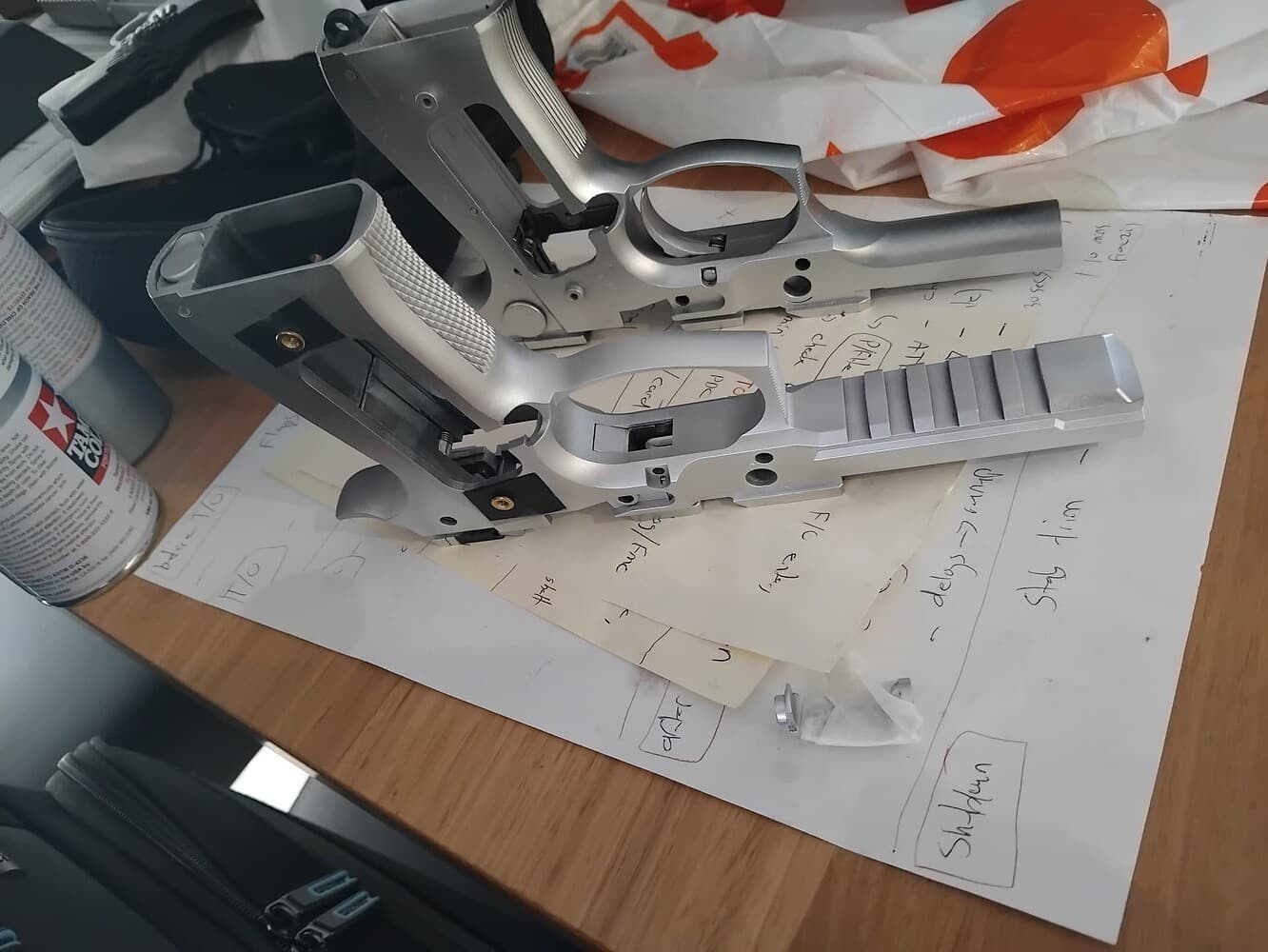

sly side project, to see if i can replicate that gleamy metal finish…

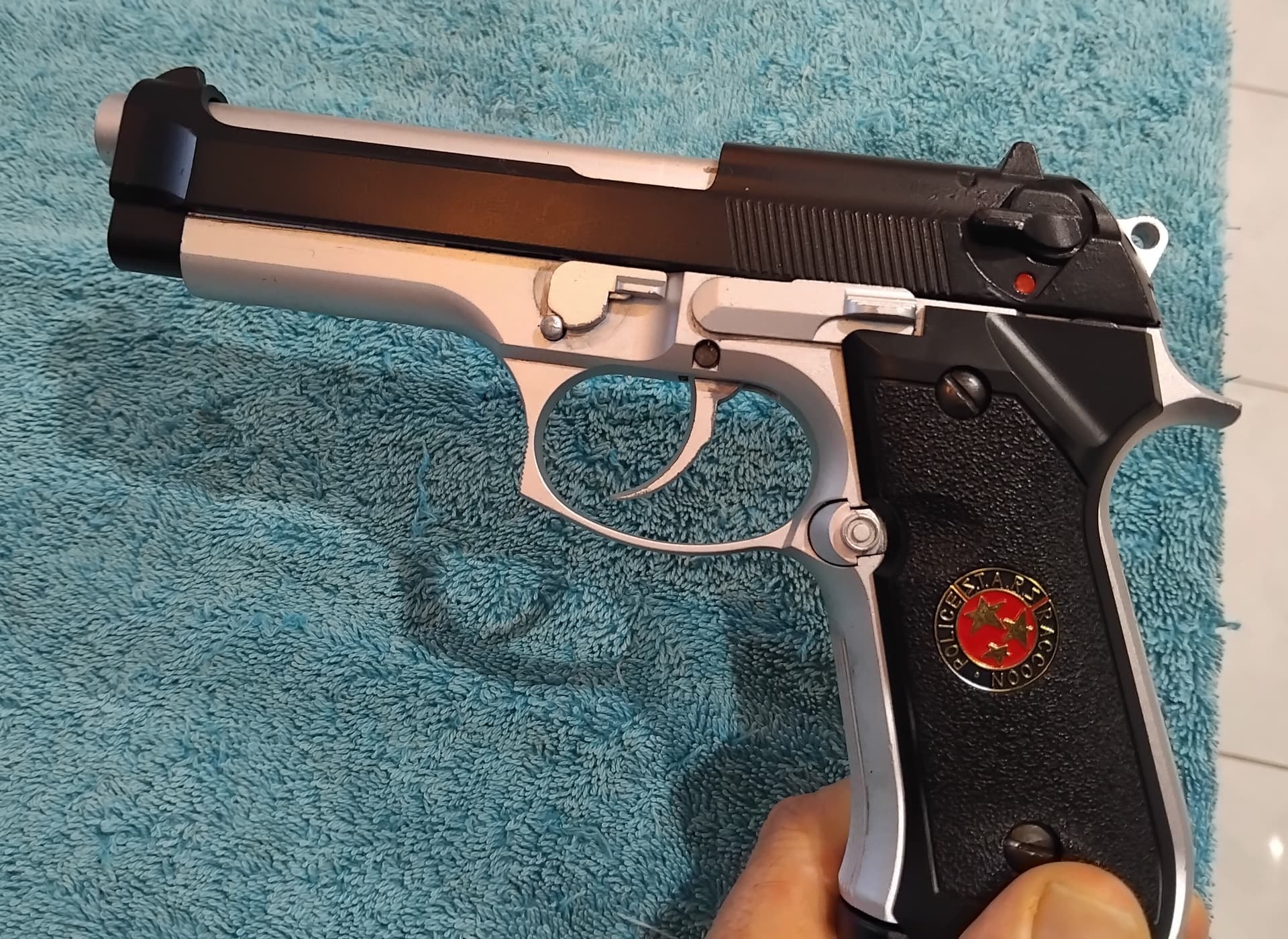

Here is the CO2 M92 i picked up from hippo’s 2nd hand ( thanks, @Friendly_Fire )
It was a cheapy, 2nd hand, metal base receiver the same as the other one i trial painted…which came up gleamy…
Out of the factory, this was " painted silver".
It also has the “whitish painted silver”, but is capable of gleaming…
The frame and OB are pretty average now…and the paint is a bit faded / tattered.
The outer barrel is showing paint wear marks.
A good excuse to pull it down, strip it clean it and repaint it.
I think the secret to the ‘shiny metallic silver’, is a strong black base coat.
I might even paint some plastic spoons while i’m doing it…
1 with strong black base / 1 with thin black base / 1 with no black base.
then cover with silver, and see the end results…
Hope to get it gleaming, like the practise frame.
I’ll also strip the outer barrel down to bare metal and polish… see how good it comes up…
Mind you, this is just a distraction project…
gotta get onto the Sentinel-9, still got that complicated feeling…!!

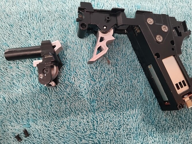

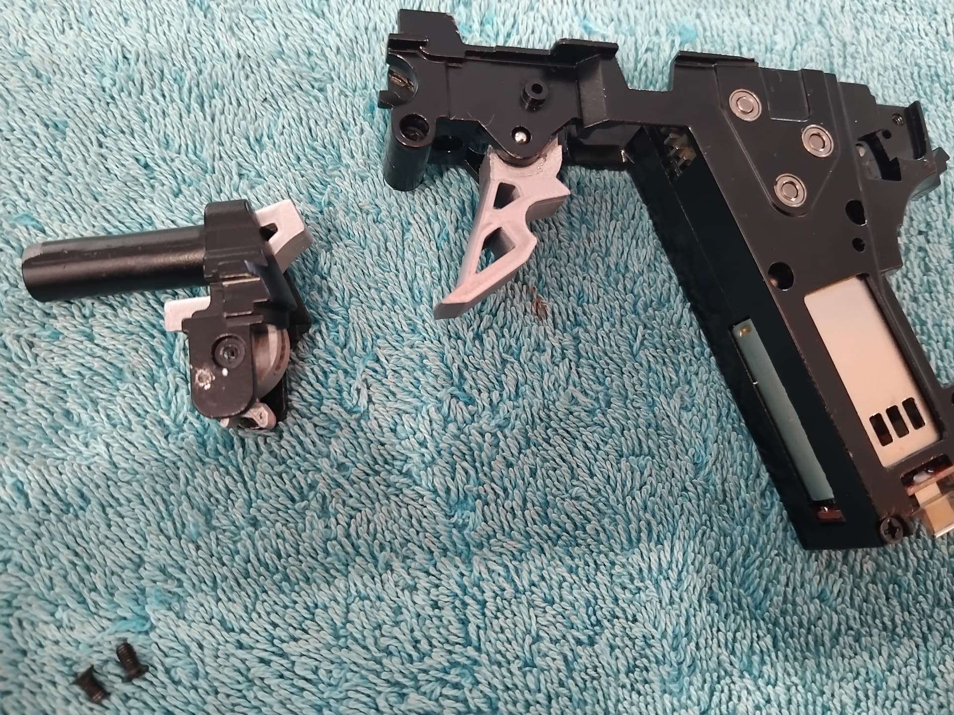

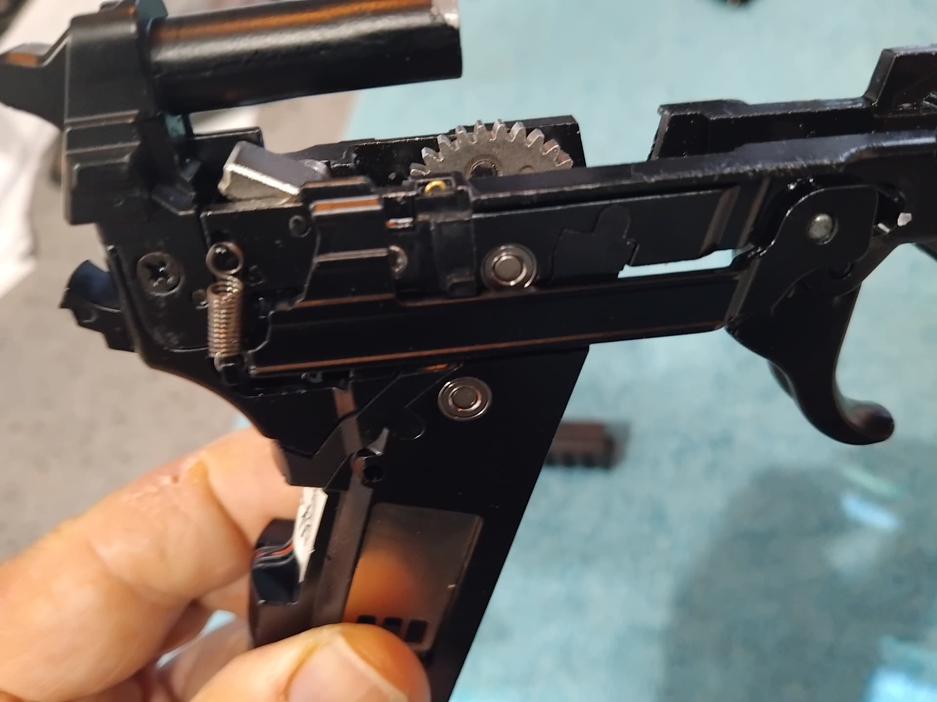

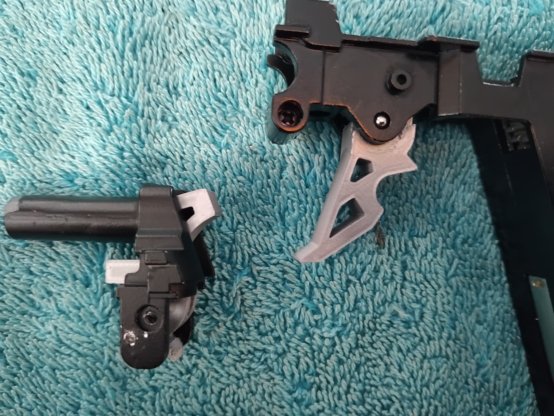

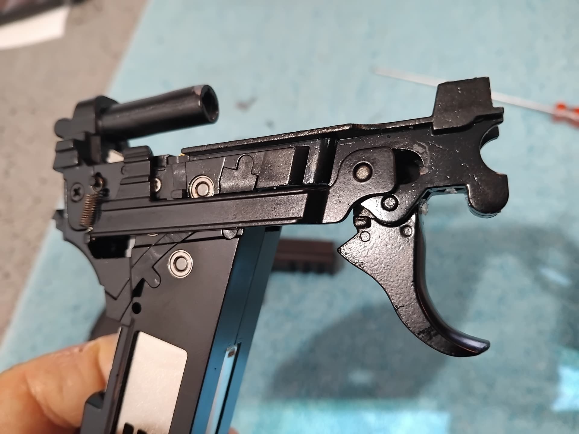

Sentinel 9…
over 6 hrs today…just to get it opened, old trigger out, new trigger in, old hammer out, new hammer in…
And all working properly.
Bloody tiny, fiddly springs…!!
That bend easily, and need to be straight, for everything to go back in…!!
its only in the depths of despair, when you are about to rage quit…
That you ultimately heat that ‘Click’ … !!

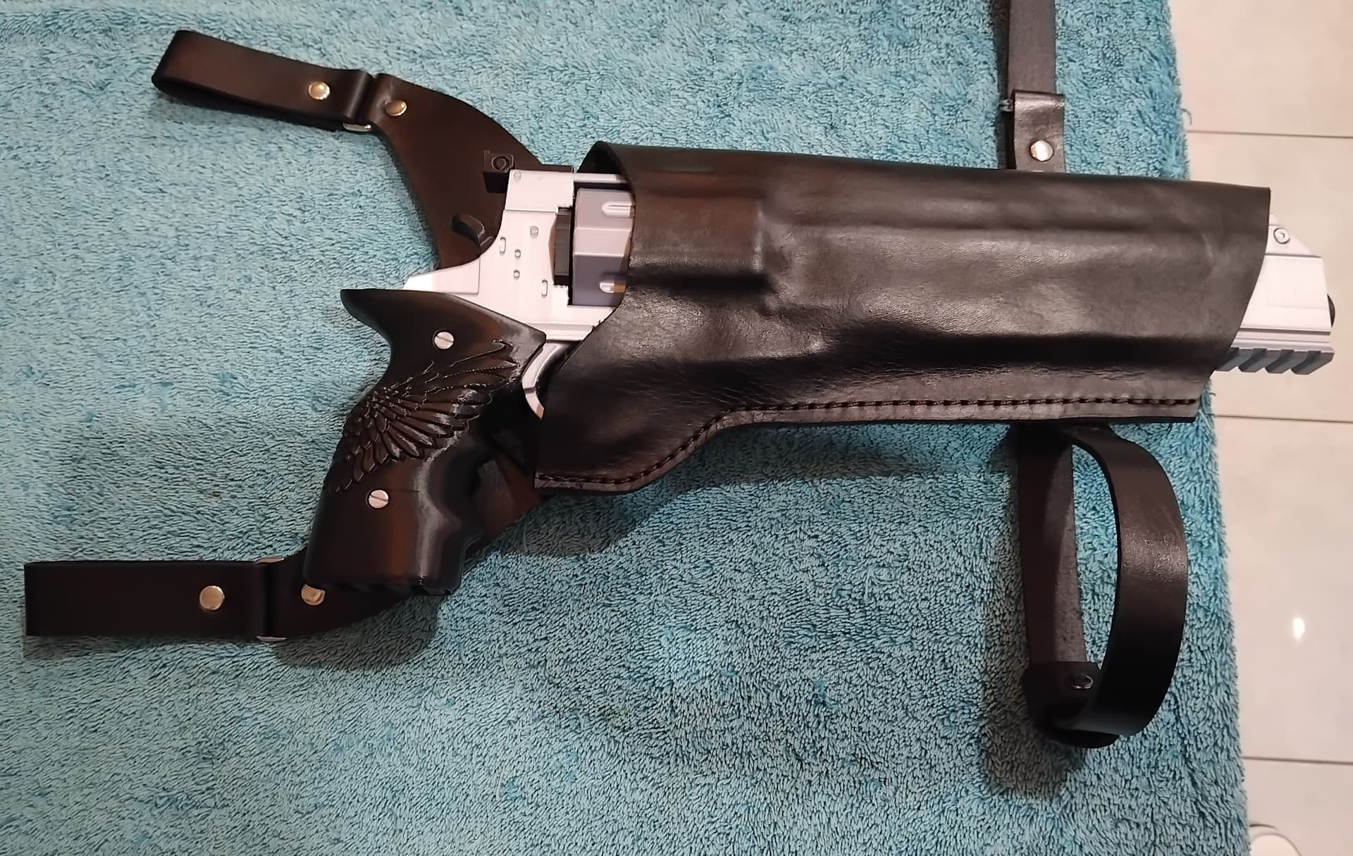

Talk about the Sentinel, you say…??
Hold your horses…!!
Or, at least, Hold your Requiem…!!

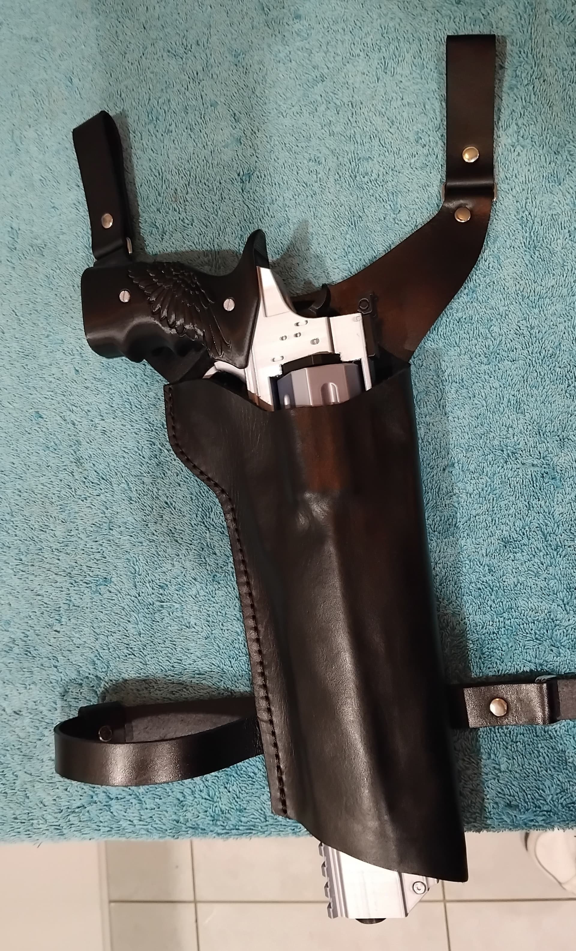

Holster from ETSY…pretty good overall.
The only thing is, the leather is a bit rough on the inside.
It will scratch painted 3d prints.
Thankfully i have one that is 3d printed in the metallic print material.
Its not scratching so far…scratch resistant material.
But, thin painted jobbies, stay clear…

Man, what a exercise in frustration management…!!
As i said, it took over 6 hrs to get it apart, and do the hammer change / trigger change.
Those are the worst springs… tiny, fiddly , needing to be wound and inserted under tension…and flinging off.
The hammer spring was the worst… it had a bent spring which had o be straightened AND sitting perfectly flush to fit within the hammer enclosure.
Then, a through pin had to be inserted…one chance or start again from scratch.
Came sooooo close…so many times…
I pre widened the receiving hole, for an easier push in.
Thankfully.
Not an experience i would care to repeat anytime soon…

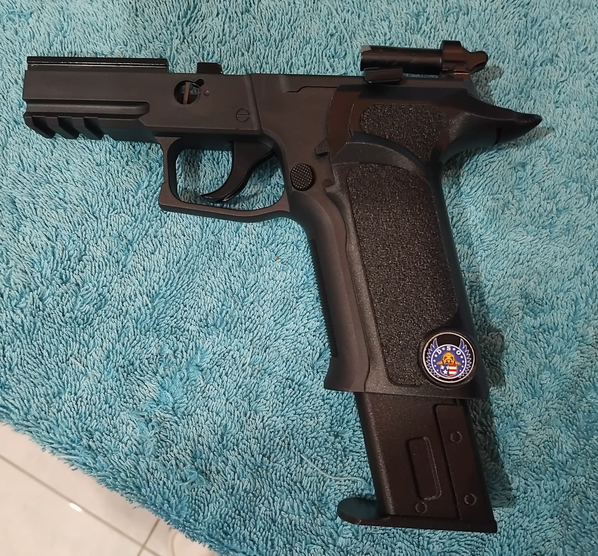

751

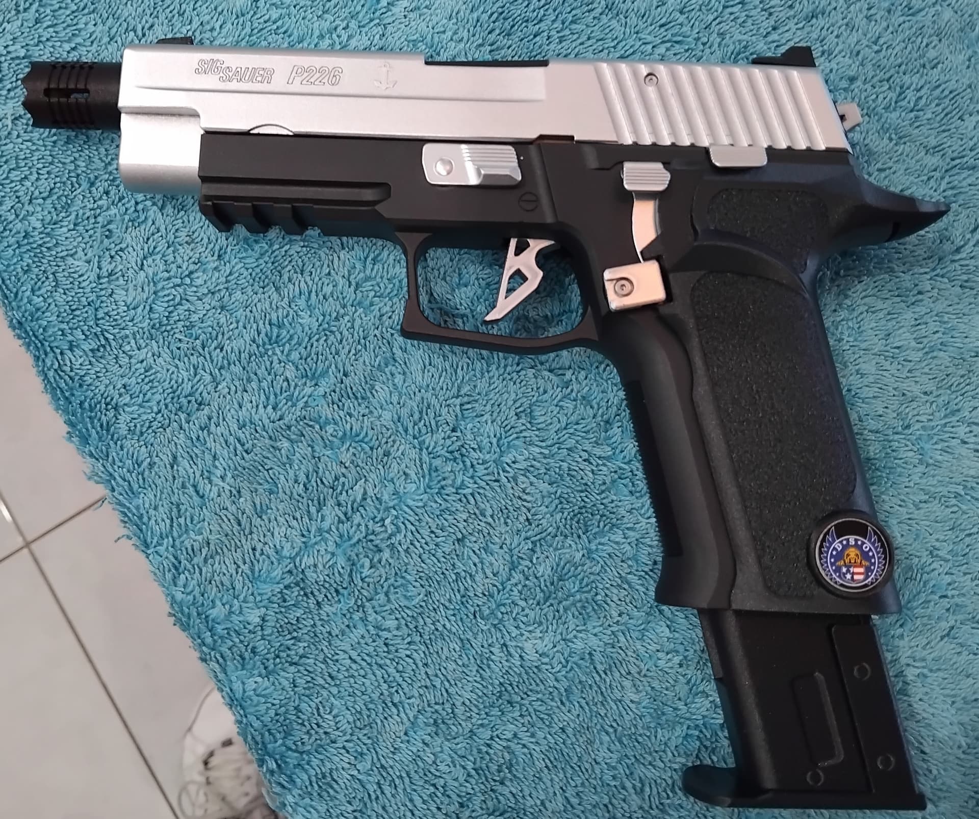

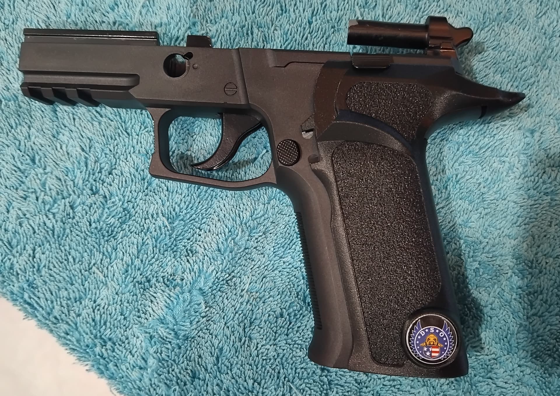

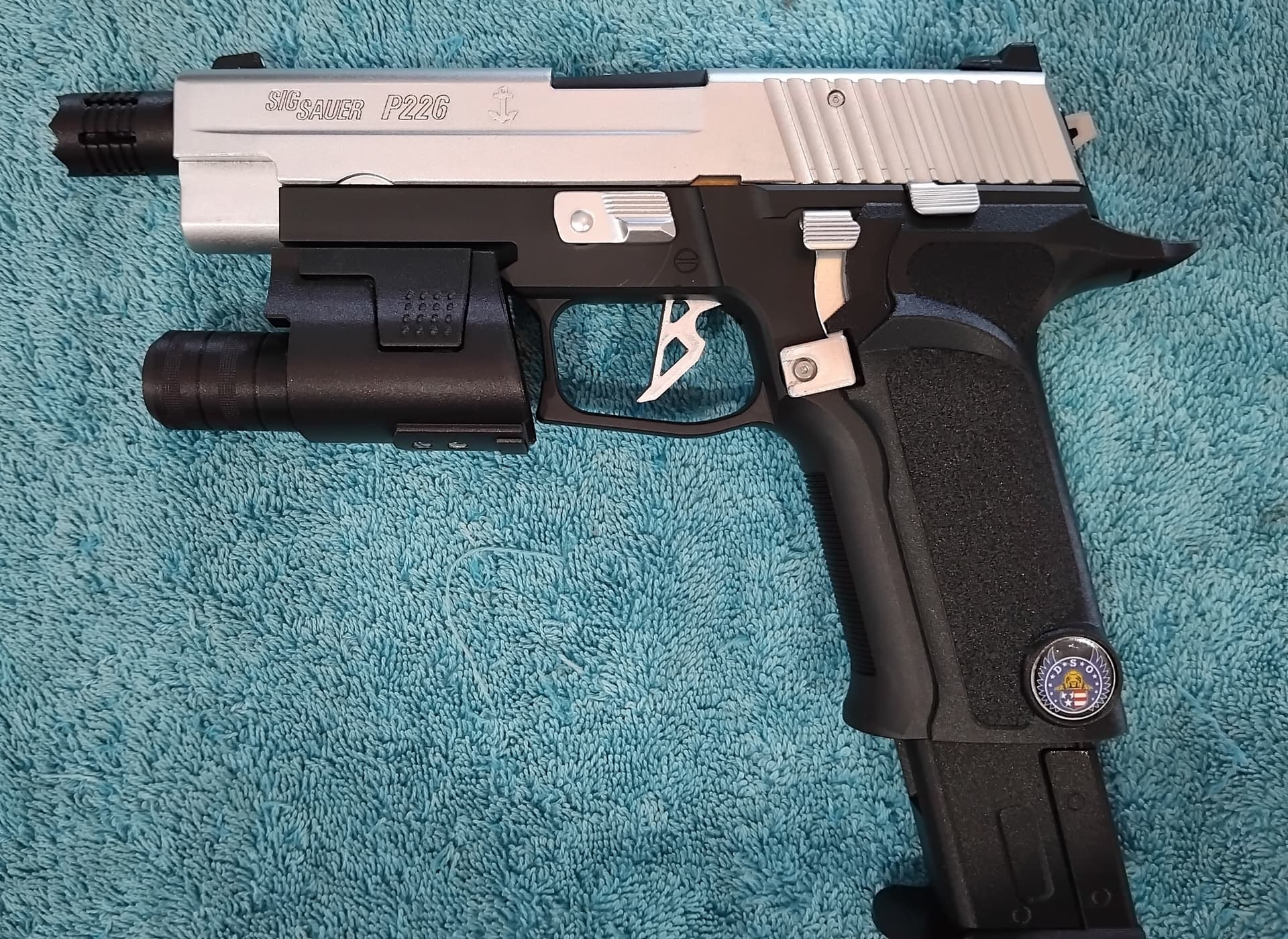

But, starting to look the goods…

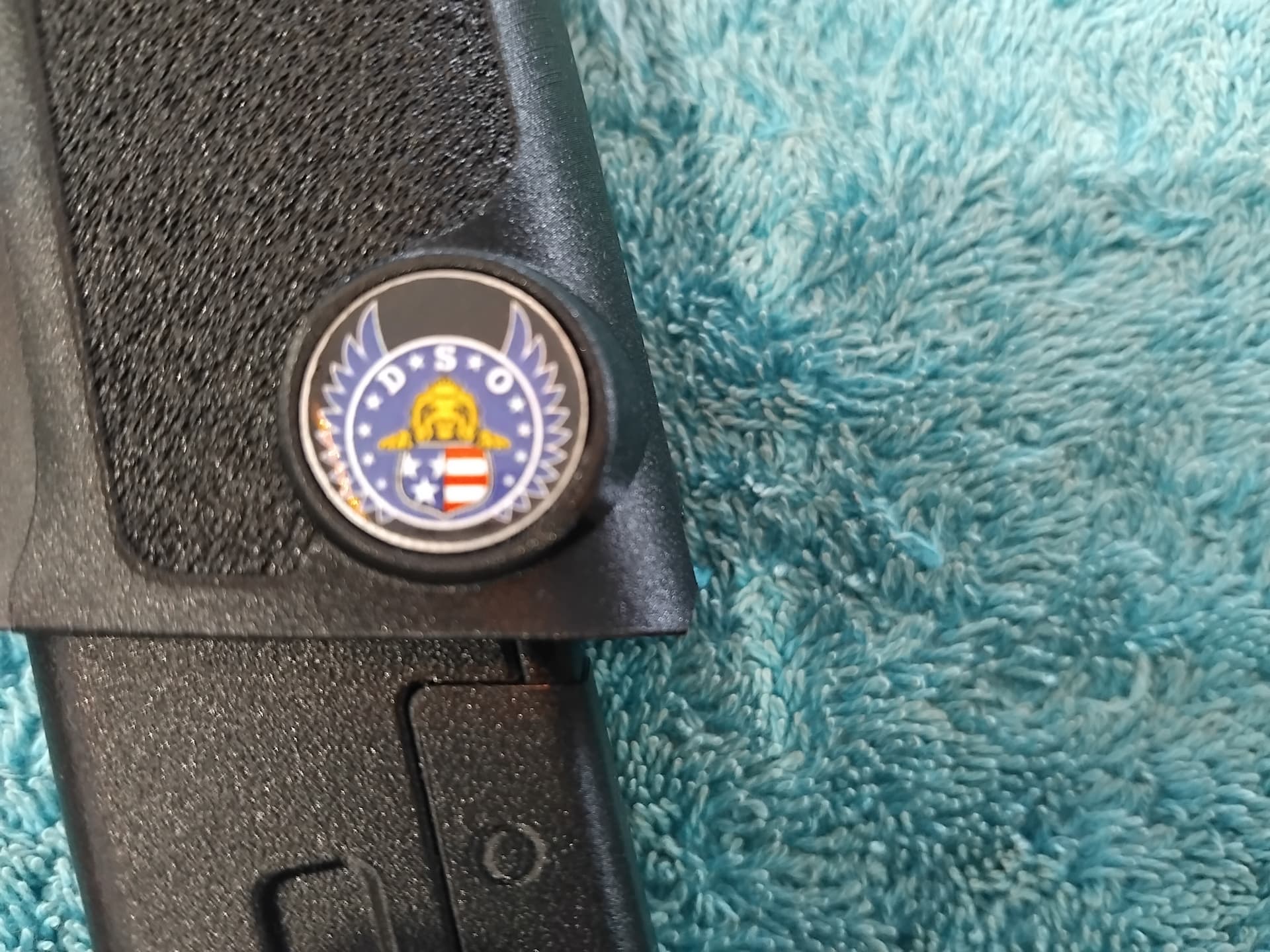

The guy who designed this 3d kit is extremely good…
Its top notch quality, and fits on really well.
the grip slides on, and grips very tightly.
The medallion is very well designed and clear.
BME
October 17, 2026, 9:26am
752

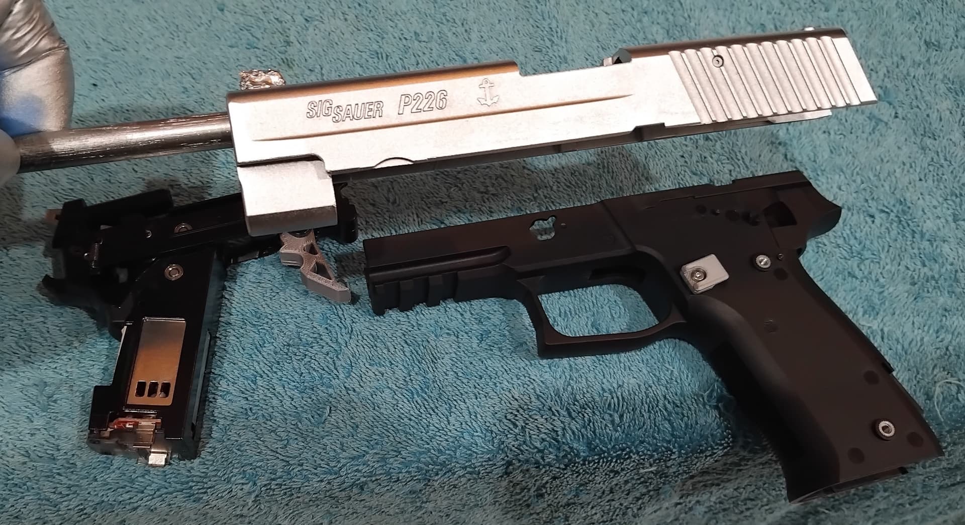

Two parts, that took so long…!!
standard trigger in.
Got all the switches painted, first coat on the slide.
Let it dry for awhile, 2nd coat and overnight dry…

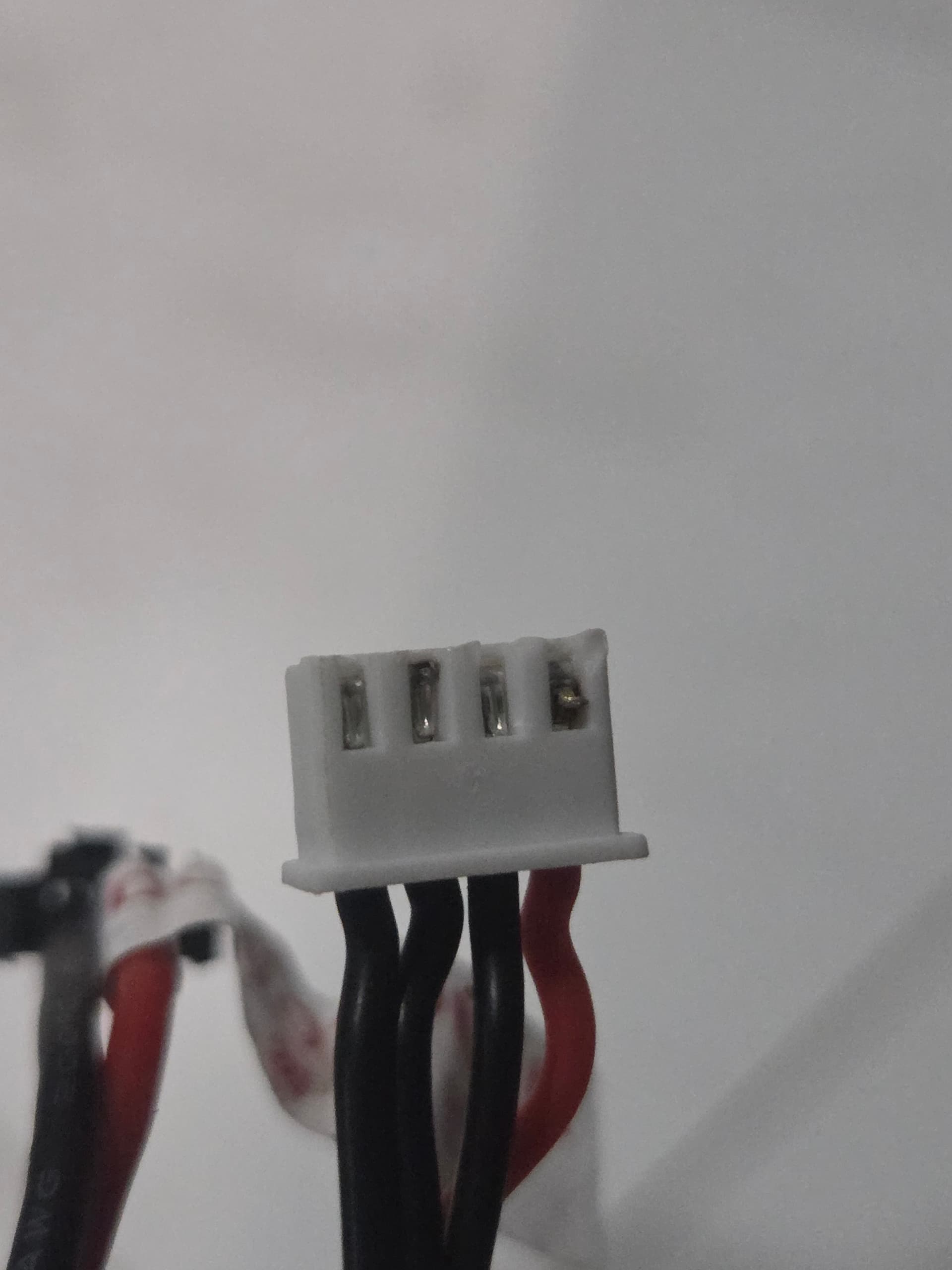

Hey guys target practice here i have an issue if anyboyd is willing to help please respond to this mesage thank you
BME
October 17, 2026, 9:37am
754
What seems to be the issue.?
Well i plugged my battery into my balance charger i know the charger is done for by the smell but i am unsure about the battery the connection looks like it had taken a bit of damage
BME
October 17, 2026, 9:50am
757
dont muck around with lipo’s…they can catch fire.
If you have a dodgy charger…bin it.
Try the lipo (if youre game) in something you can easily / quickly disconnect it.
But, the safest is just to get another battery…

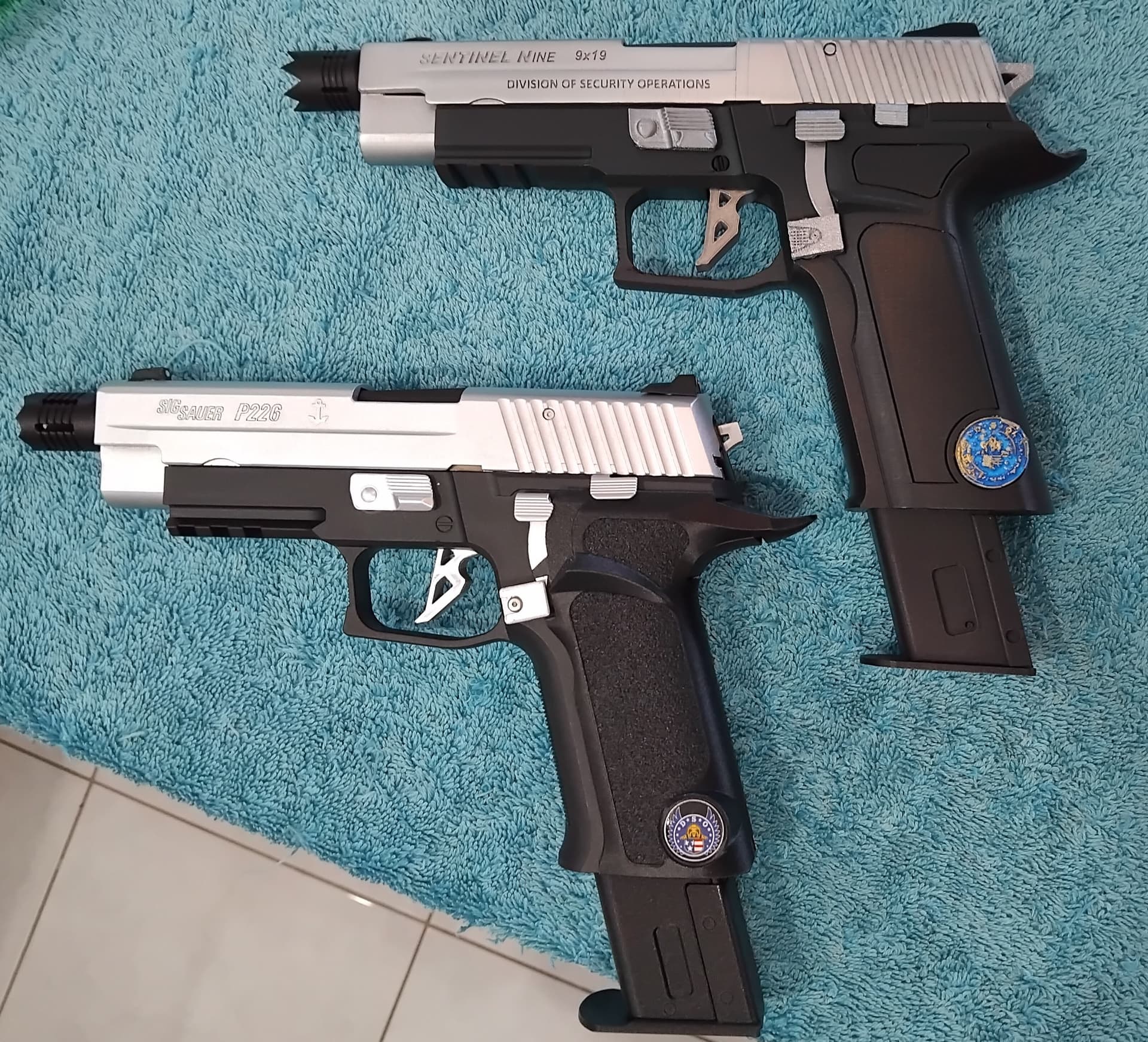

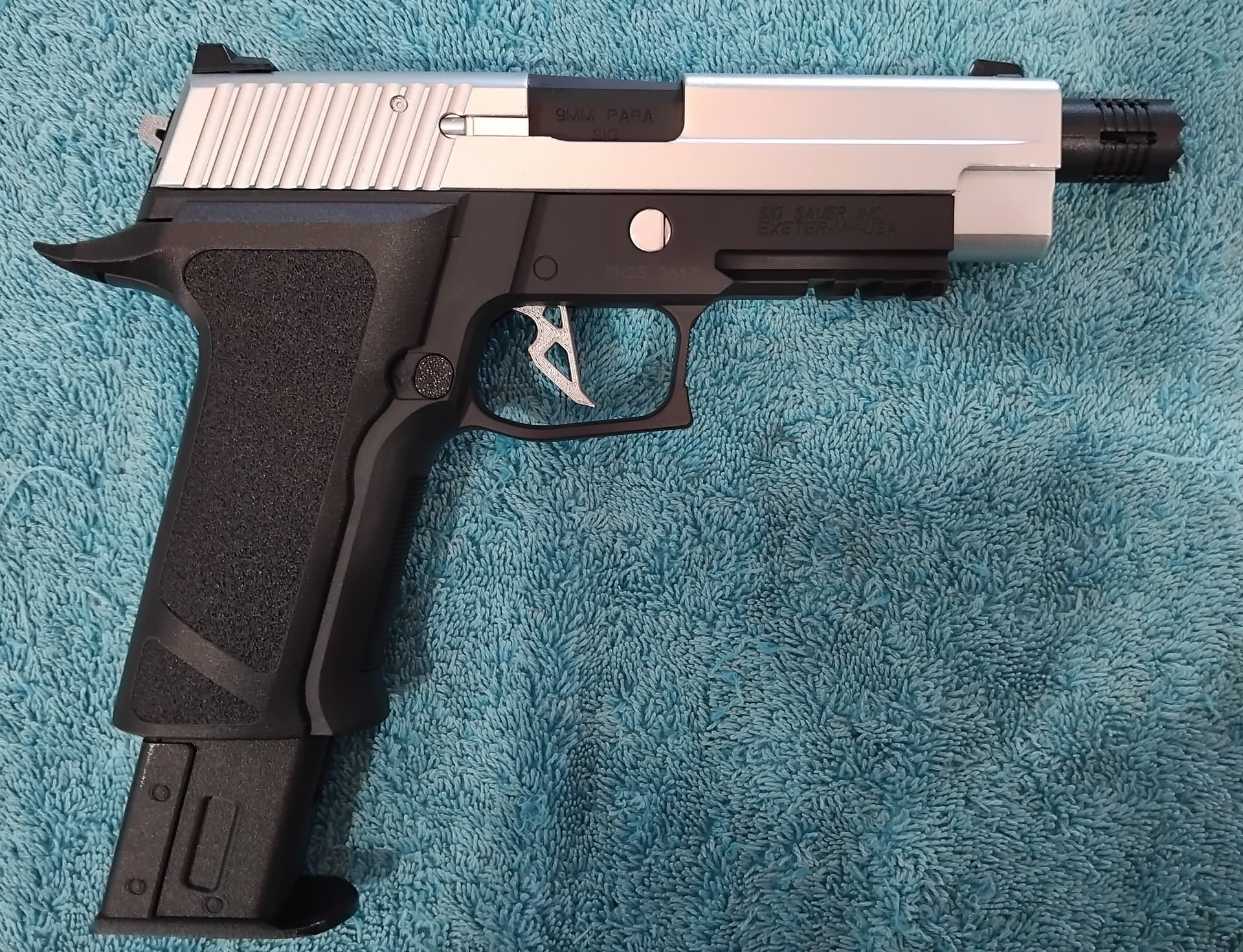

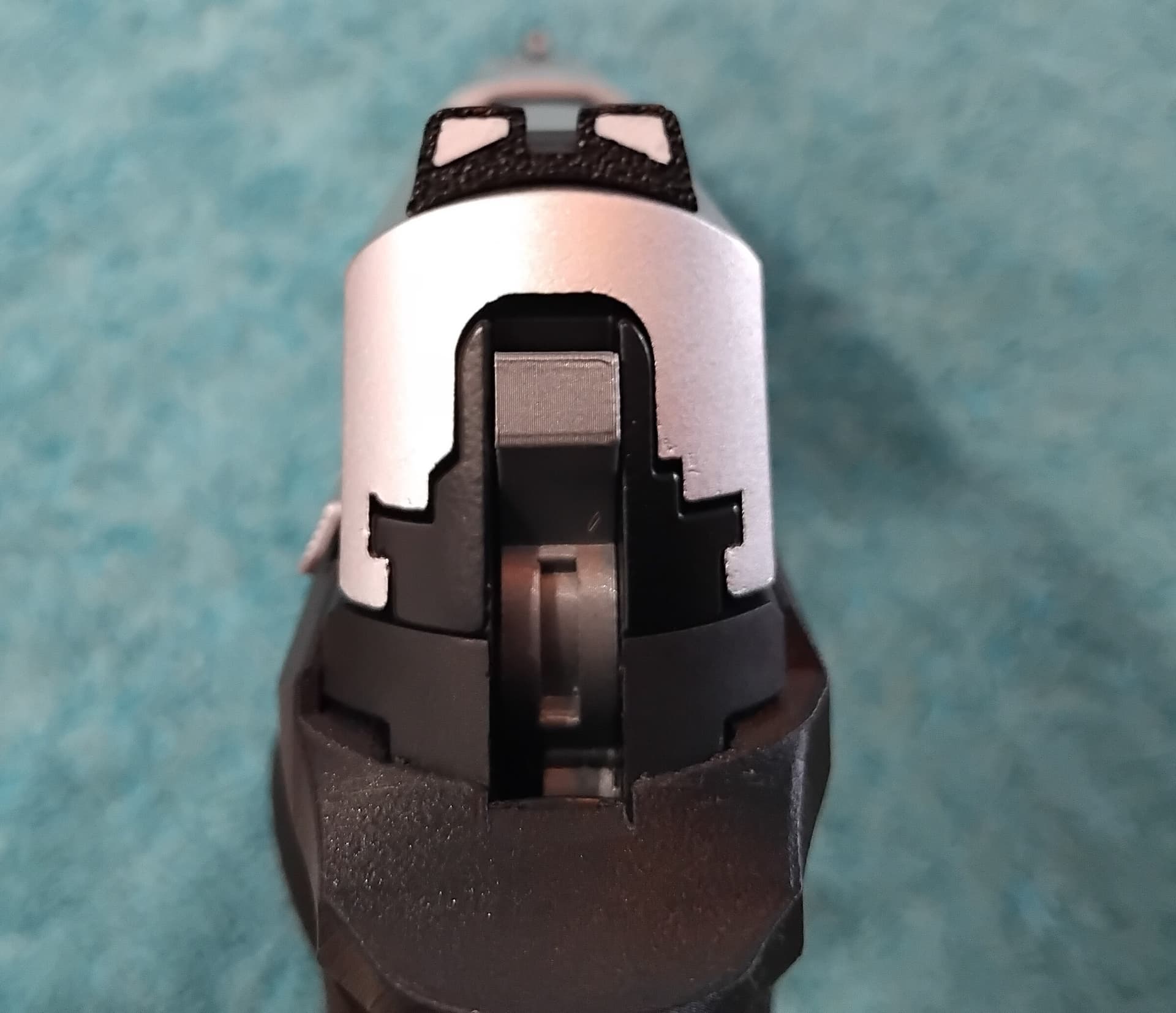

Paint log…
Tamiya Ts-83 metallic silver: Multiple coats, no primer.
Did slide, all switches etc except hammer.
Rear Sight: tamiya semi gloss black, bottled tamiya x2 gloss white, for sights.
semi gloss coat on top when dried.
Front sight: cover with green goop. brush touch up after painting…
Black: Tamiya XF1
Silver: Tamiya X-11
This kit is phenomenal value , with high quality 3d prints, fantastic looking, feeling and fitting grips, extended mag ( entire 3d print, with room for a battery), and trigger / hammer fitting flawlessly and functioning perfectly.
PTSD spring breakdown notwithstanding…!!!
But, now i know how to do it, so next time will be quicker…
Yes, i grabbed the last available Elec P226 for a spare…

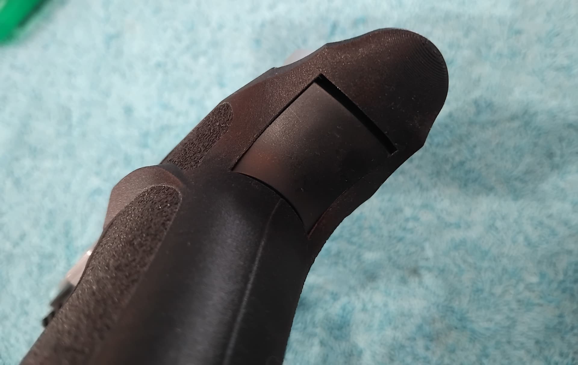

The laser will require some fettling to fit… but internal mods on the internal rail.
I dont know why it doesn’t fit.
It’s the only thing that doesn’t…
The grips are awesome…great fit and finish…very tight.
The only space showing is underneath, near the rear beavertail.
BME
October 18, 2026, 5:24am
761
The moderator is a very tight friction fit.
It doesn’t come off, under normal use.!
For around a $50 kit, this is an awesome bit of gear…!!
Whoever designed this, deserves to sell a gazillion kits…!!
Though, i think it was a passion project, for their own satisfaction…!!
Even the emblem is detailed and awesome…!!
3d print is okay…
But, there is nothing like having a proper , firing gel blaster version…!!
Non gas too, so no leaky headaches…!!

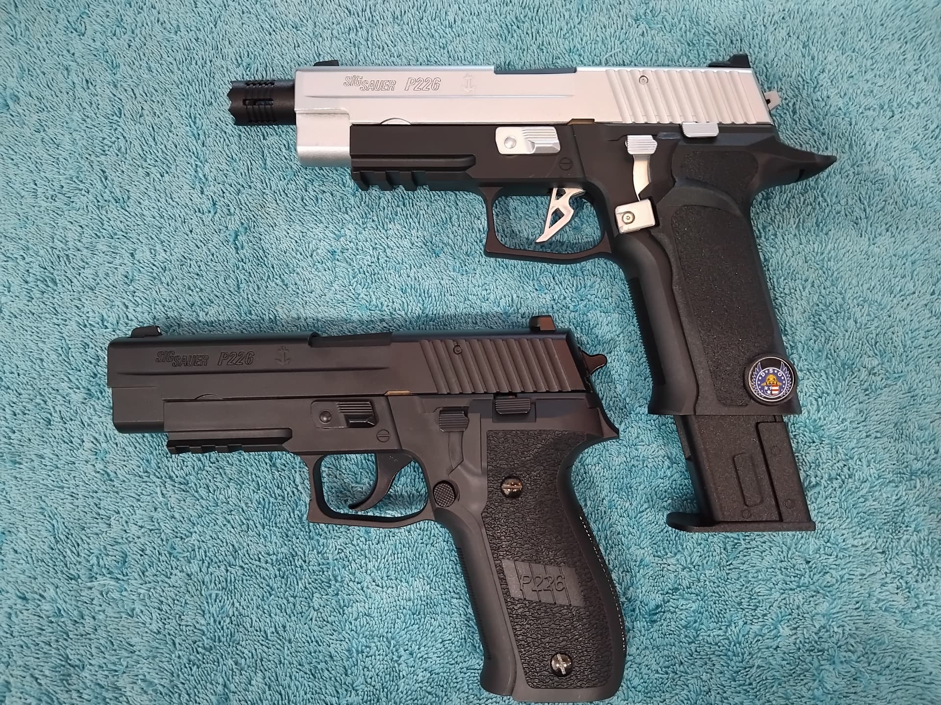

Comparo with the 3d print …
