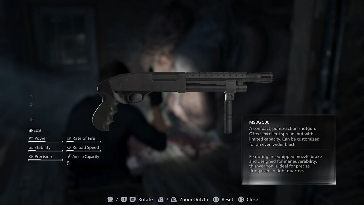

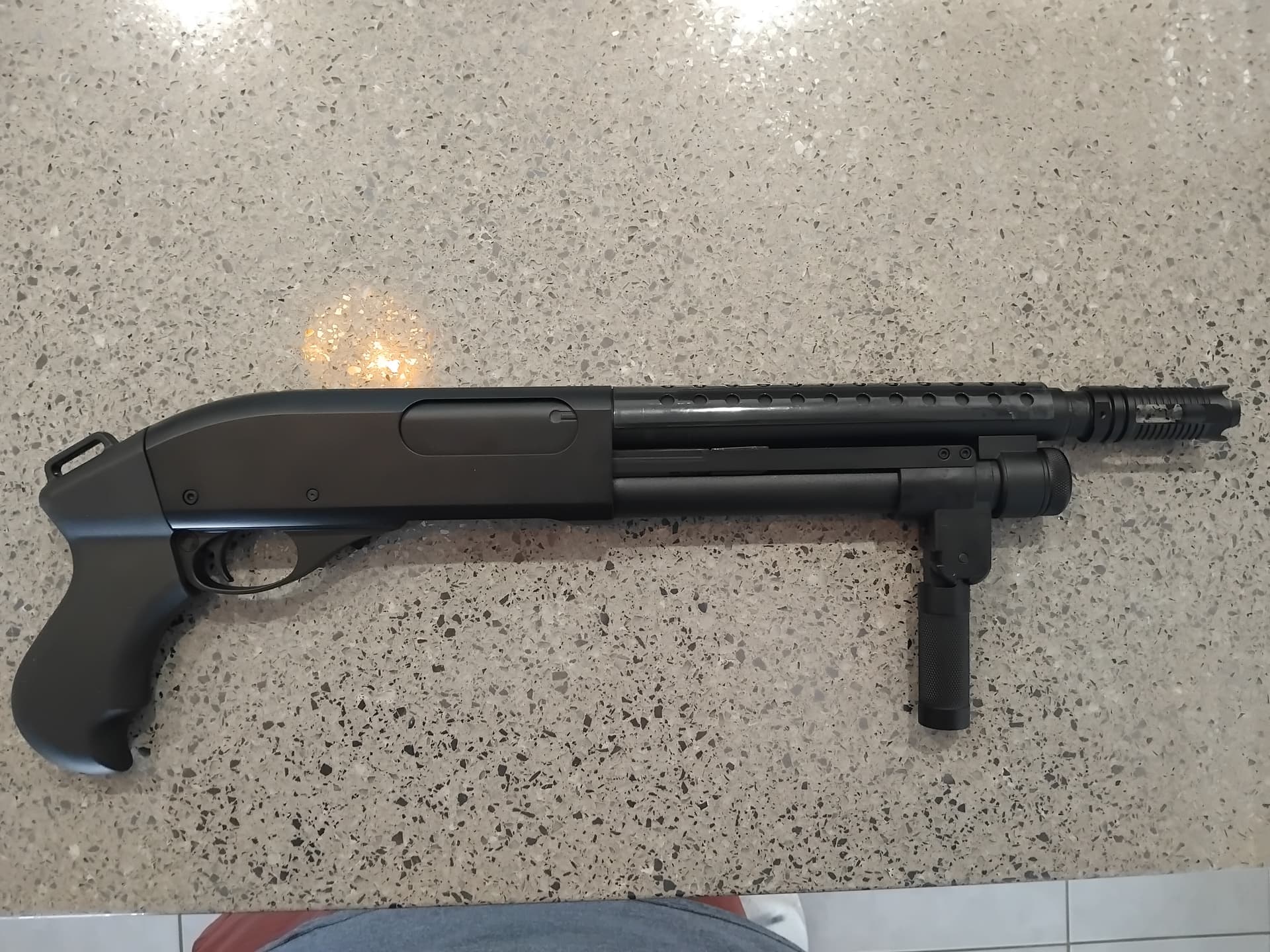

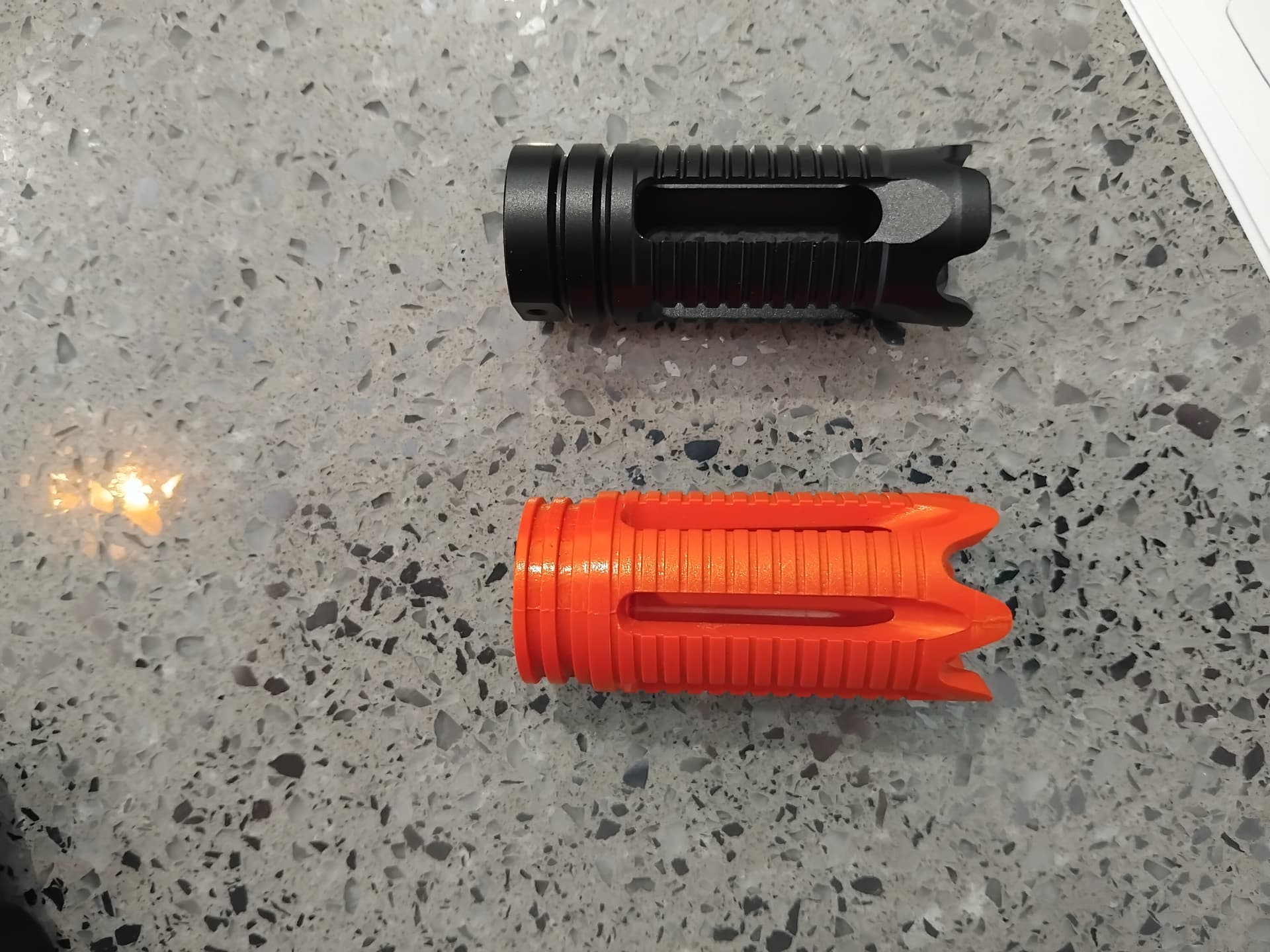

The in game suppresssor has a triangular, “meat tenderiser tip”…
Kinda like the bottom orange one.
Ive used the top one for now, and will get another “tenderiser tip”.
Dont wanna paint the orange one, it goes on something else.

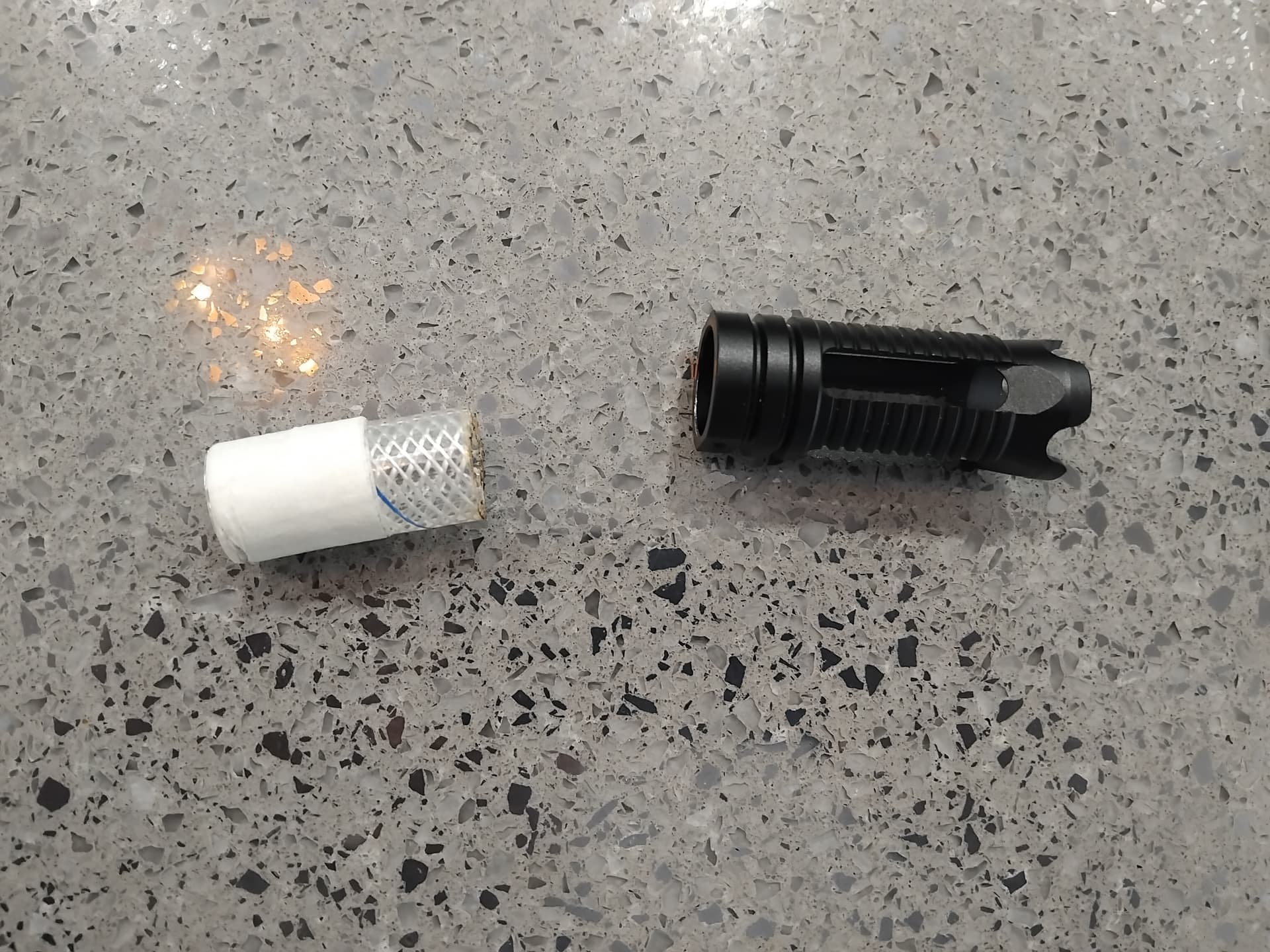

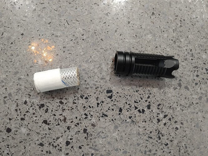

So, how to attach it to the barrel.?
Same diameter, and grubscrews on the hider…
Answer… fibre reinforced garden hose.
Its quite stiff, the flash hider snugly fits onto the exposed end.

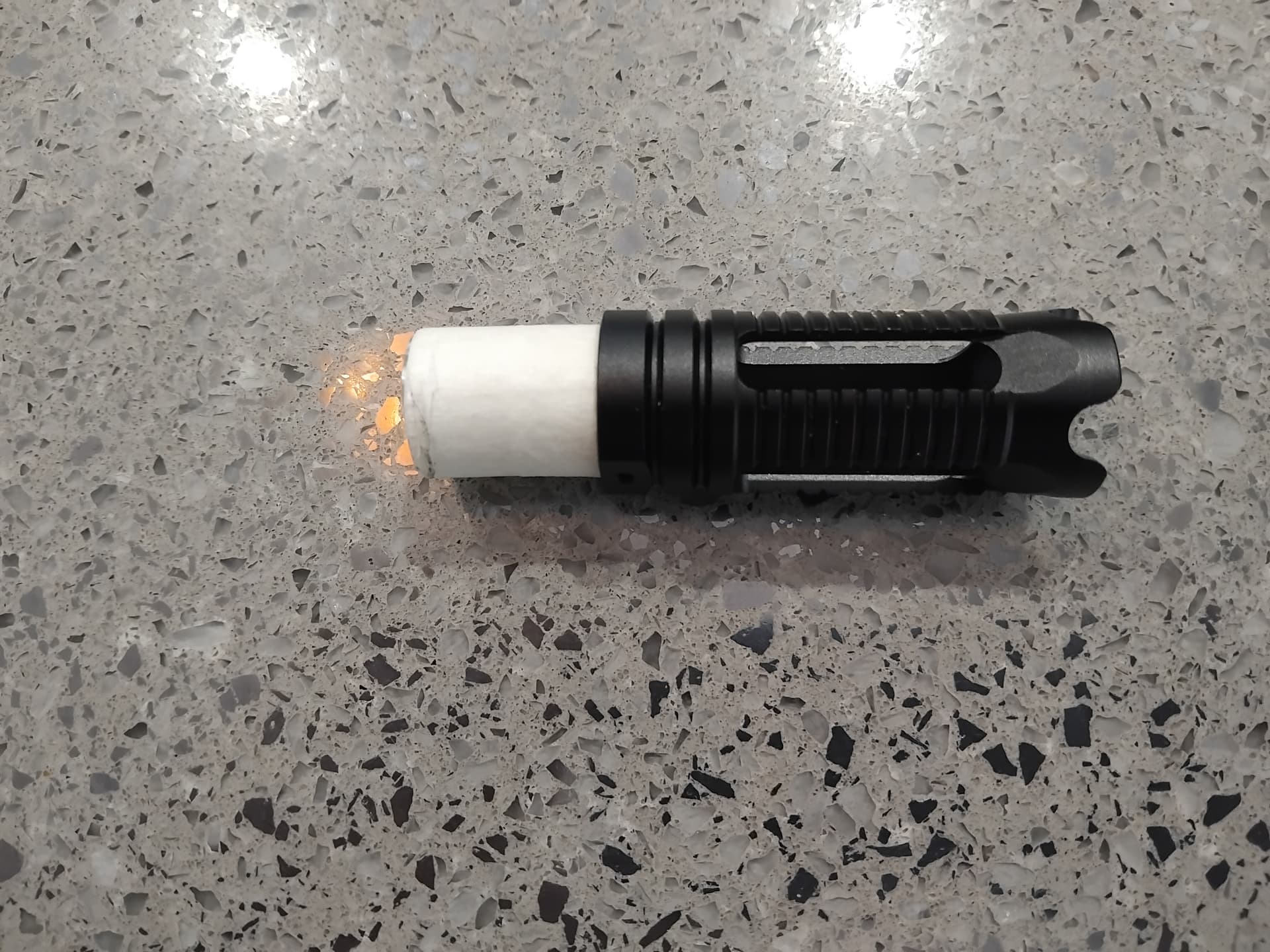

Build up the the other end with tape, and its a tight fit inside the outer barrel.

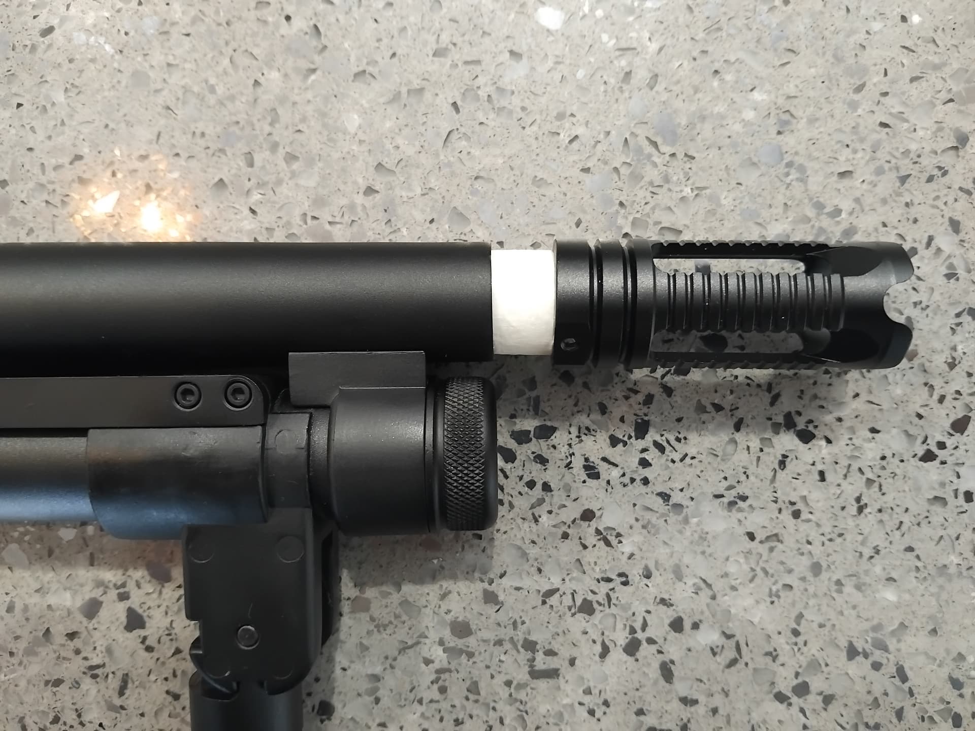

The snug fits inside the outer barrel…but a bit of tape ( at standard thickness) is protruding.
I think it’ll be fine when its painted…
Anyway, it painted up quite well.
Extra thickness of the paint, makes it a very snug friction fit.
No need to glue it in, and a clean easy removal.
The end of the barrel is a very " visually busy area’, so a bit of proruding tube is not really noticed.

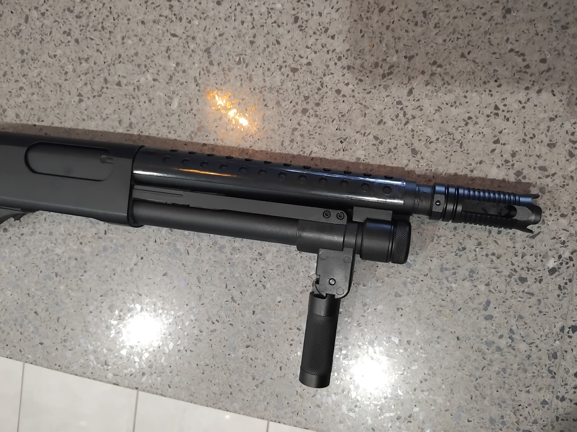

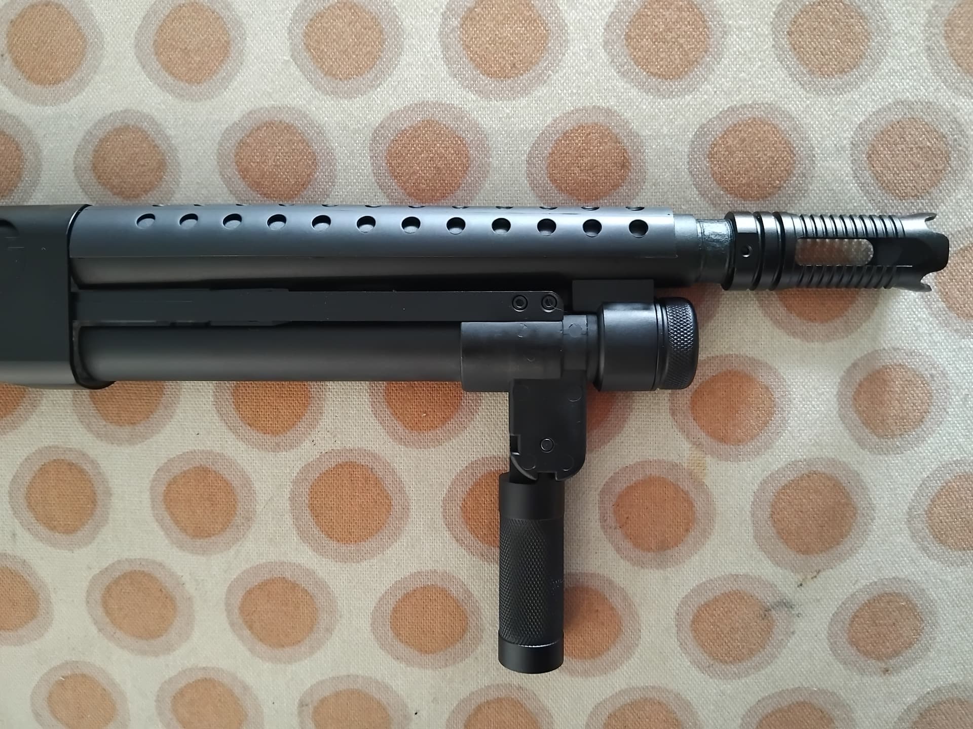

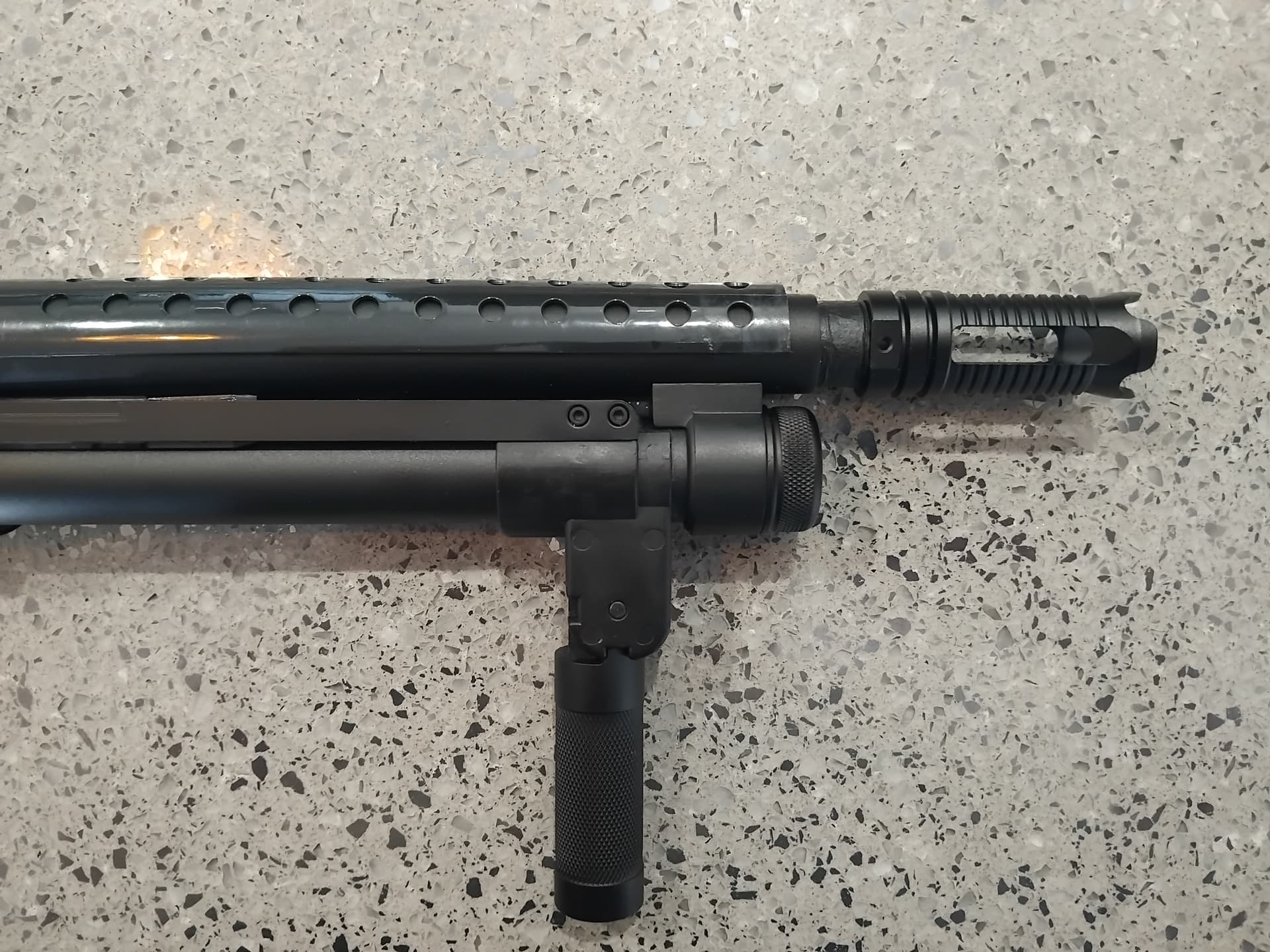

Finally, the barrel cover.
Pulled that off the top of a Hanke M97, and cut it to size.
Thats the shiny finish plastic, i will repaint with something a bit less shiny looking…
Anyway, quick little project, and im pretty happy with the friction fit.
Gels get through OK, on single fire.
I might try some matt black, with a bit of smoke top coat…
Then, off to the attic, to take out Chunk…!!

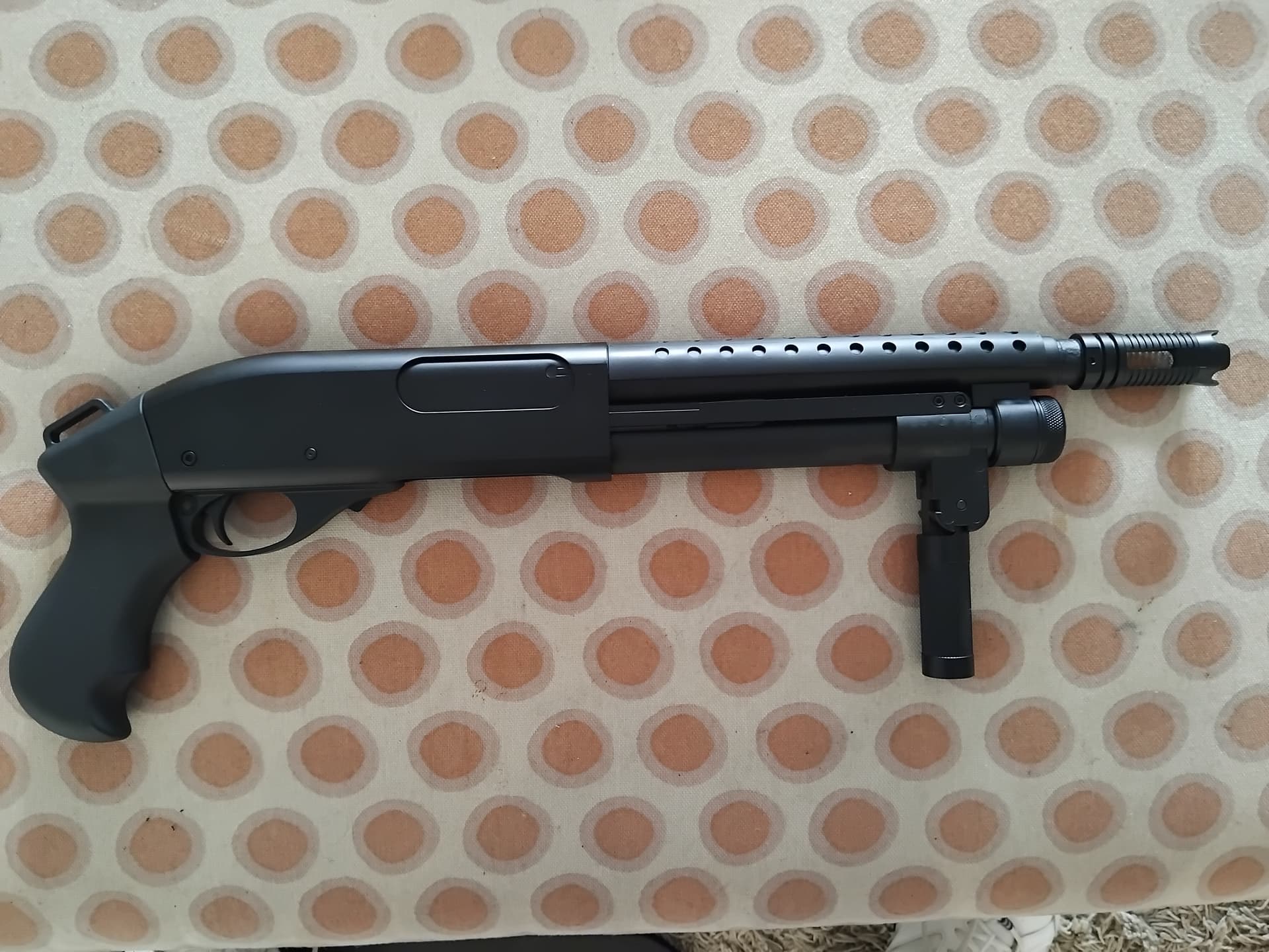

Those two little additions, do dress it up, and make it look more visually interesting…

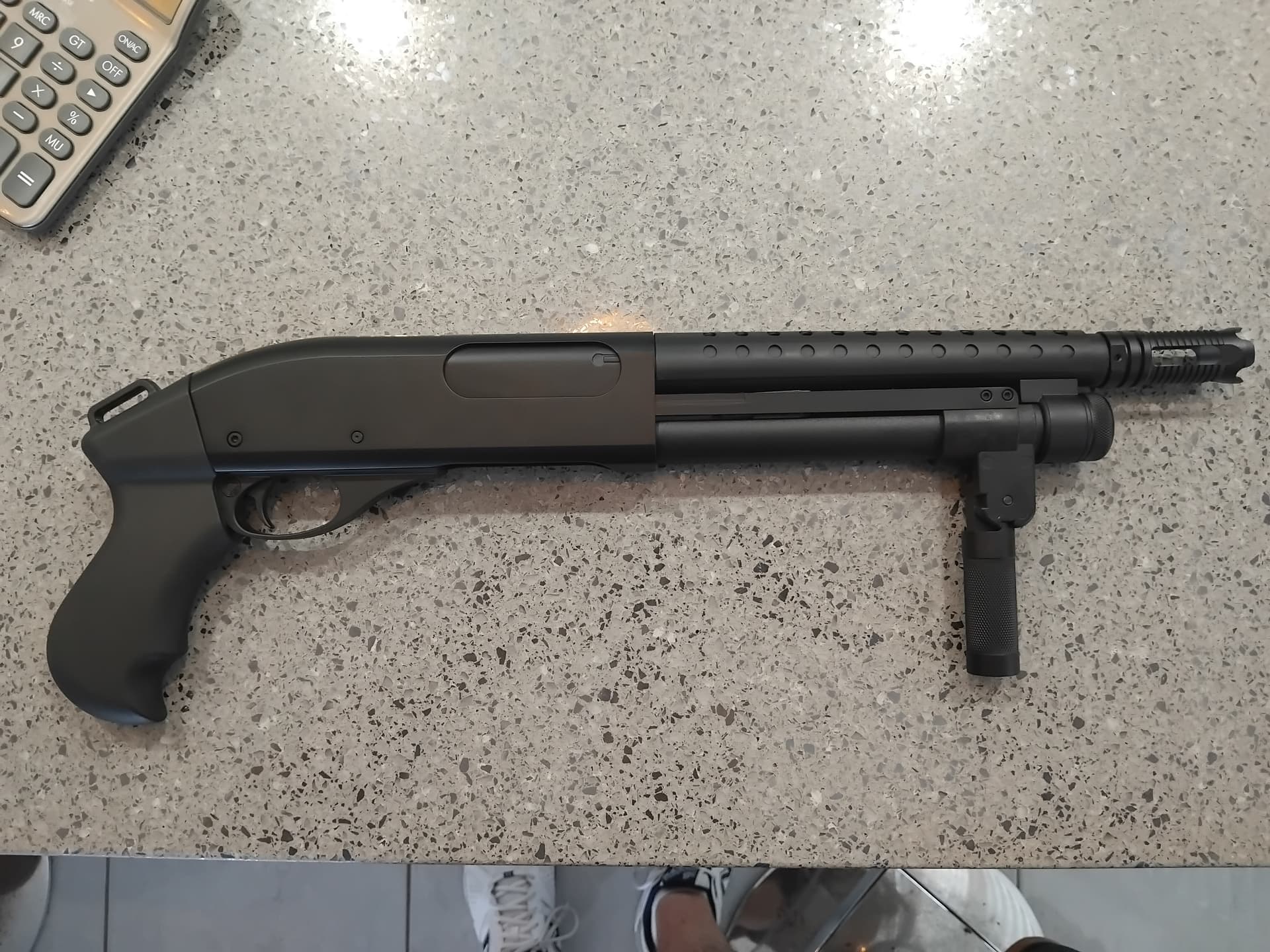

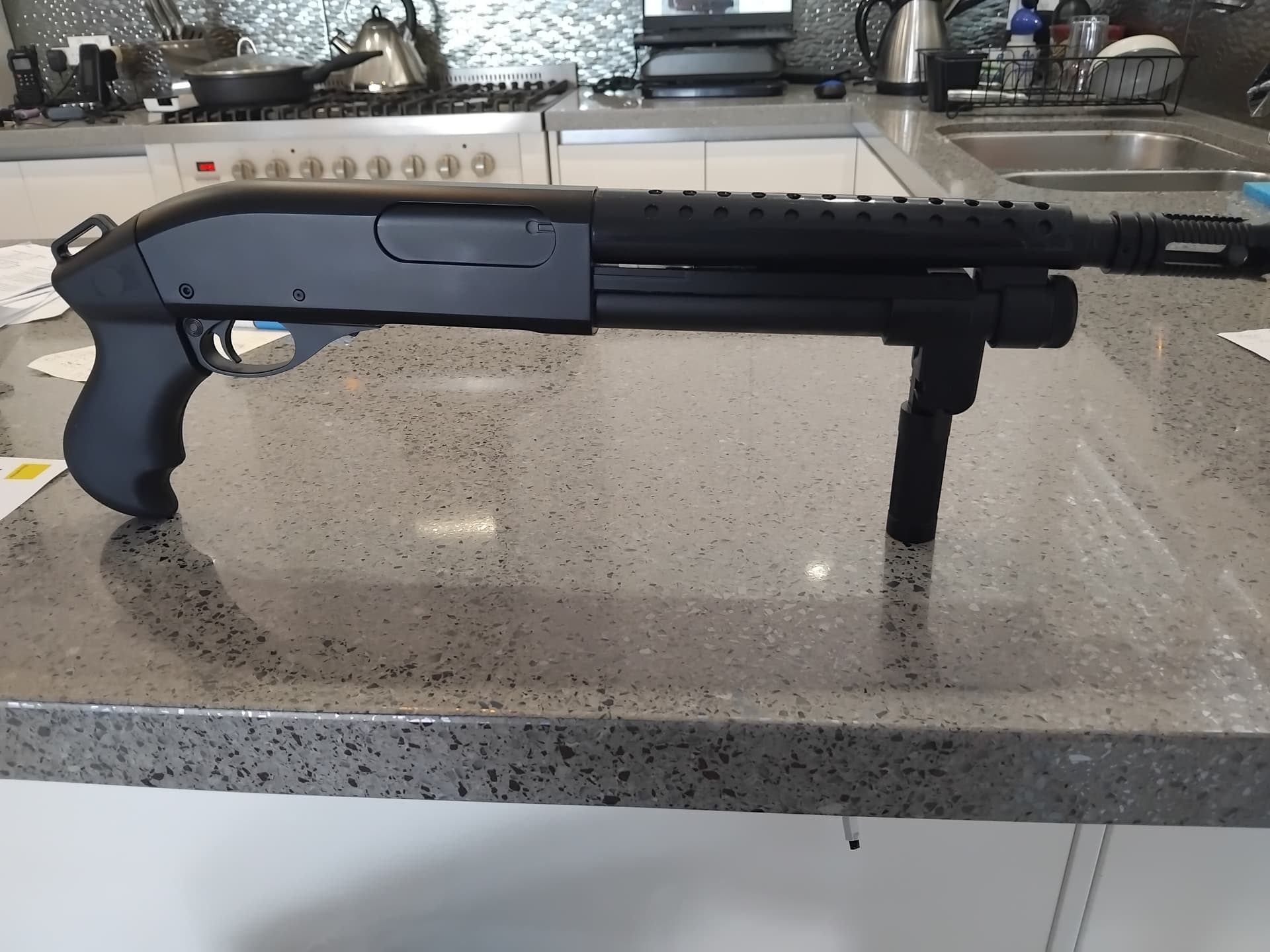

A couple of shots, on the pouffe…better contrast.

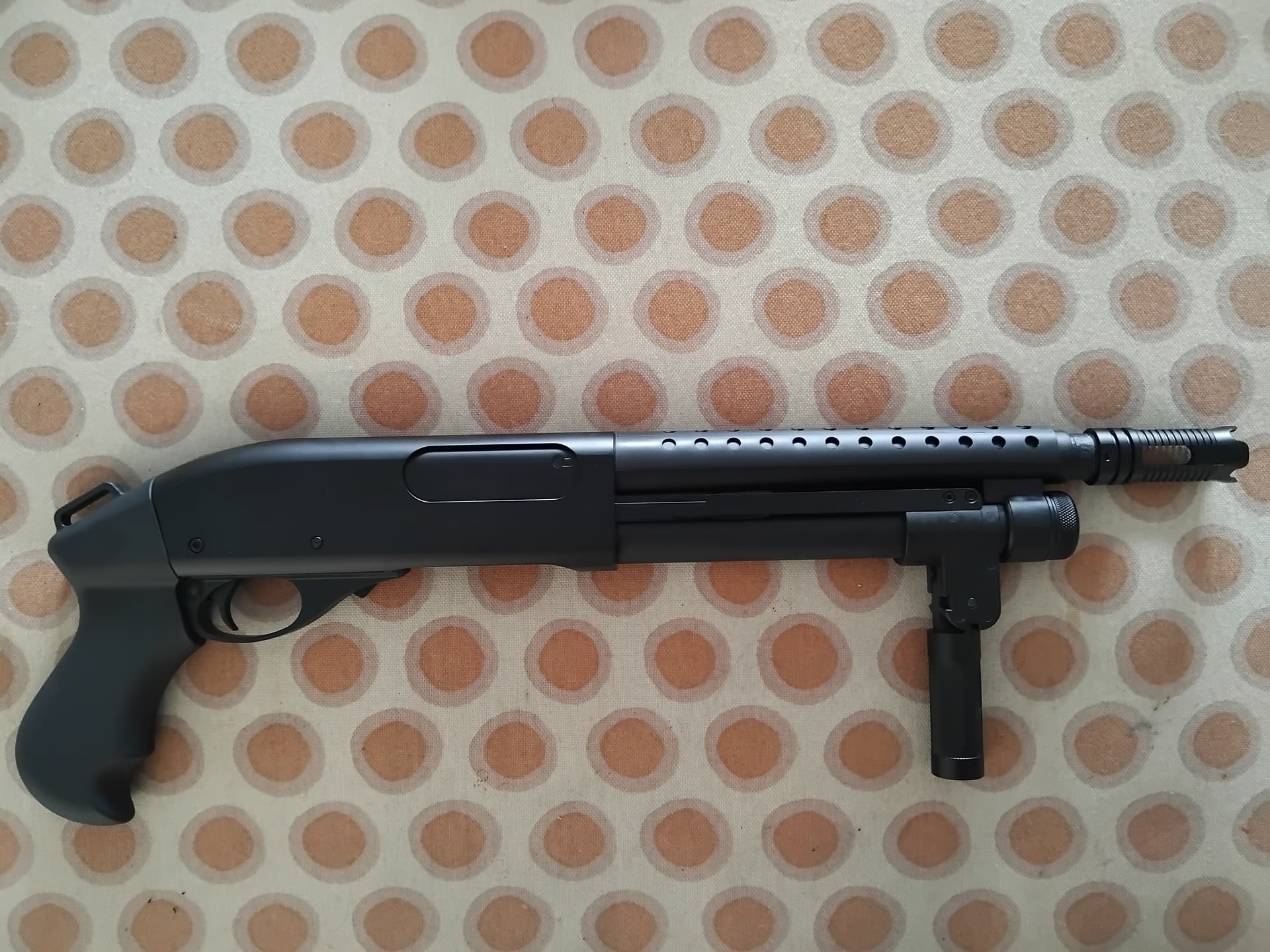

Barrel shroud has been painted with Tamiya semi gloss black.
Looks OK… i might dry dymark matte, for a flatter finish.
Simulate that “baked look” from barrel heat.
All in all, its pretty good.
just needs a dab of hot glue gun, when its all dry and done, to hold the shroud on…
And get the tenderiser tip on…
Got the hacksaw out , and trimmed down the protruding visible hose.
Man, that stuff is tuff…!! Fibre reinforced…!!
Its sitting flush now, and looks better.
Proper all around contact , barrel end to flash hider, ensures proper alignment as well…
Bonus ankle shot, as well…!!
