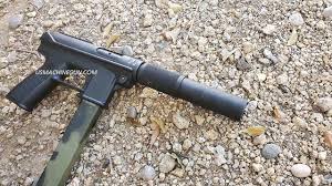

They do make suppressors for Tec-9’s
Untitled
Untitled
500px-TEC-9_with_screw-on_suppressor
That last one looks distinctly like Escape From New York…!!
Chuck a scope on top, and off you go…!!

Mount the scope on the suppressor, and have it hanging forward, to where the supp steps down…
Tec-9 already has top barrel aligned holes, for scope base retention…
Tap the protruding plastic barrel, for screw on supp retention…
I’d better stop now…
What are you talking about, you’re just getting started :joy:
I think the tactical tec-9 would suffice for barrel length as it is, but if you wanted I suppose you could go one better at sportsco and throw a suppressor on for shits and giggles :joy:
