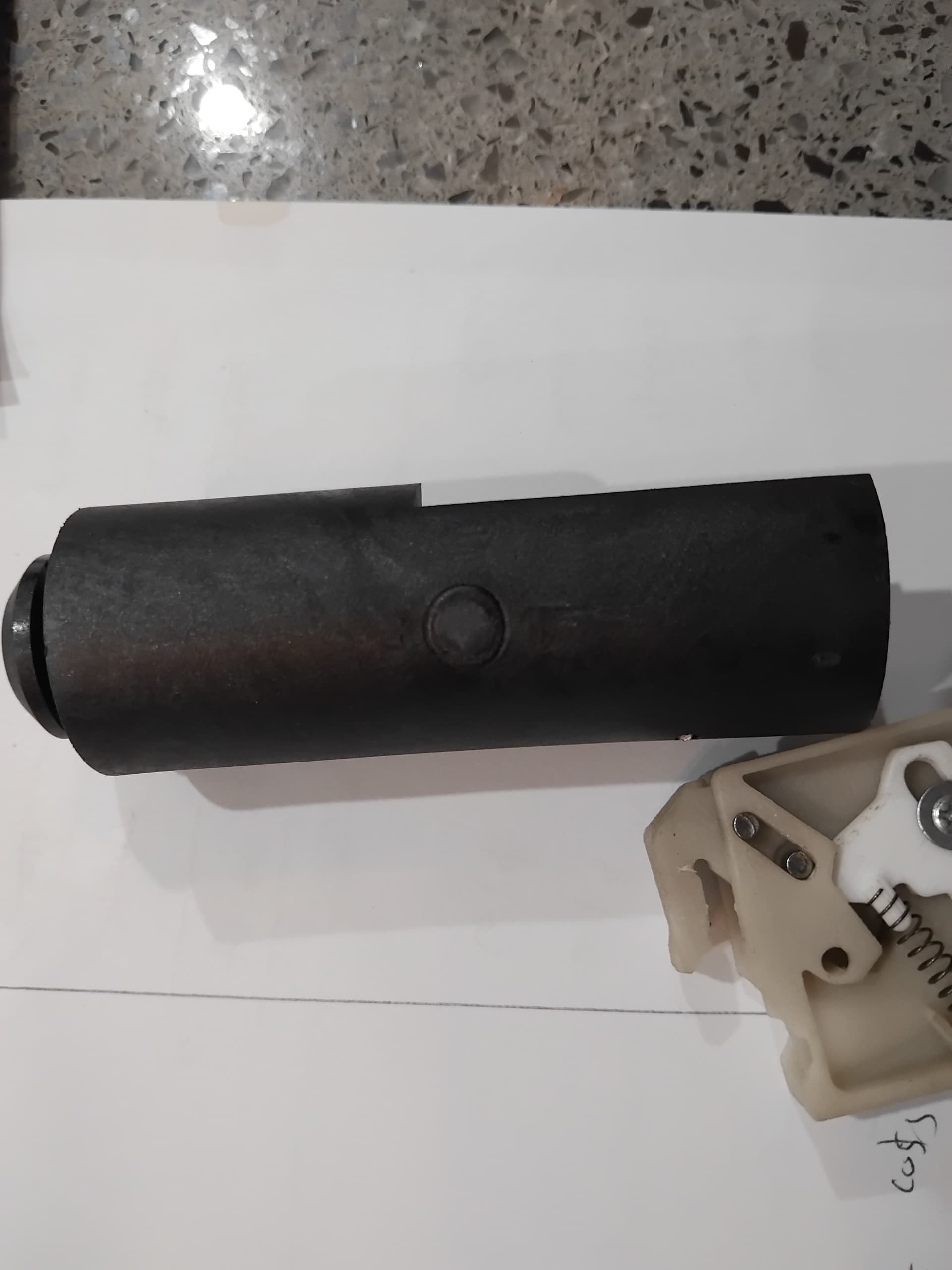

Also, got the replacement charging handle, for the TEC-9.
The sten one screws in, this one doesn’t budge.
Looking closely, its not threaded.
I suspect it just drops into a hole, and is probably glued in.
I had to grind some material off the old handle, to get the bolt out of the barrel. Ive had no joy getting the old stump out.
I reckon it’ll be like pulling teeth…anyone know a dentist.?.? :rofl: :rofl:
Stump shot.
New handle, overlaying bolt.
Any good idead for getting the old one out.??
If it is glued in, soaking in hot water would help.
I suppose the old “screw a screw in, and pull it out” might work…any other ideas.?
I dont wanna drill it all out, and create a gaping crater…

Got it out.
Tight as, but drilled in a picture hook screw, 10 mins soaking in hot water, manipulation with pliers, and its out… virgin socket left behind.

No.just a very, very tight friction fit.
To reassemble, you can’t have the charging handle on.
You need to feed the back bolt down the barrel, and the handle needs to be off.
Then, get the bolt to the fully retracted position.
The wider circle allows a hole big enough for the larger circle at the base oft the handle to pass through.
It then needs to be heated, and several technical taps with a hammer, to get it in.
I reckon the factory guy hit it off centre, broke it , and just kept it moving down the line…
