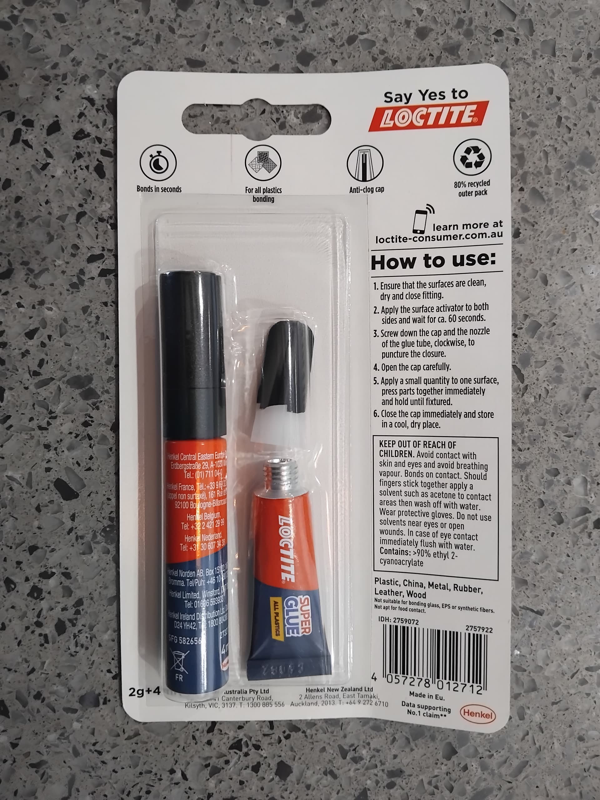

I got from bunnings, some Loctite Plastic Super Glue.
Having never used this stuff before, i was surprised at
-how easy it is , to apply… and
  • how strong it is.
Its got a paint pen and some glue, use the paint pen to apply primer, then apply glue to one surface, and seal.
Sets very quickly…and Super strong.
After 5 minutes, on the scrap block…it resisted quite a bit of strength to pull it apart.
Very handy for small , fiddly fixes…try it yourself…$7.00
