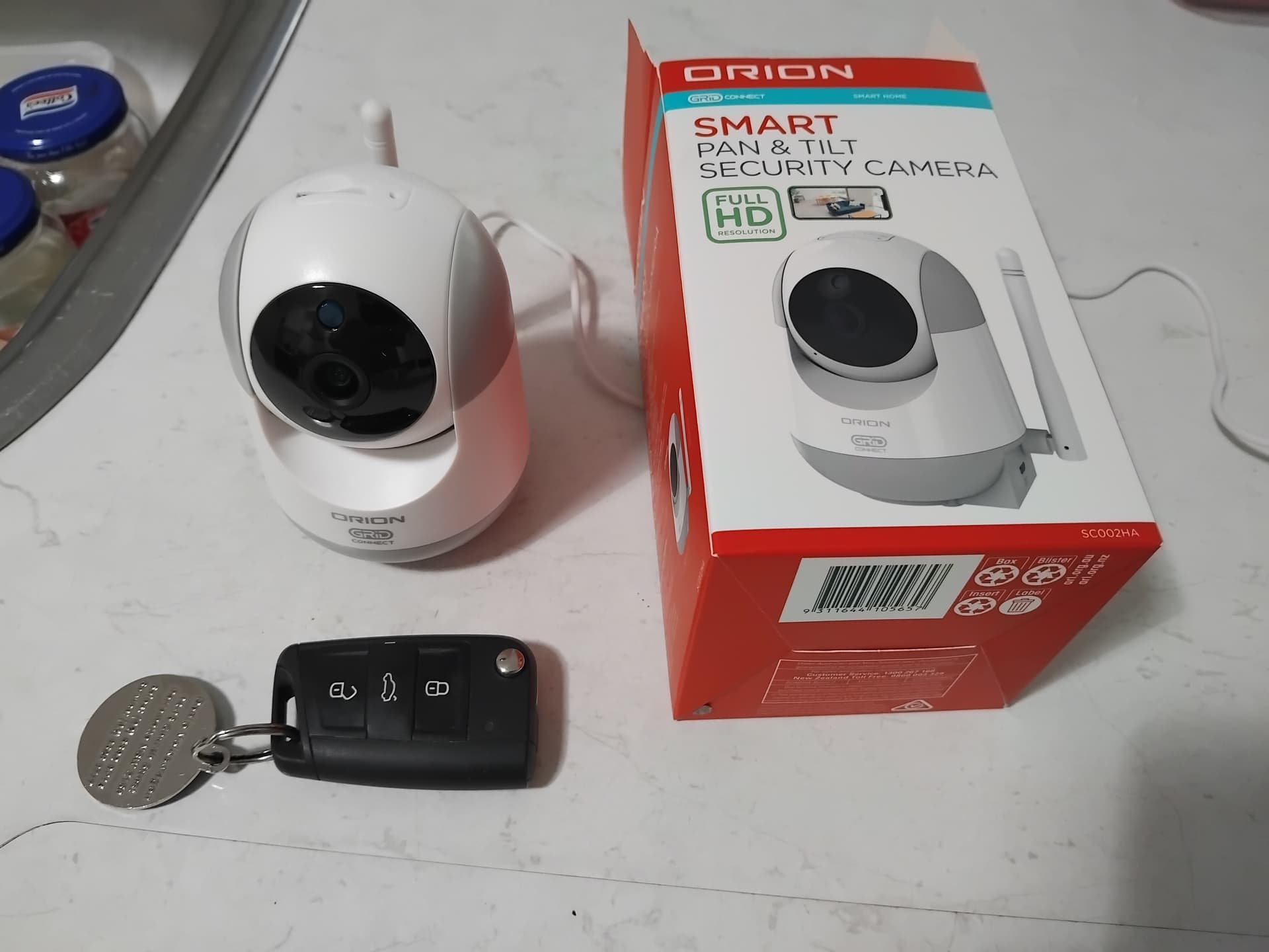

I ended up trialing one of bunnings $50 cheapies… Orion.
Mains powered, easy to connect/ setup and use. Got 3 more.
Now, her house is covered. I can see all the critical floor areas.

A) Bunnings $50 offering is the Orion Pan and Tilt Security Camera.
Full HD Camera.
You download and connect through the free Grid connect App.
Easy to use, and add additional cameras. Insert SD card for local recording.
Phone live feed.
B) The Orion cameras are chinese made. Are there possible security issues…yes. Are they going to be an issue for Mums setup…No.
The cameras are fairly unobtrusive, and can pan and scan, to follow movement. Resting position adjustment via menu, with up / down /L /R commands.
It has night vision, and an audio pickup. Inbuilt speaker to, so you can speak through it. Onboard speaker is about average quality, about cheap walkie talky quality.
Security is dependent of the level of security of your modem router.
It is encrypted with router encryption ( WPA2 or WPA3) after leaving your modem to travel downstream. Basic but affordable.
C) Well, what a interesting little journey this has been.
From idea to setup in about 36hrs.!
Being chinese, Orion is designed to be able to communicate with the parent server in China. This is under the guise of easy firmware updates etc, but the Aust govt pulled chinese cams out of govt buildings, with good reason. Also, the Orion camera feed does not have encryption , on leaving the camera.
By contrast, D-link is made in Taiwan, doesn’t communicate directly with the parent server, and has the newer WPA3 encryption standard, leaving the camera.
So, Orion is leaving the camera unencrypted, until it hits your router.

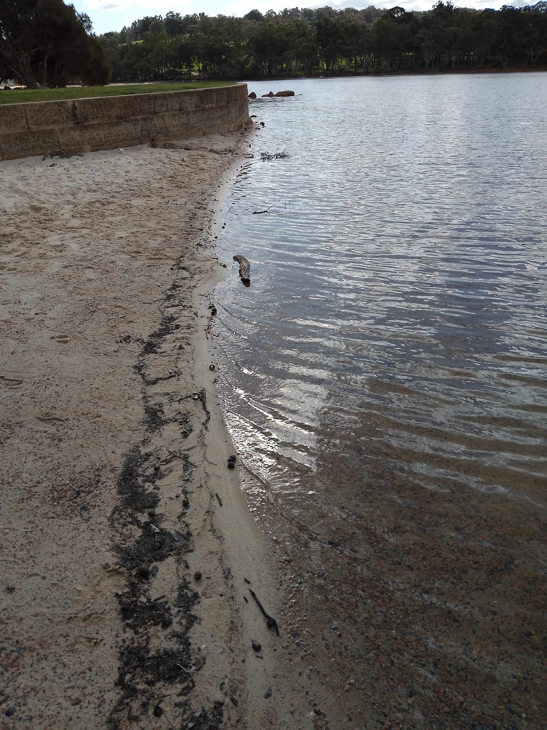

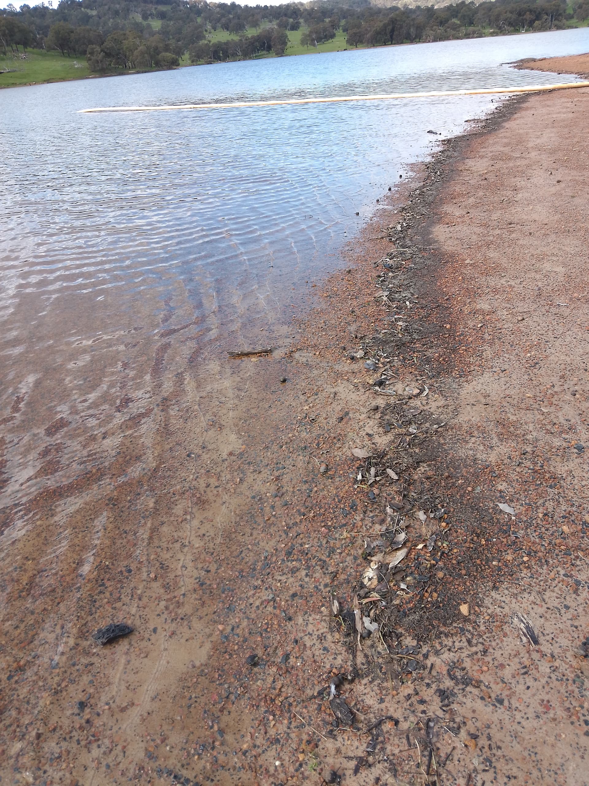

A bit of a weird day, with scattered clouds and a cold wind interrupting the beautiful WA sunshine, so am up at the Weir just chilling in the Sun without any Aircraft/Rock Crawlers or Speedboats for a change. :sunglasses:

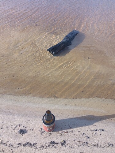

Just had to share a couple of happy snaps regarding the Debris that has washed into the waters that has been causing a fair bit of damage to the Float Planes and Speedboats recently.
That’s just a couple of quick pics of the 30 metres of shoreline right in front of me, giving some idea of the amount of crap floating around out in the open waters!
Imagine hitting this chunk of driftwood in an 80cm boat at 100 kph, or a float on a Plane smashing into this on takeoffs and landings!
(Bush Chook for scale!)
The Weir has a catchment area covering 5900 Hectares, and a total water surface area of 417 Hectares… so that’s a LOT of Area to fly Aircraft and run the Speedboats…
BUT also a massive area to hopefully dodge unseen floating debris shit with the Toys, which unfortunately has been near on impossible in the last couple of weeks of heavy rains, causing quite some damage in the process. :face_with_diagonal_mouth:
