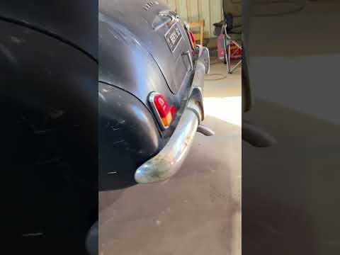

FX Holden, customer gave me a Twin Stromberg Inlet Manifold to put on his 138 Grey Motor, but nothing else!
Went through a whole IBC Container full of old Carbies, several bulk drawers worth of thousands of different jets, power valves, emulsion tubes, different sized carby main bodies and throttle bodies.
Somehow managed to find a pair of ultra rare 1 & 3/32” main bodies and BXOV-1 throttle bases, plus all of the right sized internal metering parts and even a pair of twin carb bore restrictor inserts!
Took a whole day to get all of the correct components together, used several different cleaning methods/chemicals to restore them back to usable condition, and then another few hours to completely build two complete carbies from scratch.
It took another whole day to fit the manifold, linkages, fuel/vacuum lines…… and another 5 hours to completely modify all of the accelerator components to get everything to work properly to the new geometry, plus fit a whole new set of extractors, muffler and 2” exhaust system, hangers and straps.
Both front drums removed, long wheel studs and spacers were installed to be able to run the fat front rims/tyres without fouling on the suspension/steering,
Engine/Gearbox spacers were made/installed to clear the incorrect sump that the customer is having issues with, only temporary until we can source/fit the correct parts.
Various electrical issues were rectified along with a long list of small niggling problems.
Don’t forget that this vehicle is 71 years old right now and has never been touched other than the rattle can black “paint job” over the untouched original paint.
EVERYTHING on this vehicle is original, nothing has been repaired/replaced/restored/modified in the 71 years since it was first built! ![]()
Bugger me dead……. those old piles of scrap that I gathered, cleaned and built to resemble a couple of Stromberg Carburettors fired up into life as soon as the fuel hit their bowls.
I said to the owner that I could only set a few screw adjustments close enough to what my experience tells me where to roughly place them, so don’t expect a miracle from the the very first start up of the engine……. but no word of a lie…… he hit the key, dead cold, no choke, no throttle…… and this beauty fired up and idled like it was only shut off and parked up that afternoon! ![]()
Yeah it’s rattling because it’s dead cold.
Warmed it up and then ran through all of the rocker settings to get it purring like a kitten ![]()
