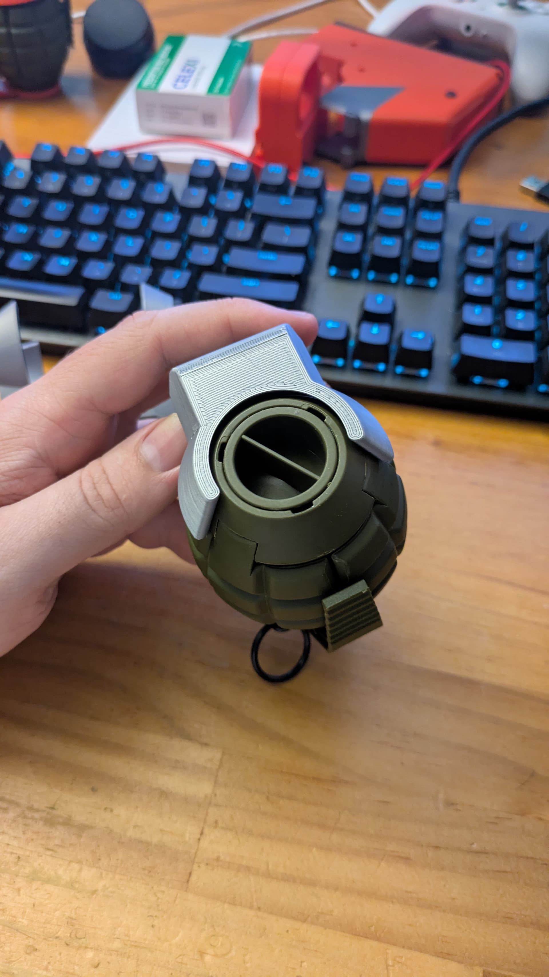

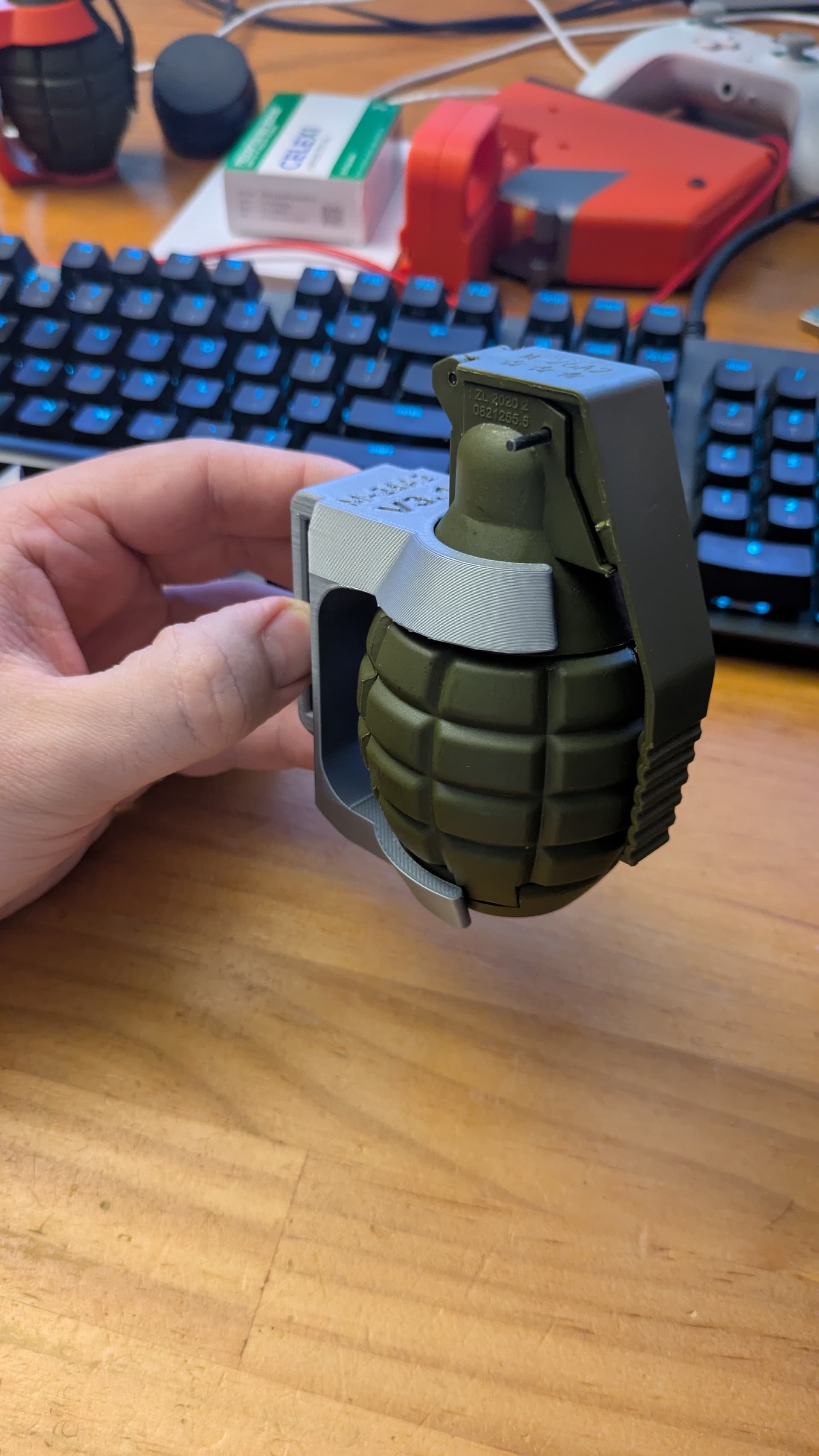

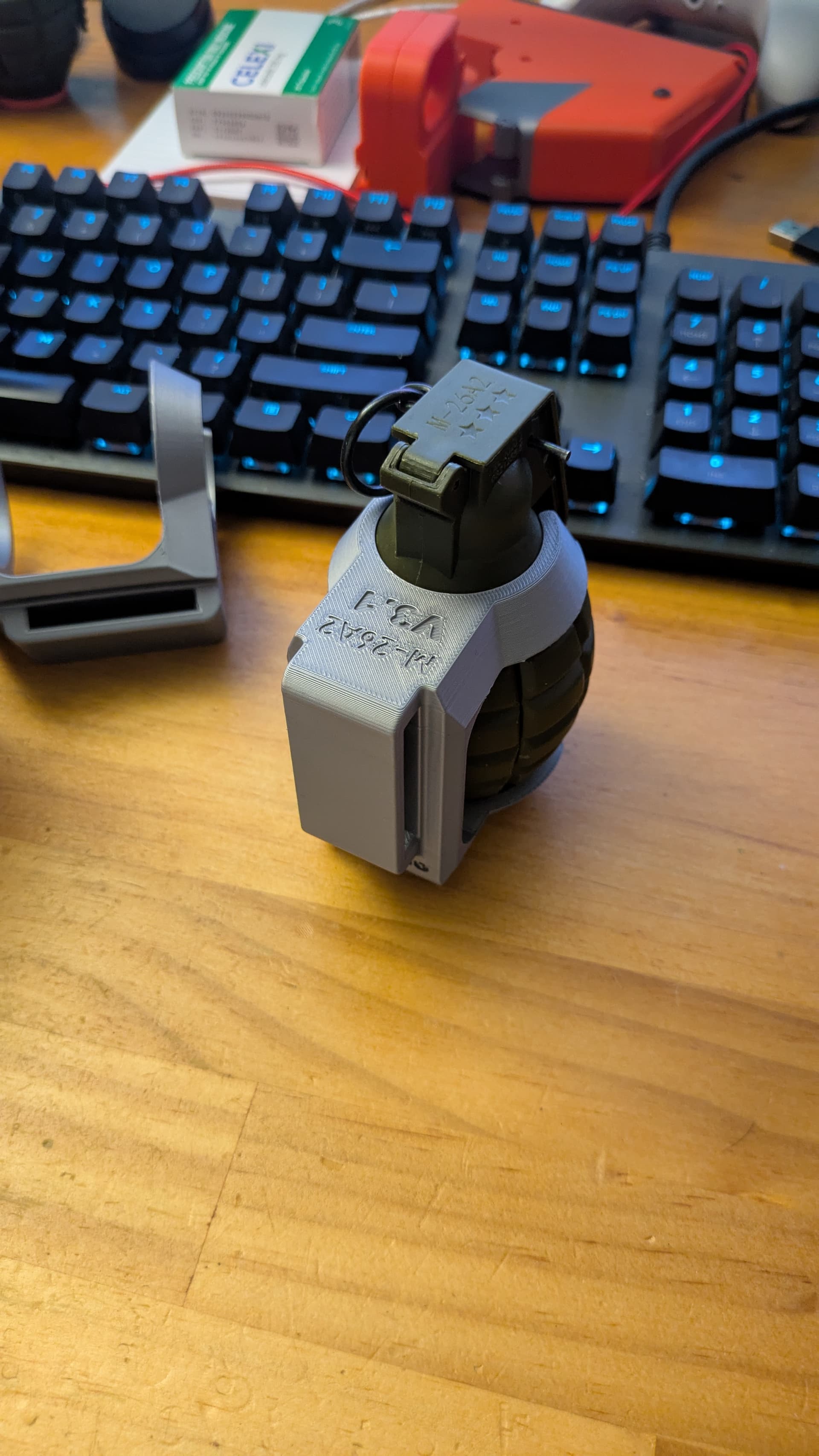

Still got a couple mm of adjustments to make then V3 will be ready for field testing.
Looks great :+1: I like the redesign of the bottom plate
Got a better fit with v3.2
Even thou the gap between the top and bottom clamps is bigger than the part it holds it still looks like it’s being pushed apart :thinking:.
Looking good, but I see what you mean.
Are you having another crack or should we field test? :slightly_smiling_face:
As it is, it holds tight and isn’t impeded being released, I did widen the belt loop a bit and now it’s a bit looser so looks prone to sliding on its own, But otherwise I think it’d be good to go.

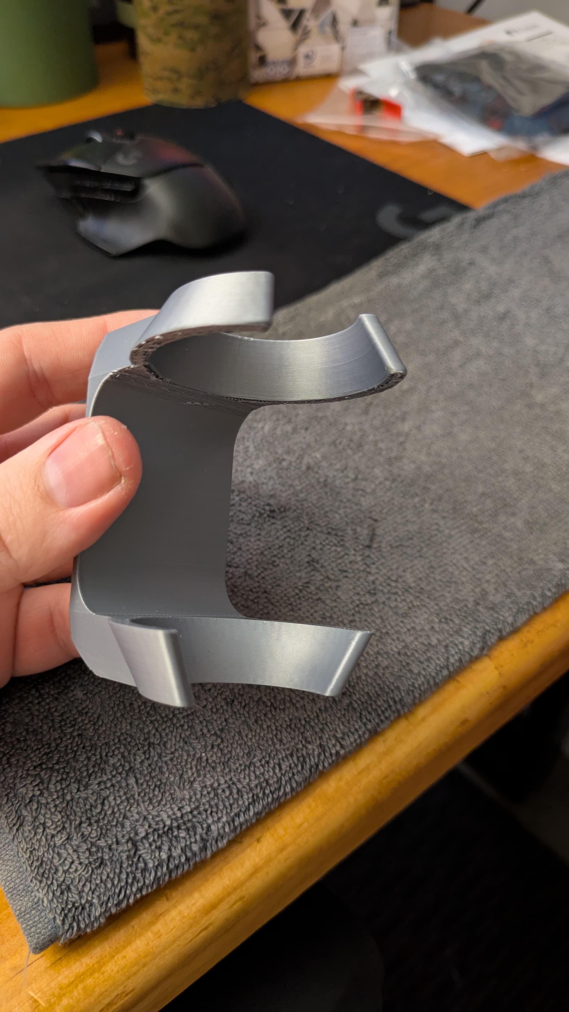

That’d just be because of the tapered and curved shape of the top and bottom of the 'nade, makes the clamping arms flex apart by putting pressure on them towards the small end of the taper at each end, yeah? The tighter the clamping force, the greater the deflection towards the smaller end? :person_shrugging:
Not much you can do about that, hard to fight physics… unless you print it with that taper compensated for in the cross section of the arms.
Roger that :+1:
Usual deal then, 11pm in the alley behind the 7-11 with unmarked bills in a brown paper bag?
Well the clamps are shaped to match the angle of the shoulders of the nade so it holds more securely.
The distance between the top and bottom shoulders of the nade was like 45.5mm (from memory) and I’ve modeled it so the matching gap was 46.5mm so theoretically it should be loose…but it’s not… Or at least not in the way I thought it should be.
My thinking it should be right. Bit of pressure there to hold it secure enough, then rip it and deploy when needed by the looks :+1:

Yeah, agreed @Maiphut … looking at that pic of the angled clamps you’d think they’d stay parallel under load. :person_shrugging:
It’s a great bit of CAD design you’ve done there @DChapo… while it’s an interesting talking point as to why the spread of the clamps changes, in reality, it doesn’t detract from an A-Class bit of kit you’ve punched out. :+1:
